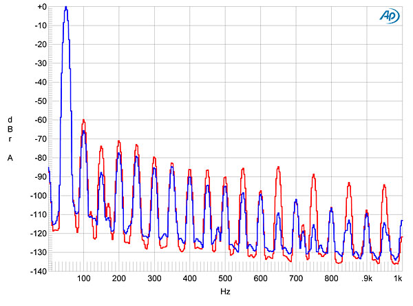

darTZeel NHB-458 monoblock amplifier Measurements | Stereophile.com
darTZeel NHB-108 Model One power amplifier Measurements | Stereophile.com

Before I could reach over and tug the AC cord loose, there was a loud bang from the left-channel output devices and my test lab filled with blue smoke.
Due to the nature of a voltage bias in the majority of modern class AB amps, dynamic distortions near the zero crossing are all over the map, and their spectrum is modulated by envelope. 😀
Do you have any measurements and quantifications of this phenomenon, performed on a well designed SOTA class AB amplifier? This must be easy to measure. If you only verbally declare your thoughts on solid state class AB flaws, the same way you may declare anything.
