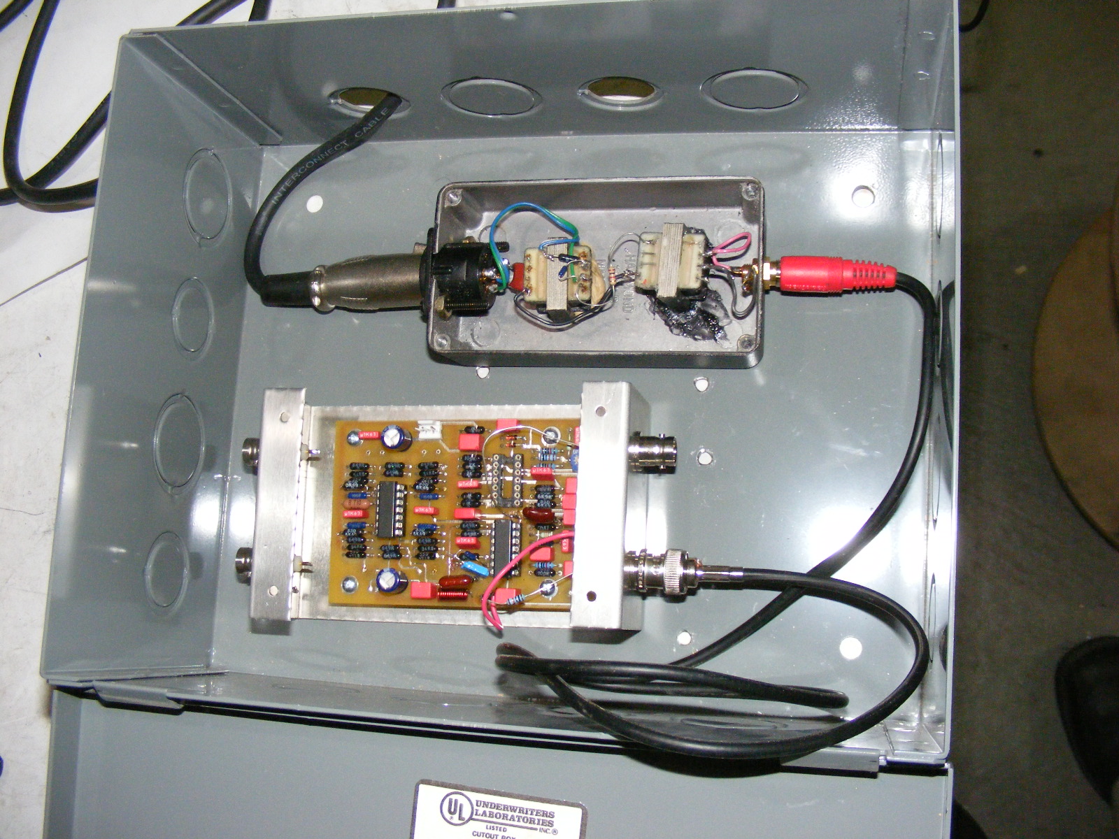

This is my test setup for resistor very low level signals. There is a resistor divider feeding a step down transformer. The thinking is that a transformer will have different low level behavior than a straight resistor so as not to taint the results.
The preamp transformer combo have a gain around 30,000. I had to measure each stage of the five gain stages to double check.
With a properly working 5% carbon film resistor I see gaps around 10nv peak to peak centered around zero. I am as yet unable to see much below that.
My dominant noise seems to be 1/f in the final measurement. I do have both an RC and LC filter on the input to the preamp. Without them I do pick up a local AM station even with clamp on ferrites.

Looks do-able. I would use my Stanford Research sub-ppm oscillator. I don't see the transformer reasoning, you could check a buffer/preamp with reference resistors and then just connect it to the divider. I still can find no references to any effects that are not related to contact metallurgy a bad resistor is just a bad resistor.
