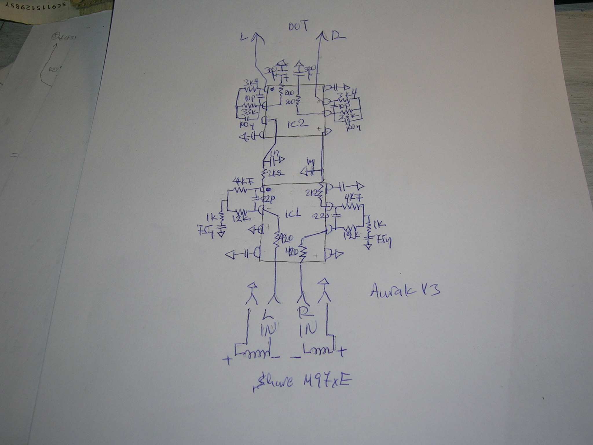

I would rather have dedicated MC stage as I have a dedicated turntable for MC. Less compromise. But you see rather than look at the schematic I posted and considering transimpedance for its merits in this application you would rather insult me! That makes you no better than those you complain about. This appears to be a thread full of pots. My point made once again.

Wow, Bill! I was being polite in not addressing your schematic. It is too narrow for general use.
You've told me my system is no good and only today that an MC stage would be wasted on me so why hold back all of a sudden 😛. It's not 'my schematic' anyway, its a joint effort of cleverer than me types.
But you did say
I hope we can go forward and discuss more constructive things, even if they are sometimes controversial[\quote]. So lets discuss why this is too narrow for use. I've dropped 'general' as this is not a commercial product, but seems applicable across a wide range of MM and MI and gazillions of those are sold each year. I would hazard shure sell more M97 each year than the whole high end MC industry. So plenty of people could DIY this. The question is does the concept have merits?
After all, when discussing how to move the game on we should not care how popular something might be, but whether it is actually better or not?

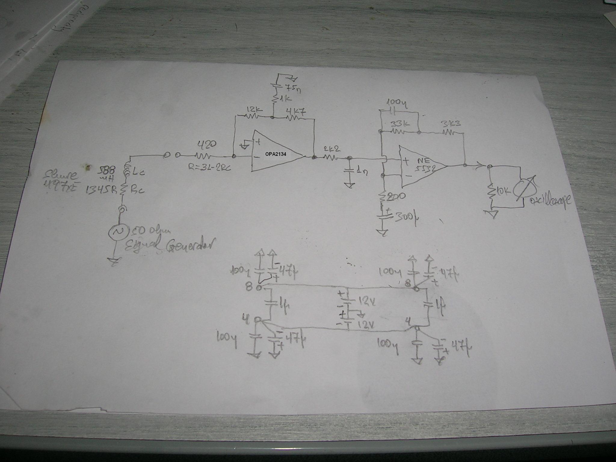

The equation for the 420R input resistor (3L-2Rc) cannot be correct, because the units are not consistent.
For most carts 2L-R is used. Yes it's not dimensionally consistent as there is constant of 993 dropped out. But as fc=R/(2.pi.L) and you are solving to always have Fc at 316Hz you can see where it comes from.
3L-2R is for those annoying cartridges that won't play ball.
of 993 dropped out. But as fc=R/(2.pi.L) and you are solving to always have Fc at 316Hz.
So the "3" factor is actually "3x993 Ohms/Henry" instead, when the L is in Henrys?
Usually I pick parts for RIAA to 0.1%, so want to avoid a 0.7% error in calculating.
