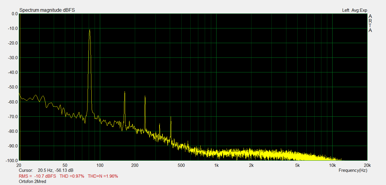

we don't have permissions for the Urls. Do you have distortion measurements you can share with us as I know a couple of people who would be interested in analysing those.
Edit: Sims that Hans did have a -80dBA noise floor WITH the cartridge connected for MM with the boards I'm building. As the lowest vinyl noise floor for DMMs is IIRO -75 then there should not be an electrical noise penalty. But stylus profiles could cause a db or so difference. the distortion difference does interest me though (not least that there might be real data to look at 🙂 )
Ortofon 2Mred, at 80Hz/20um amplitude.
