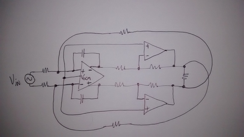

Bold mine: my point is when you take an inverting config and ground the independent source you end up with exactly the same circuit. The noninv input is already grounded and the source would normally feed into the Rf resistor to the inv pin, that source is now grounded and you get the same circuit with the Rf normally grounded, the source feeding into the noninv input which now gets also grounded. So in the case you break the loop between output and the input to the feedback circuit, both configs become identical.
Jan
My apologies, I looked at R3 not as Rf, but as a Rn running between the input pins (brain-farted the whole circuit). So, yes, they'll look the same. The essential difference here, is the forward gain (absolute value at least) is going to be different between the inverting and non-inverting configurations when set up like this. A g = 2 vs g = -1 (or 21 vs -20...) makes it such that it's appears to me that you're making and apples-to-pears comparison. Close, but not quite the same. We'd need to change up the resistor values to have a g=2 vs g=-2 comparison, whereupon the noise/loop gain functions would obviously change.
So, yes, the noise gain and loop gain of a g = 2 circuit will be the same as a g = -1.

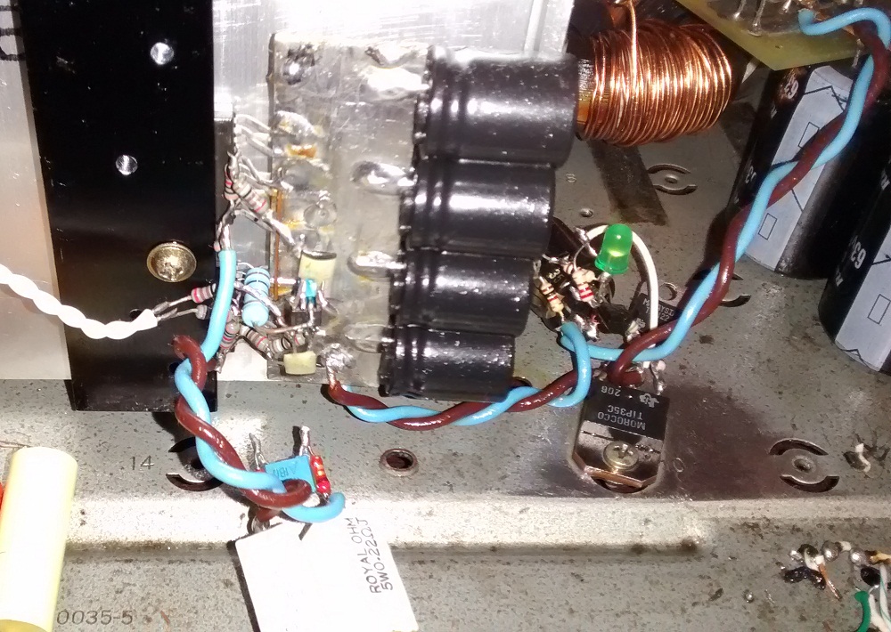

It is clearly better than my previous attempts (non-inverting). And I didn´t use non-inverting buffers in front of the THS4131: I just used a floating source going directly into the series input resistors. The source doesn´t have opamps or feedback. It´s dacs and common-gate I/V.
Sorry for the terrible looking picture (I tend to spray WD40 to rust-proof my projects). But I wanted to show how simple and good-performing this is, in case someone hadn´t looked at this type of amp yet. This is Nelson Pass IP (super-symmetry). But I have not seen a floating power supply in an amplifier and I think it brings some advantages. There is some commonality with the EUVL I/V with its floating supply.
This one is a proof of concept, I simplified it to the maximum, so it has very limited output swing (due to using the same 32V supply for THS4131 and the two LM3875). But the principle can be applied to make a very good amp.
Two input terminals going to series resistors and to the THS4131, two output terminals (load across the bridge so it takes feedback from the two output terminals - very good), floating supply (single). DC offset is 0,2 mV rock solid (with AC coupled source). There is no DC path from the source to the amp (both are floating, I didn´t earth anything yet). Could have been DC coupled with only a differential servo at the source (it doesn´t need a common mode servo if you leave the amp floating and the "ground" disconnected). It is very RF immune and is my best sounding DIY effort to date. I am fully aware that my test amp doesn´t meet code, regulations, etc. This is experimental.
The THS4131 self-centers on the floating power supply, due to internal resistor divider feeding the Vocm pin (V output common mode). I soldered the THS on top of a 470nF MKT cap (from V+ to V- pins, there is no "ground" in this amp). The two feedback caps are 150pF NP0.
This is interesting to look at. With no ground connection, if you earth the source, then all voltages on all nodes of the amp are changing in relation to earth. Nothing fixed.
