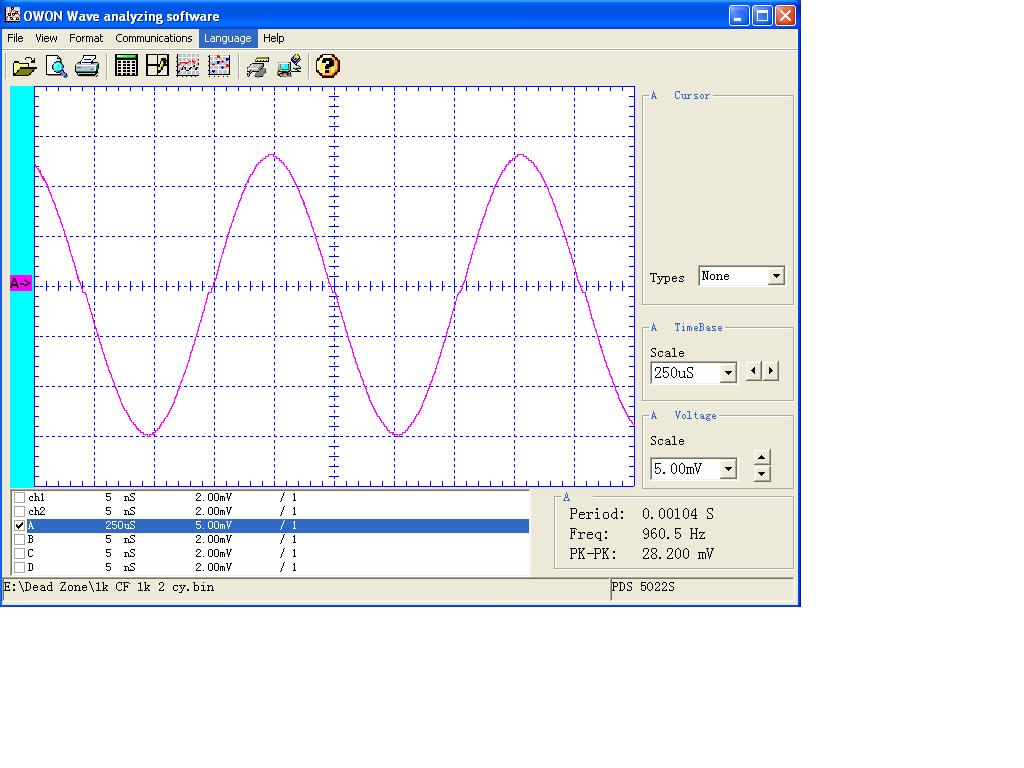

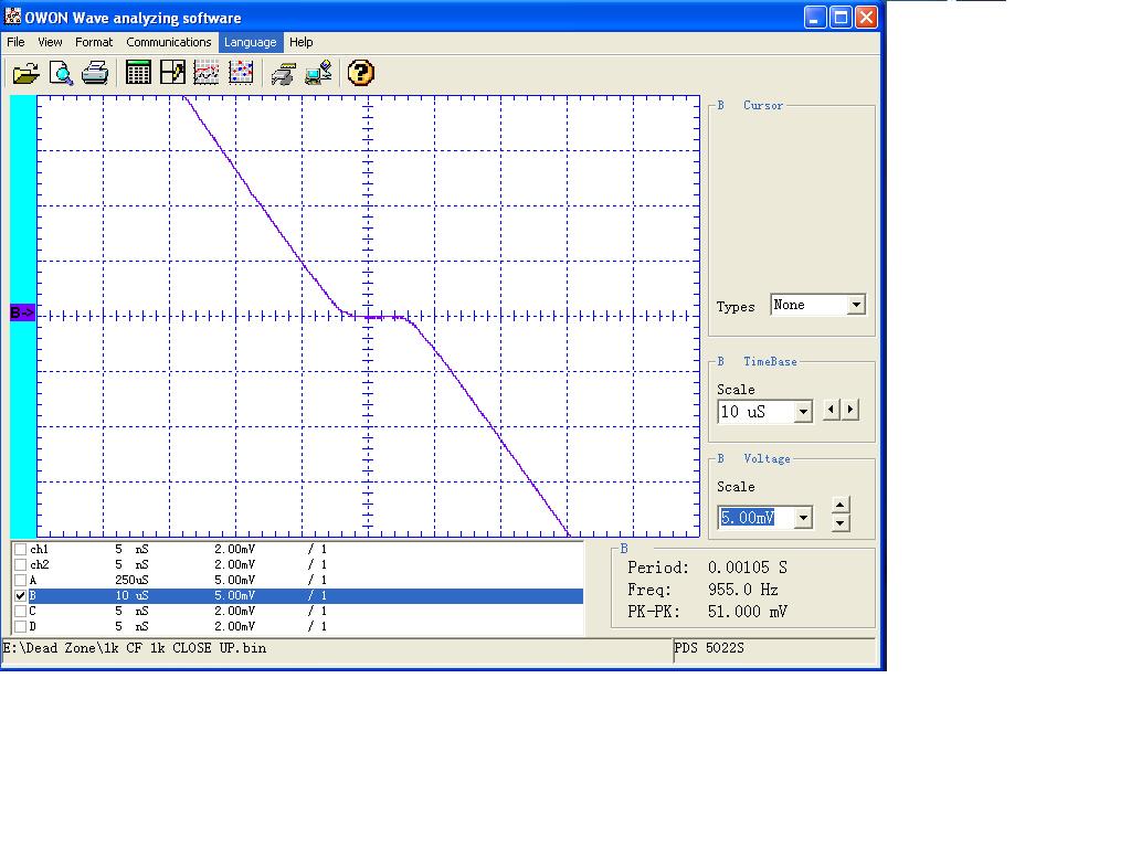

We were discussing attack not decay. Decay as far as I have found is always clean and linear unless of course it drops down low enough to be in the dead zones you don't believe in. Attack of a resonance must be started, you are certainly allowed to believe whatever you want. I'll look at measurements, experience and results.
I did an interesting church sometime back where the truncated transcepts acted as a classic Helmholtz resonator. Every one else had tried magic speakers, coating all of the ceiling with a thin layer of sound absorbing plaster, covering the back wall etc. Speech intelligibility was terrible. Adding 16 sabins in the right spot to each side solved the problem! Measured by both STI, humans and other software. A very non-linear result.
Attached is a screen shot of a voltage divider using a "good" resistor for the bottom and a "not so good" for the top. Multiple averages and a low noise preamp were added.
ES
