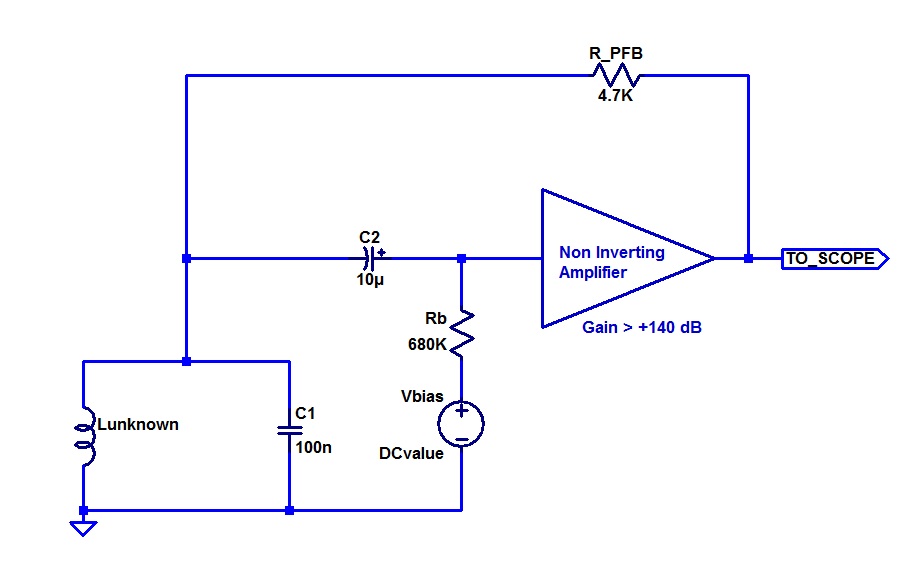

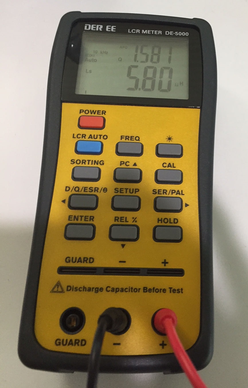

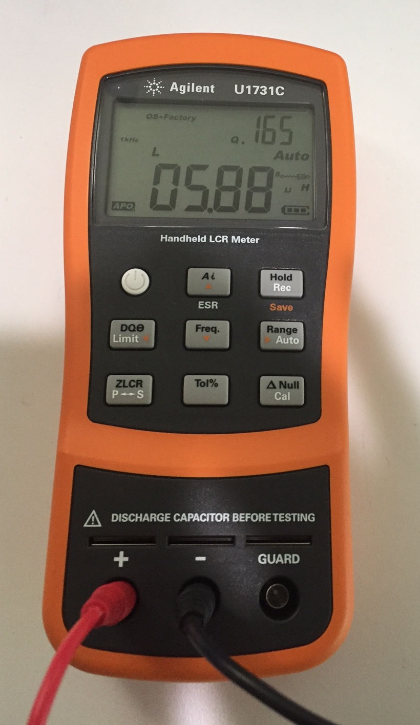

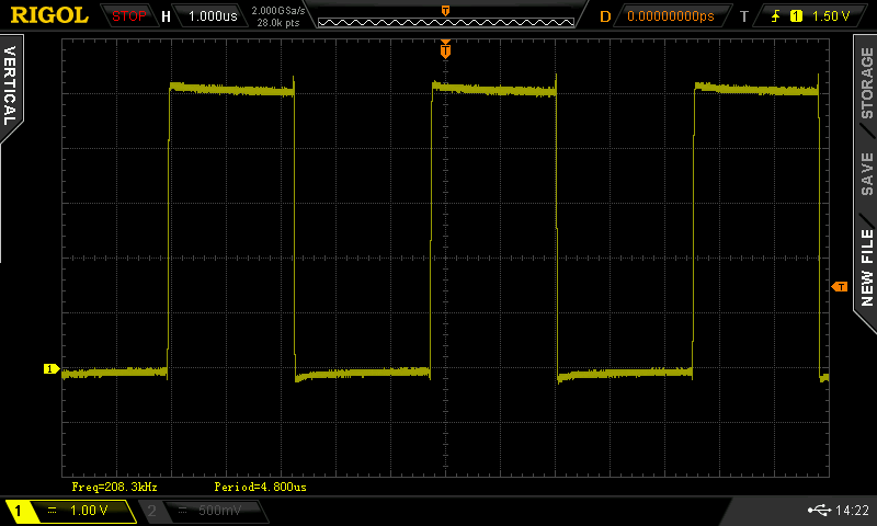

Just now I measured the inductance of a piece of 22 AWG solid core hookup wire. The segment I measured was 13 ft 0 inches long (396 cm). I laid it out on my benchtop (ABS plastic) in a rough circle, then taped it in place for measurements.
I measured the inductance three times with three different instruments, Figures 1-4 below. (Click on the images to remove compression distortion) The first two were LCR meters; their results were 5.80 uH and 5.88 uH respectively. The third was an LC oscillator (Fig 3), resonating the unknown inductance with a known fixed capacitor whose value is 100 nanofarads. Resonant frequency was 208 kHz (Fig 4), which plugs into the LC resonator equation, yielding inductance L = 5.84 microhenries.

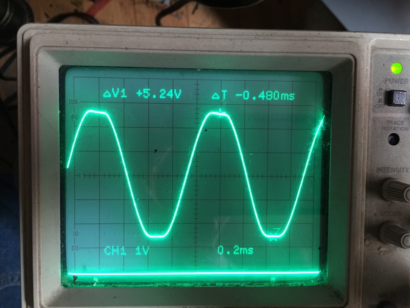

Here is the picture, symmetric soft clipping on 8 Ohm (1:10 probe)
