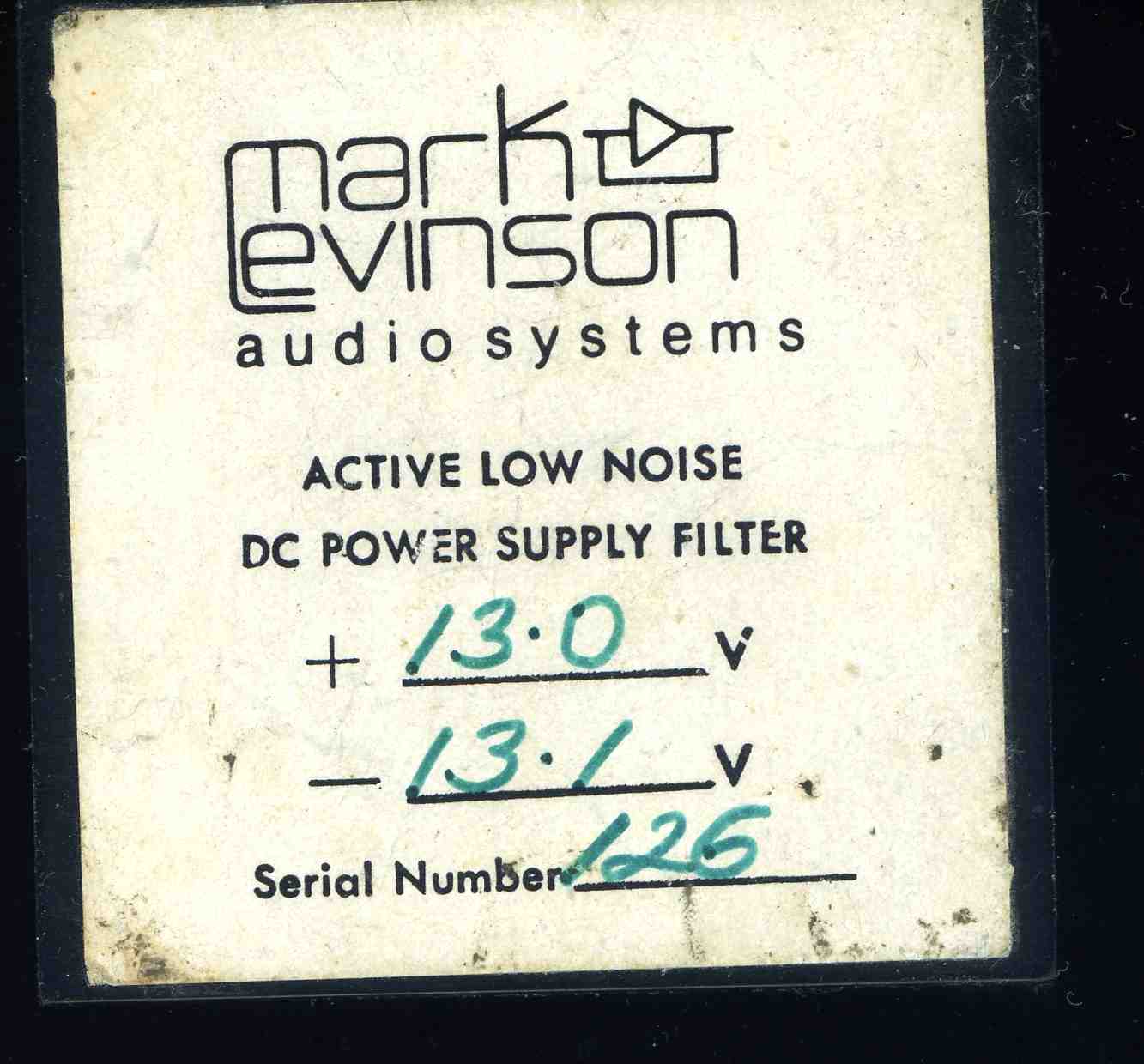

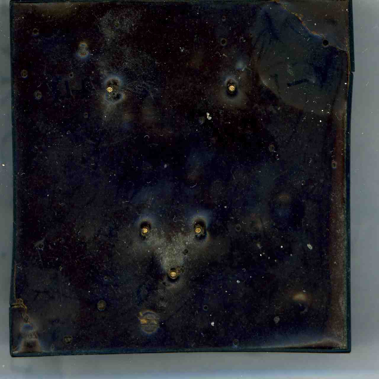

Tico, on second thought, are you referring to the internal phono power supply buffer module as the power supply module? That would make sense, since it contained 2 rather large electrolytic caps (of dubious design quality as they were purchased before Japan took over the field). They were practically 'babied' in the circuit with a regulated supply never exceeding 15V and a large series resistor, but who knows how the caps would behave over time?
Yes, the filter module for the phono section.
