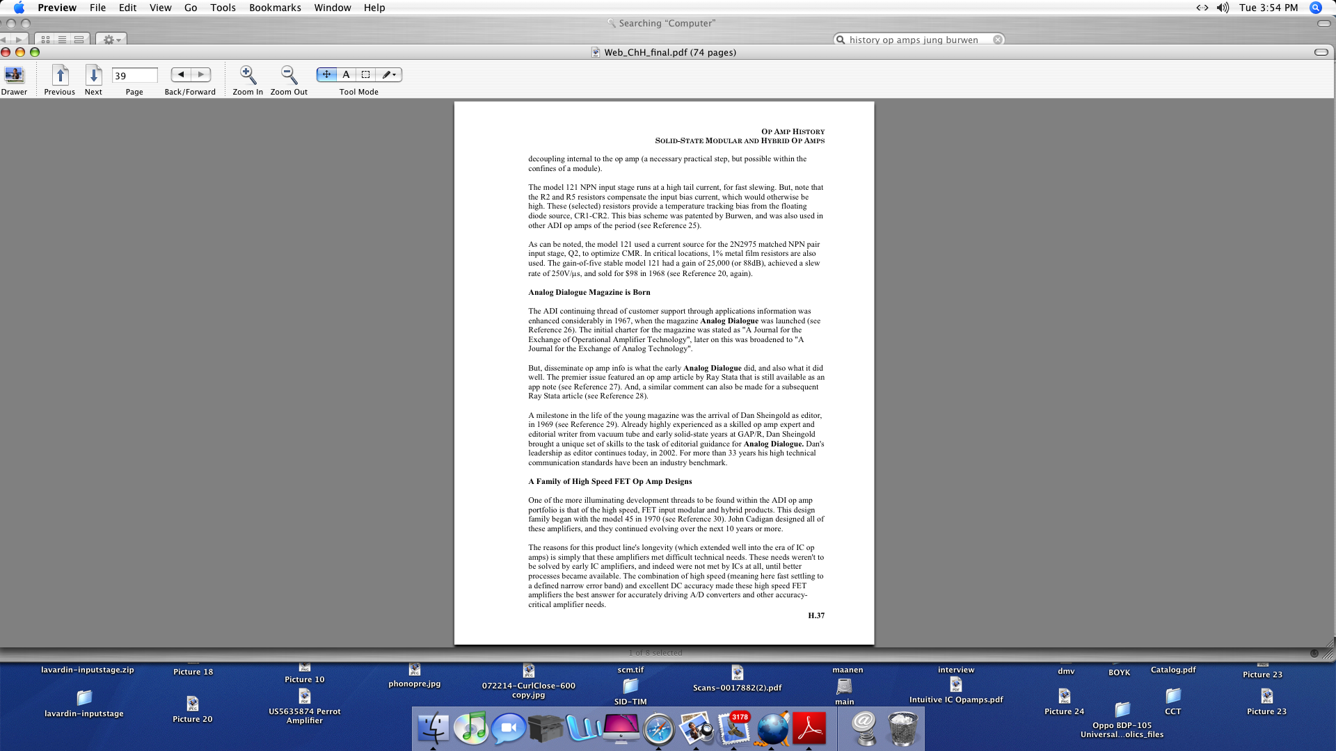

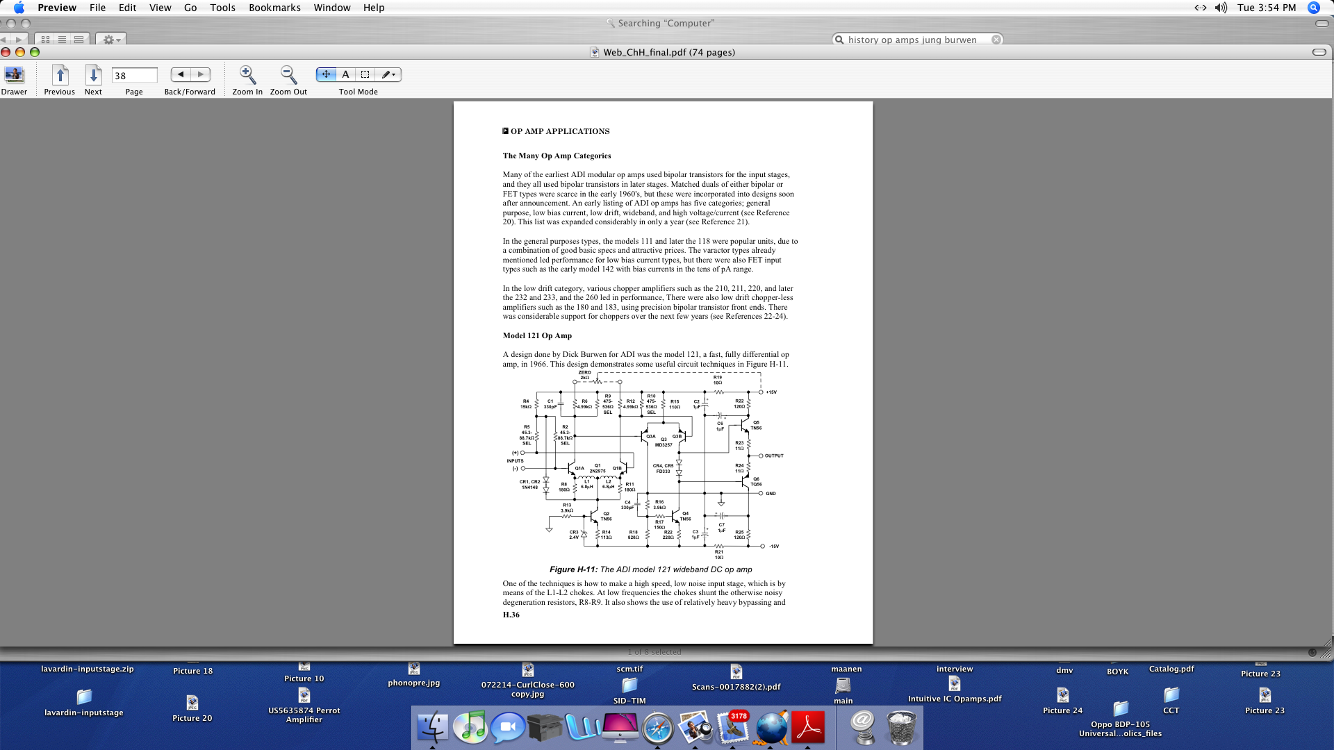

Well, I apparently gave a fellow circuit designer more credit that he deserves. I was told by someone, many decades ago that Dick Burwen was closely associated with Analog Devices, so I supposed that he was an early founder. Guess he wasn't, but just a consultant like me.
Here is what he really did for ADI, back in 1966. I respect fellow circuit designers who really show originality and creativity in their work, even if they disagree with me about audio quality trade-offs. Richard Burwen is certainly up there with the best. Equally so, John Iverson. Taking cheap shots at these or other designers, by those who have not done so much, or with such design originality, is revealing.

One of the techniques is how to make a high speed.. ..degeneration resistors, R8-R9.
The model 121 NPN input stage runs at a high tail current, for fast slewing.
The gain-of-five stable model 121 had a gain of 25,000 (or 88dB), achieved a slew rate of 250V/μs
and the part elided from the 1st quote
..which is by means of the L1-L2 chokes. At low frequencies the chokes shunt the otherwise noisy degeneration resistors..
is a 2-pole gain structure
in 1966!
