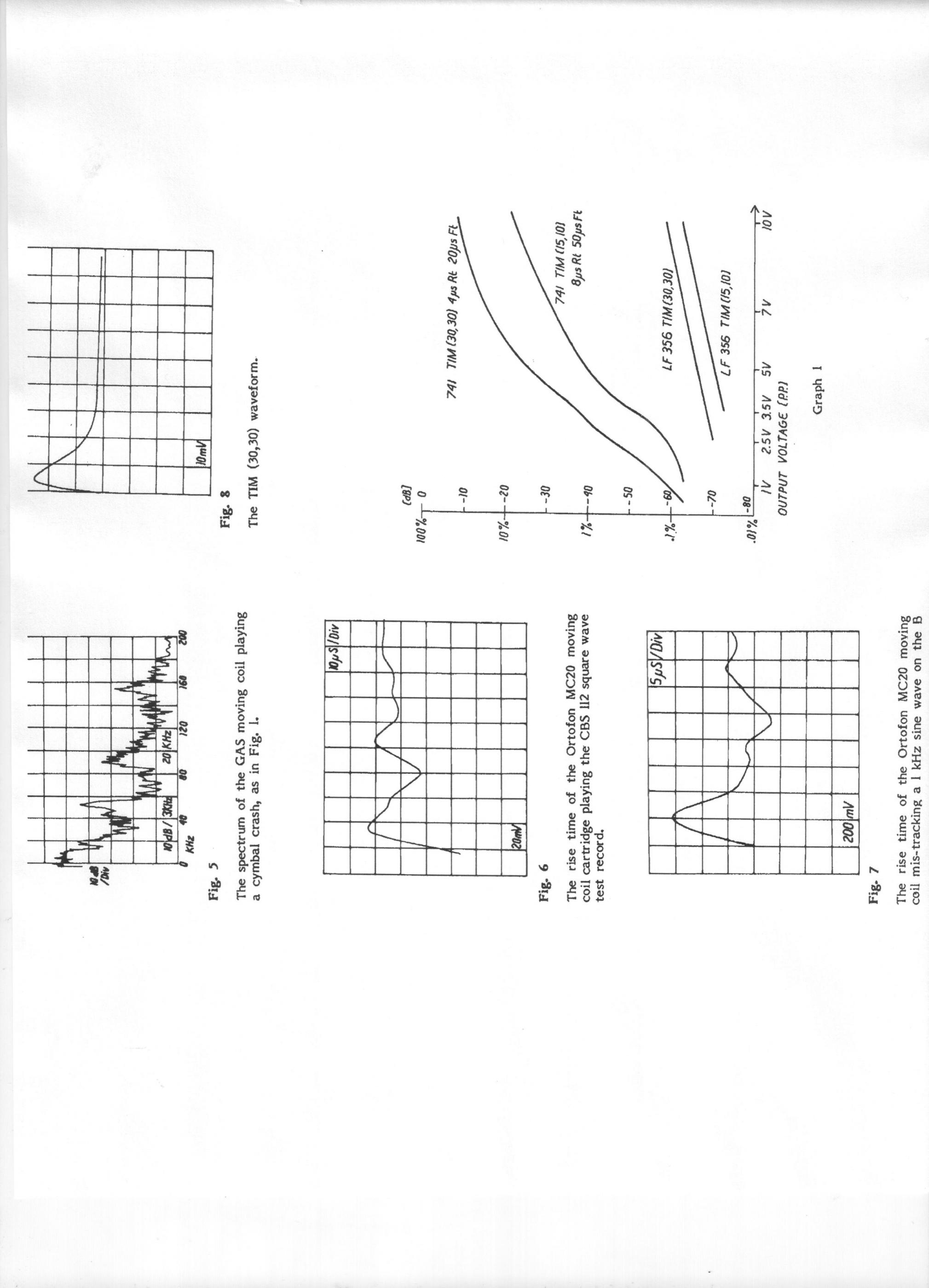

Yes that is said by many, but I don't buy it anymore*. Scott provide in his testing for the LA article that clicks really don't cause any problems, and a phono stage with a slow recovery should you actually exceed the limits is not fit for purpose. 24dB headroom seems to cover all but the most pathological record damage. If you are ripping to then process, the declicking in most tests seems to work better before correction.The MC stage without RIAA is an interesting idea, but has as a downside that short pulses from clicks and pops could (will) easily overload the amplifier stage. Why not have the easiest of all low pass filters get you the required roughly 10dB/decade down slope before or incorporated into the amplification stage, and then do the finer corrections digitally?
* I did used to believe this, but just because people write it down doesn't make it true. Think about all the flat MC headamps that seem to do fine.
As long as you stay all analog. They (clicks and pops) will wreak havoc not immediately known in ADC/DAC. The broadband distortion products from clipping add a harshness or false high-frequency brightness.

What happens if you try to pass the mistracking transient shown in Fig. 7

John: Would really help if you scanned the part of the page that stated what the test record was. Given Scott managed to trace the square wave CBS test track pretty well with a Grado I am not sure what your point is? If you can give me a test you want doing once assembled happy to try it.
