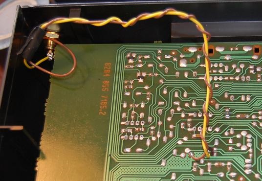

Sorry Dick I over reacted. I thought I was clear this is not a mis-termination but an impedance discontinuity (and a very small one at that). The electrical length of the connector is 40 psec or so and as far as I can find out the rise time for SPDIF is 20 nsec at best or about 2mV in 40 psec. I can't see this being observable considering some of the internal wiring I have seen.
yikes... that pic is scary wiring for HF/RF data pulses.........
extra unnecessary comment for some others is this....... discontinuity causes Z change and reflection etc etc. If, coming directly off the IC, the Tr would be much faster than 20nS. Depending on the magnitude of the Z change at the discontinuity and its reflected polarity... again, etc .... data error possibility is high. BUT, if you use a BW limited pulse transformer between O/I then the Tr is slower and more 'controlled'.... small discontinuities are less probmatic.
The Tr is around 20nS with transformers designed for audio digital. http://media.digikey.com/pdf/data sheets/pulse pdfs/pe-65x12_rev2006.pdf
But be sure jitter doesn't increase after you add transformers on your favorite gear.
and best practice would be coaxial 360 degree connection on connectors and not have pig-tails on such signal lines.
