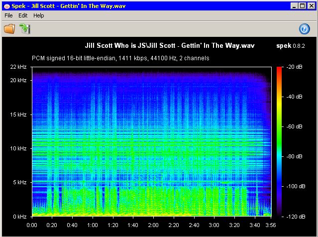

I have read about - but forgot the name of - a tool that could calculate/estimate the effective bit rate/depth. It was used to check if a file was true HD or just upsampled from a lower resolution. That seems like a useful tool, especially for the lossy M(arketing)QA format.

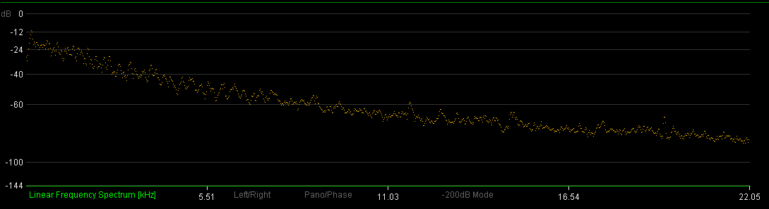

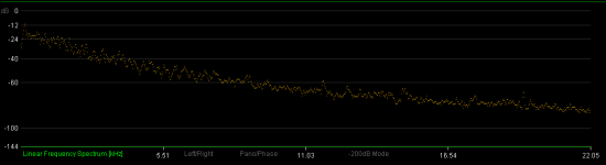

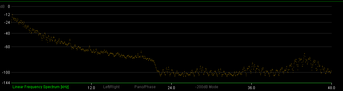

Well, it doesn't seem to work in a case I've got at hand.
A year ago I downloaded a 24/96 version of Beethoven's "Emperor" Piano Concerto from a reputable British outlet, and did not like the sound. I had a look at it with a program called Music Scope, and it was obvious to me that the HD version was produced by manipulating the original recording. Shown in Att. 1 is the peak spectrum of the entire 1st Movement, with a very suspicious content past 20kHz.
I then wrote to the label that produced the recording and they confirmed that the only master they have is 24/44. They also said to take action against the outlet, etc.
I subsequently downloaded the said master, the peak spectrum of which is shown in Att. 2. The HD version has probably not been upscaled, but it was certainly upsampled, which this application did not identify (it reports "Clean").
Note that the master was recorded without using an AAF, which is almost a matter of routine with this label.
I got the money back from the British outlet, but it took them more than six months to remove the fake HD version from their website.
Braca
