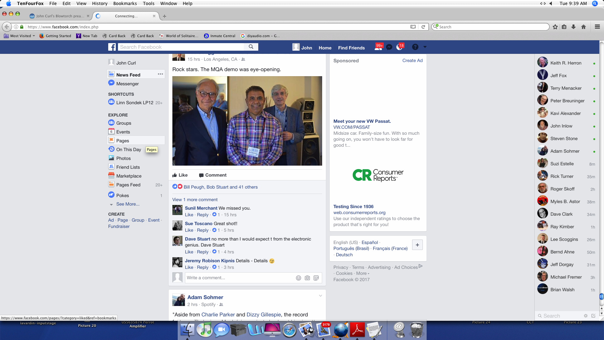

Here is a picture of what I listened to, and the people running the demo.
Perhaps the more interesting part of this photo is that you have over 100 ignored requests of friendship, along with no profile photo.
FWIW I generally consider that a mark of trustworthiness in this day and age, however it could also be that it's just a mark of being 75 years old on social media.
