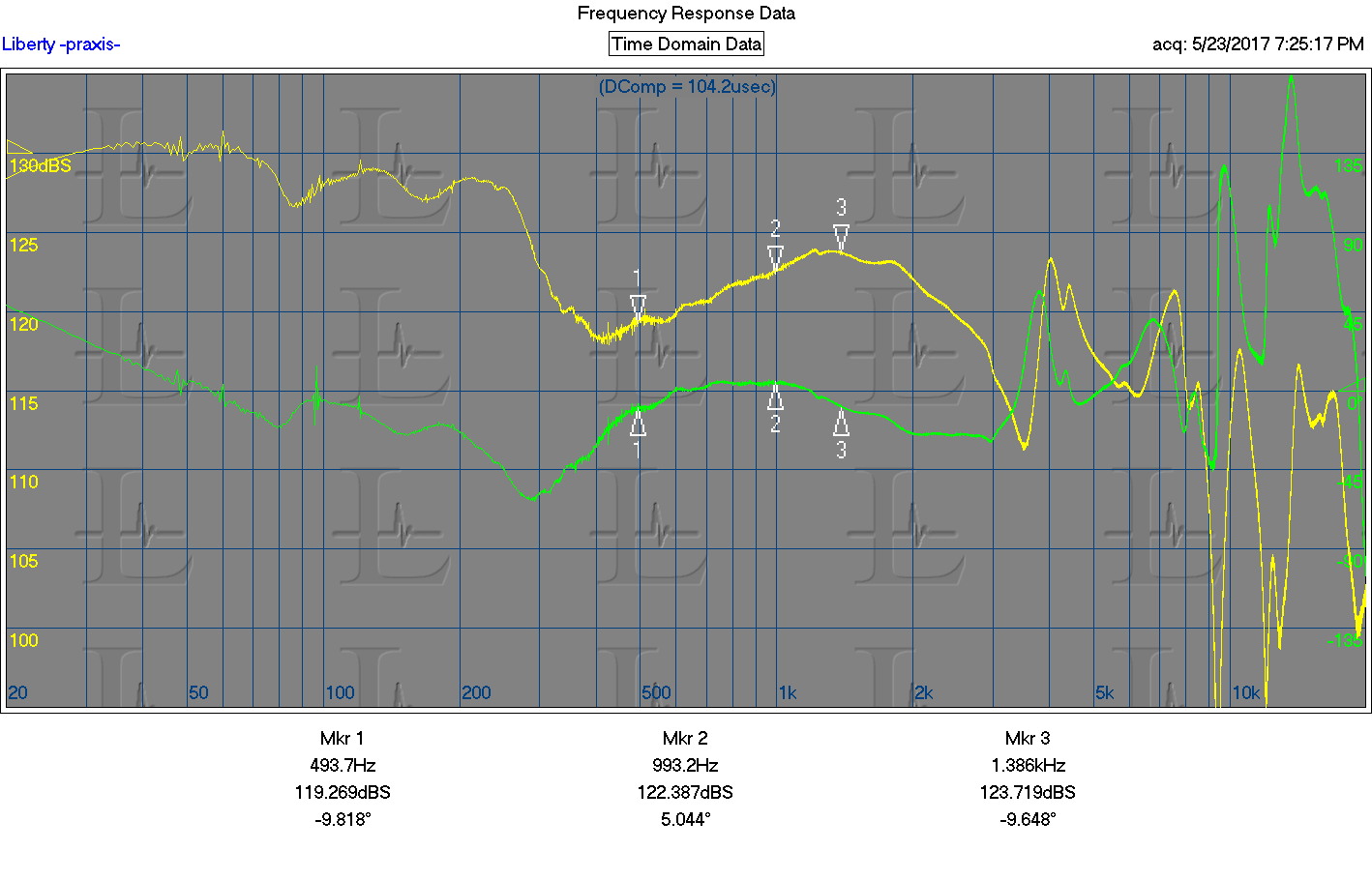

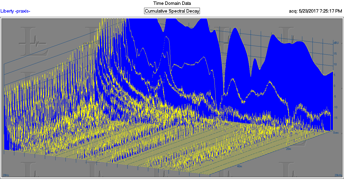

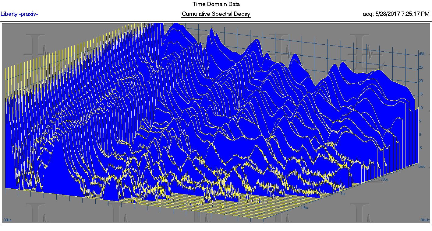

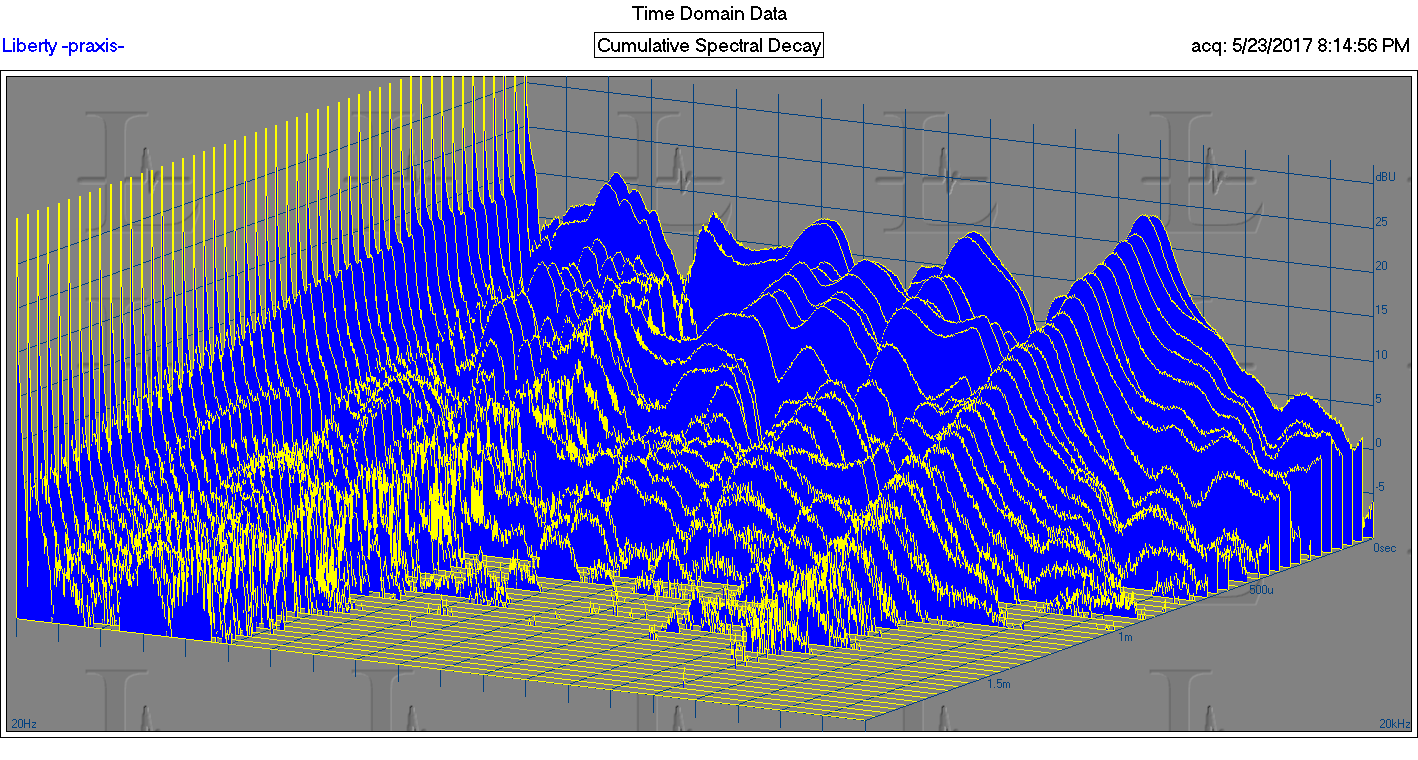

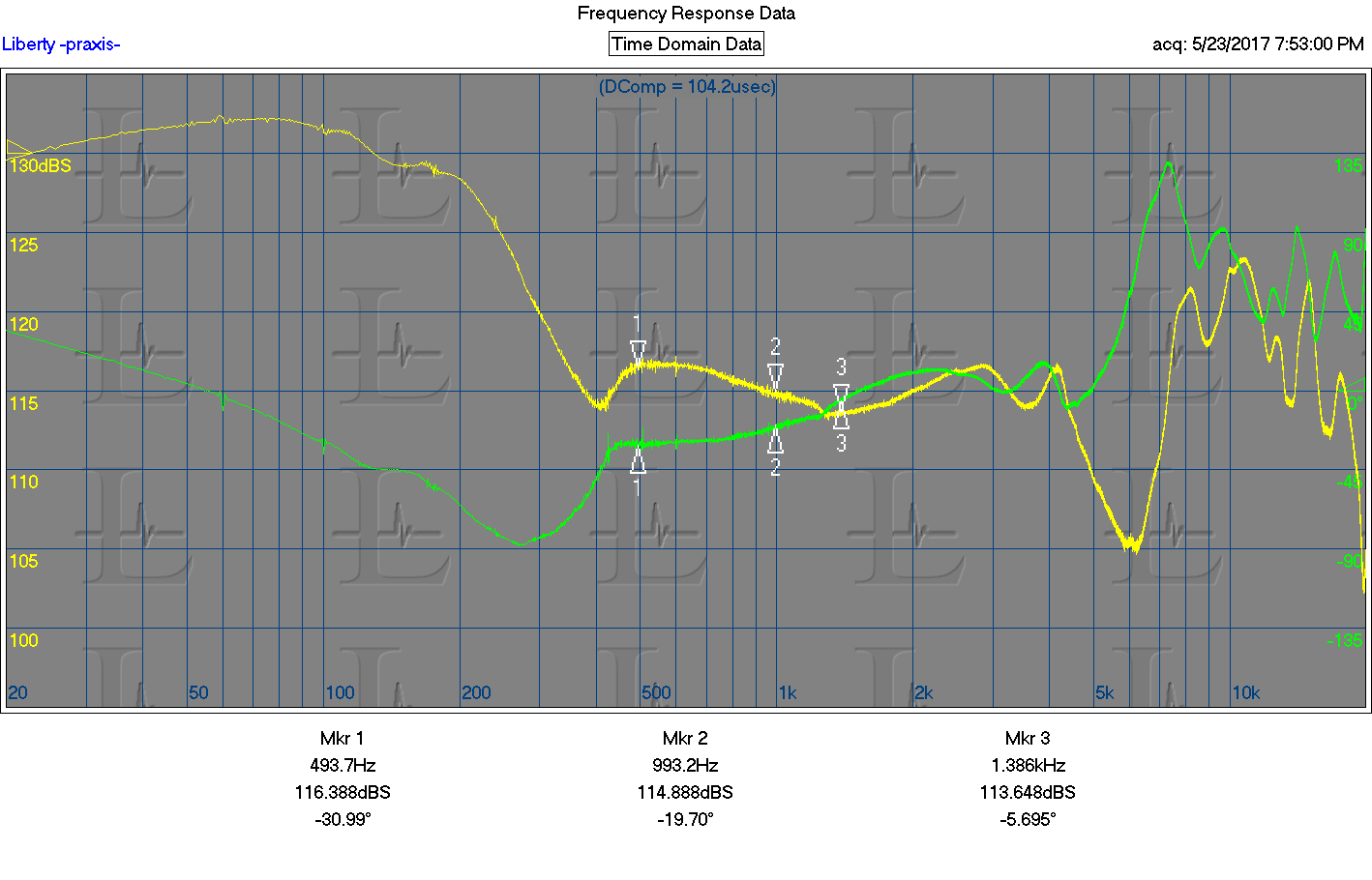

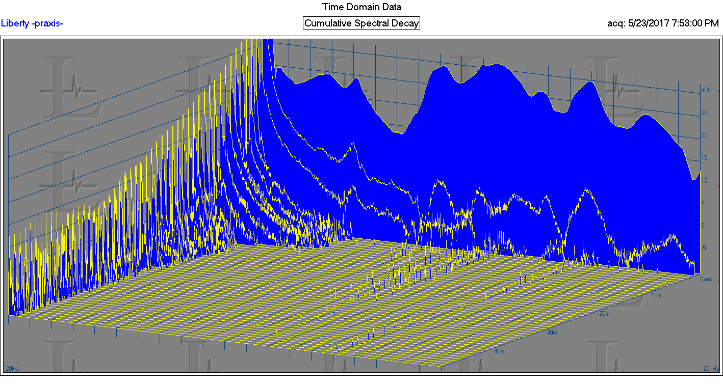

I'm still lost on the phase linearization thing. Attached are some plots of a not special headphone. The nominal measurement level was 90 dB SPL. Selected because the distortion was around .1%.
First a 50 mS waterfall. The vertical is around 40 dB. You can see the decay at low frequencies and the power line artifacts. And that there is no real info here.
Second is a 2 mS waterfall. This is more conventional and shows the stuff you would look for to improve the driver (and housing in this case).
Third is the time domain response (impulse response) that the waterfall was derived from.
Finally the amplitude and phase response, Decidedly NOT flat.

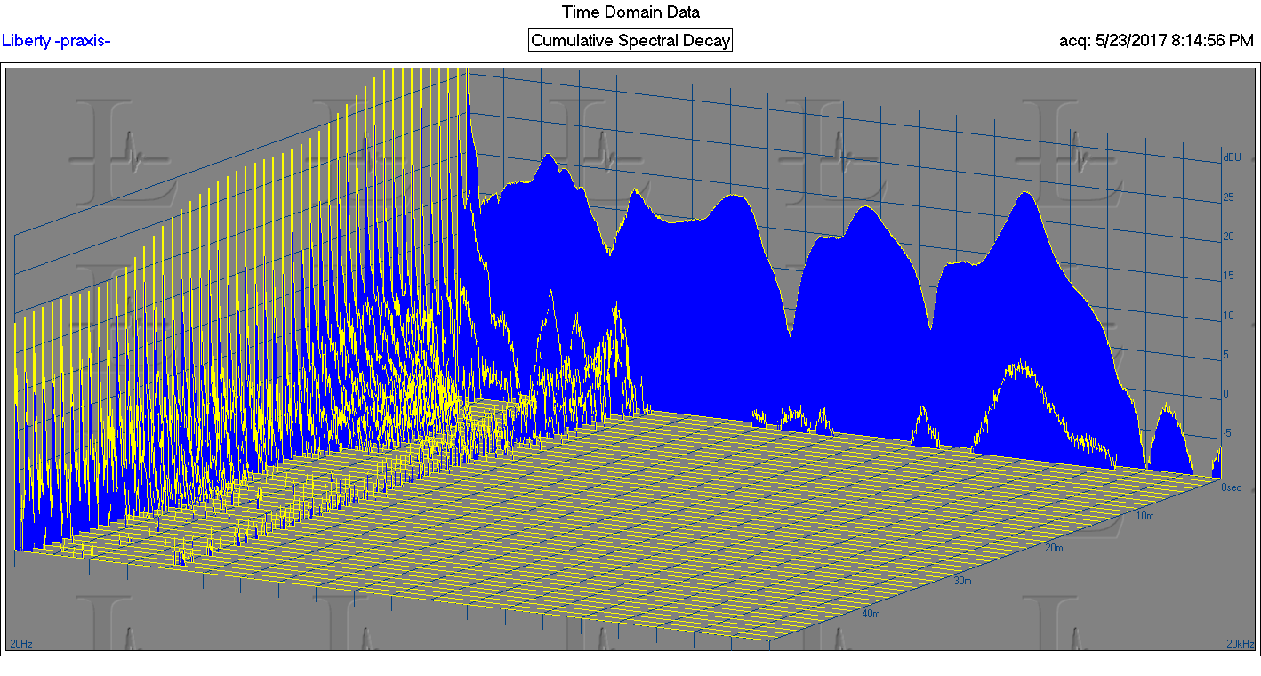

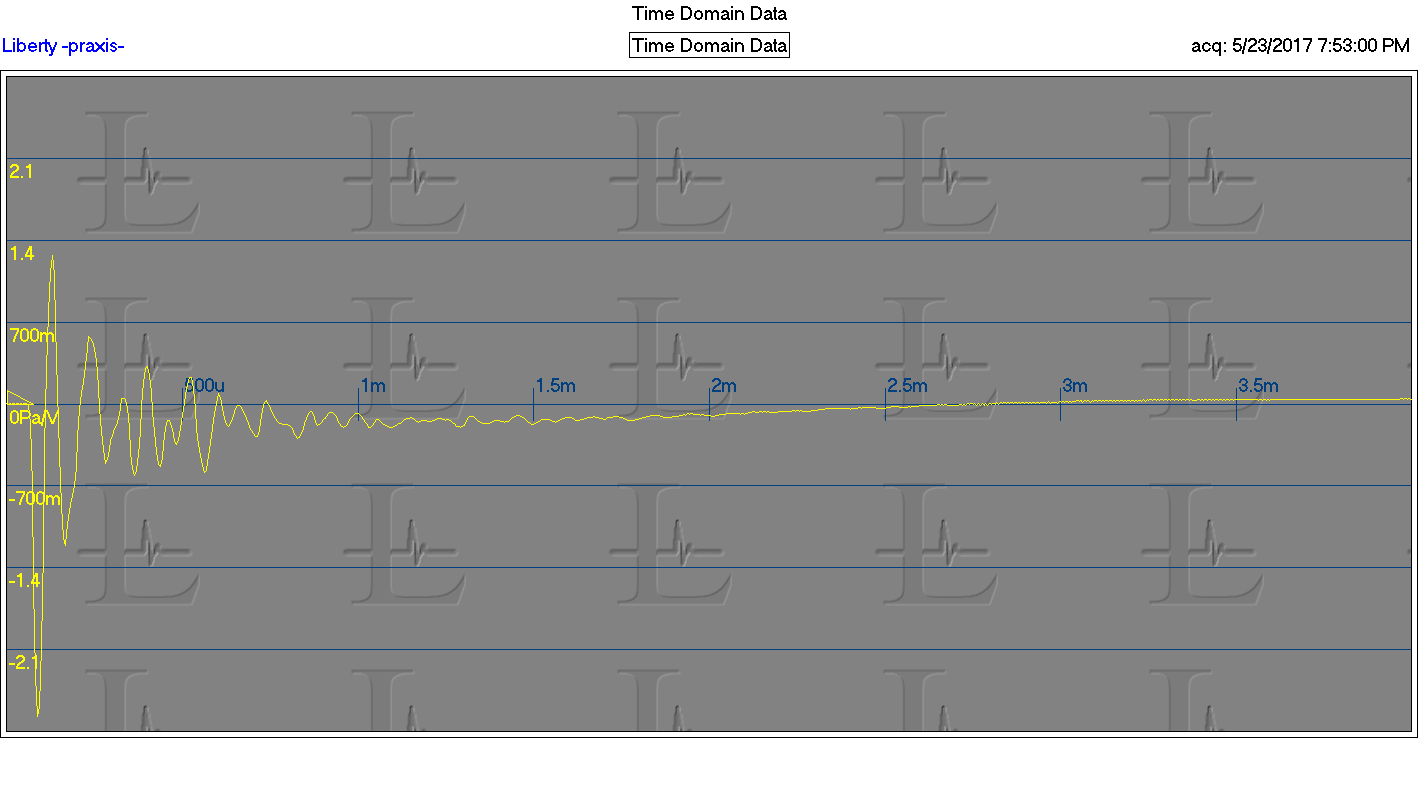

I'm using headphones because they bring their own quasi-anechoic environment with them. If I can find a noise cancelling headphone i'll try that as well.
Here is another headphone with a different phase and frequency response. What should we see as an artifact?

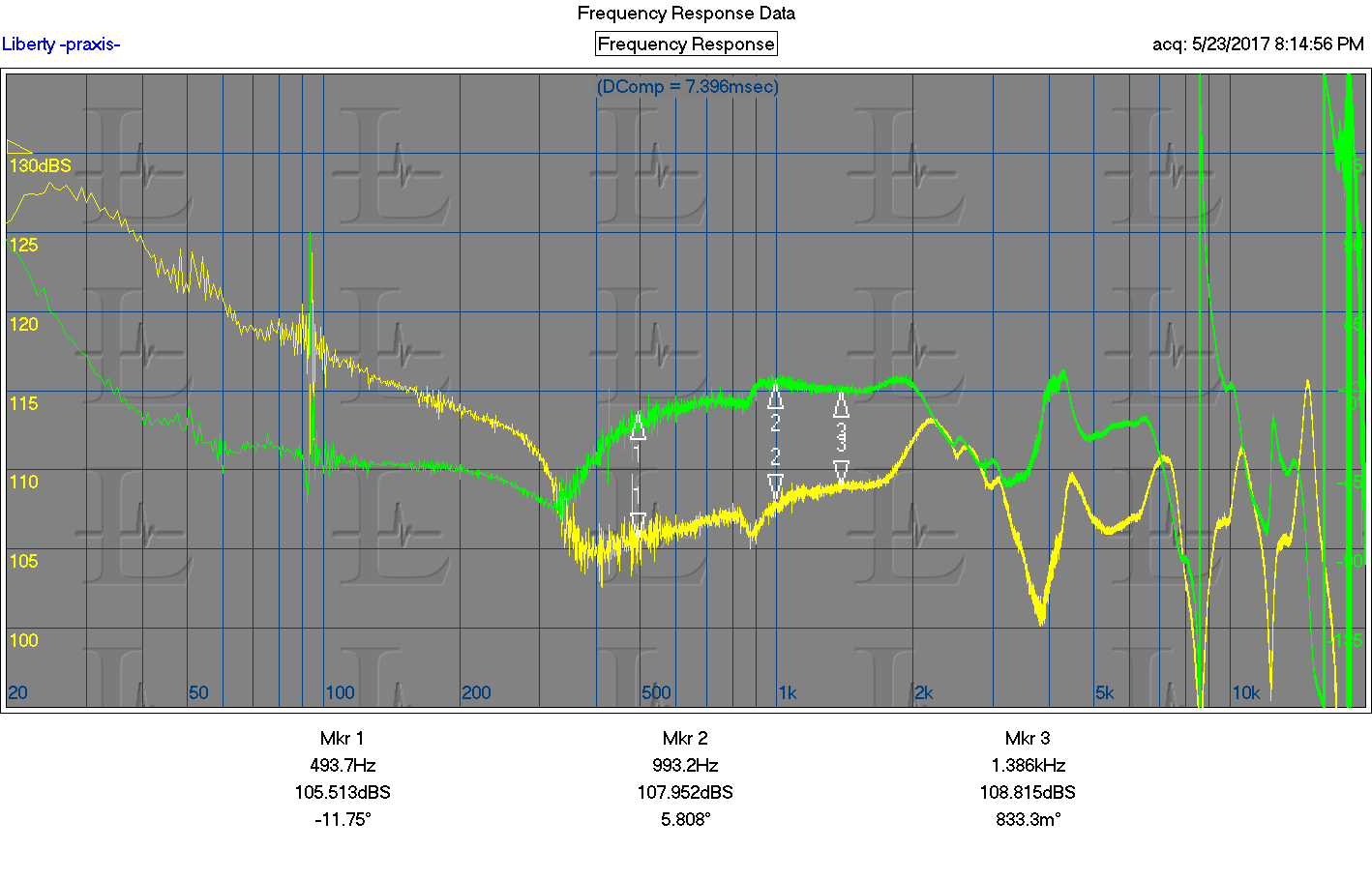

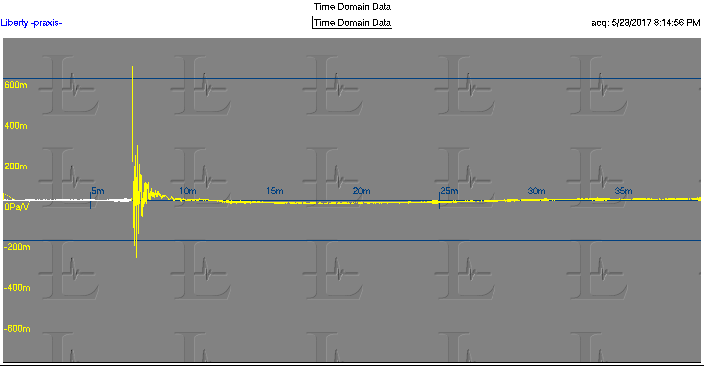

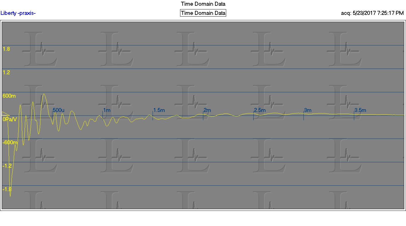

I found a digital noise cancelling headphone. The delay through the DSP shows in the time domain plot with 7 mS delay. The frequency response shows the impact of ANC in the bass.

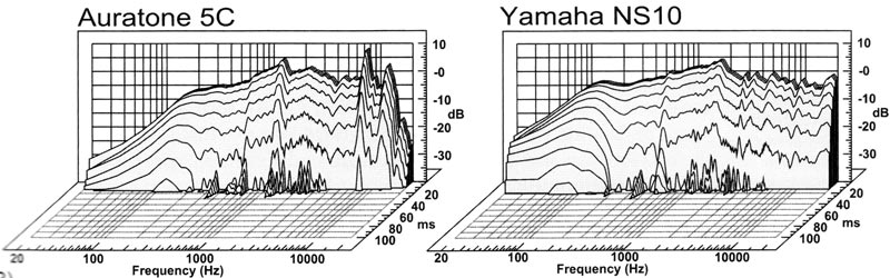

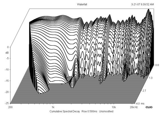

It has to do with how nice impulse responses look, and maybe waterfall plots too (possibly those produced by FFT processing of the impulse). However, waterfall plots can also be produced with bursts of sin waves, so at least no issues with possible FFT artifacts that way.
A good driver will not show many resonances and all freqs decay fast and at same rate.
Such as this ---

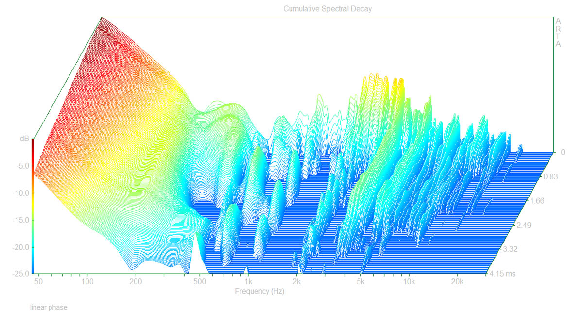

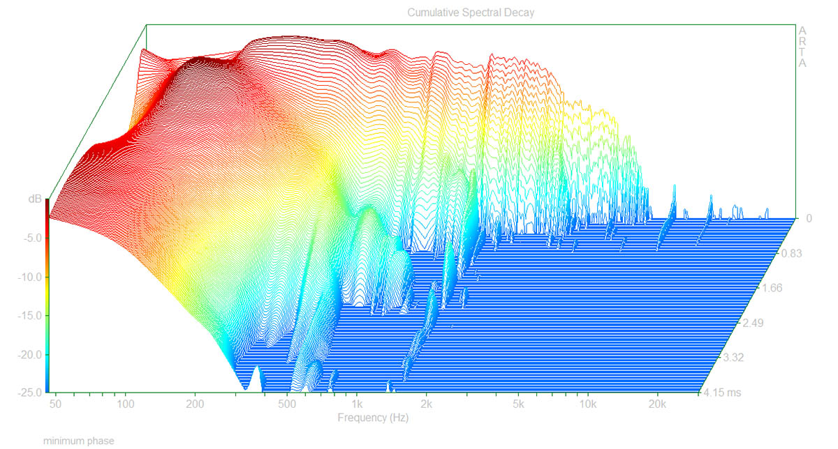

I went through my library of measurements and found good examples to show the difference between how a phase corrected speaker measures against one that isn't (not the same speaker).
The left corner cannot be trusted (what else is new?).
Although the measurement of the linear phase speaker might look cleaner, it is quite shitty as a matter of fact in comparison to the minimum phase speaker.
Measurements were both done in the same anechoic chamber, albeit at different times.

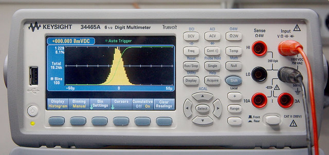

One thing I do with the Keysight is measure totalized noise, offset and offset drift. These measurements run over long periodes at the maximum resolution of the instrument. The result is this (see picture) Gaussian curve, this one (after 15000 measurements, about 7 hours) shows a spread of (max) 20uV (I guess about 5uVrms). All amplifiers are tested in this way before leaving final assembly, if the base of the curve is not wider than 25uV the amplifier is acceptable 🙂
