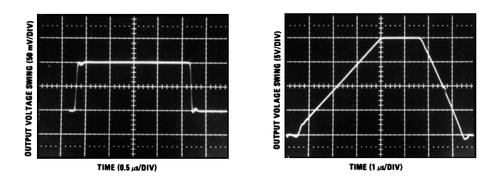

There are plenty of examples of amplifiers that can't reproduce a 20V peak to peak square wave at 10kHz but are fine at 100mV. It's a mathematical fact only for a linear system. If I collapse a cantiliver or push a driver out of its surround they are no longer linear. There are amplifiers that ring at square wave peaks under load due to some internal mis-behavior and show no small signal peaking even with the same load.
I made no mistake and nothing needs correcting. You continue to not qualify your statements with enough precision or maybe you just think we are all idiots and not worth it.
