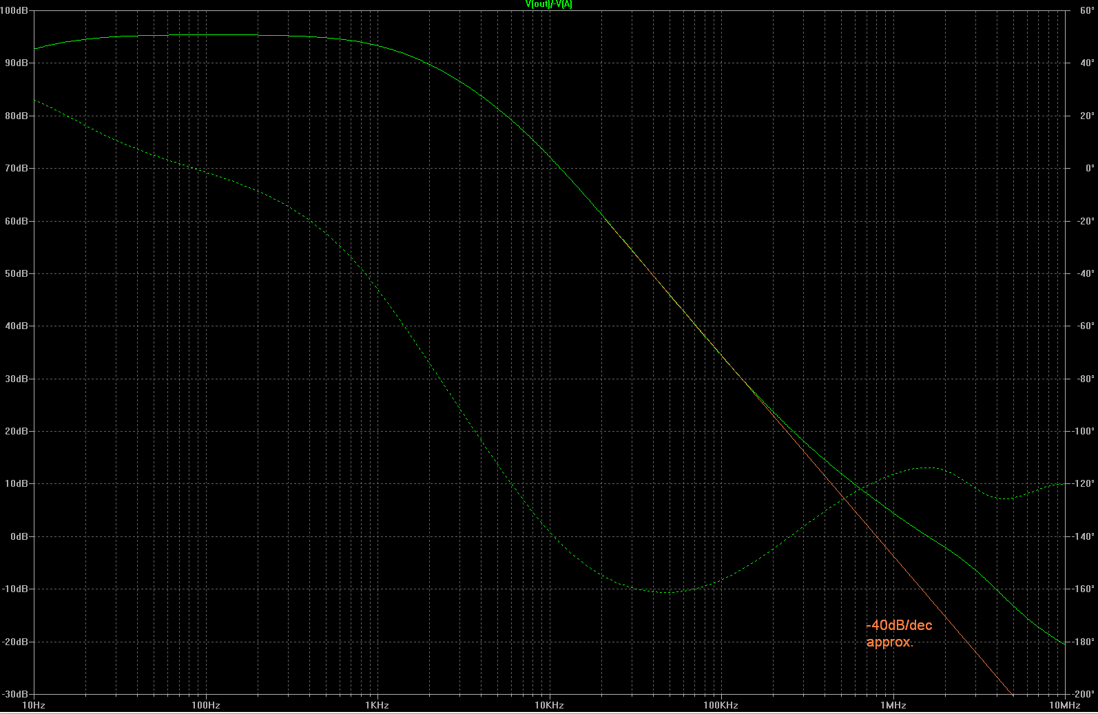

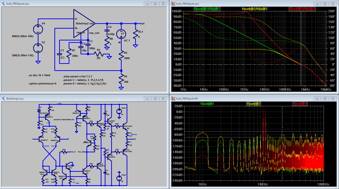

amp from Bob's book - 3 compensations:
green trace - nominal dominant pole
yellow trace - added 300k R, R||Cdom to flatten gain, get "wide open loop gain" (couldn't load the beta enhanced VAS out heavily enough with shunt R to gnd)
red trace - 2-pole
PIM distortion?
we could examine green vs yellow 1K IMD diff phase - and they do differ by ~90 degrees which could be interpreted as one being "AM" and the "FM/PIM" IMD
at best for John's/Otala's formulation the dominant pole "low open loop bandwidth" has 25 dB less error at 1KHz, leaving "pure FM/PIM" residual vs the "flat gain" case
there is no reason to believe the phase relation makes "PIM" order of magnitude more audibly objectionable than "AM" IMD
and then there's the 2-pole red trace IMD components...
also note that 2-pole compensation is the only one showing a 20 dB improvement in the 21kHz IMD sum distortion product amplitude

actually looking at the red 2-pole trace there is a good case for human hearing purposes that @ -160 dB the 1 kHz IMD product (the vector sum of "AM" and "FM/PIM") "doesn't exist"
please cite any reference to human listening tests of the audibility of +/-90 degree rotation of -60 dB harmonic and IMD product phase
or link to a piece of hi res music or test tone that you think would make "PIM" clearly audible and we can process it with "Hilbert transformer" I/Q sideband math and post for listening tests

You could make the case that the red 2-pole is so much better than the green low bandwidth because the two-pole 'artificially' extends the OL BW.
Jan
by eyeball I don't clearly see where the phase advance is coming from in the amplitude slope - maybe you're trying for a "fractional pole" slope?
so I wouldn't say without the circuit to sim, probe to move around

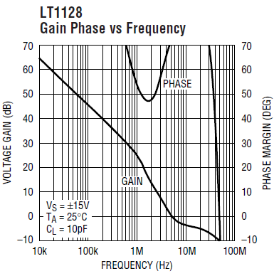

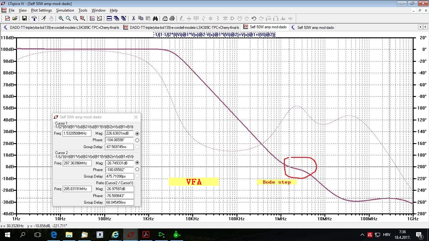

what's shown looks like adequate phase margin at the ulgf
but you don't show high enough f to see the gain margin and the phase seems too flat in the last few octaves without some gain peaking in the next to pull it up
how does it sim in .tran with ns t_step size?

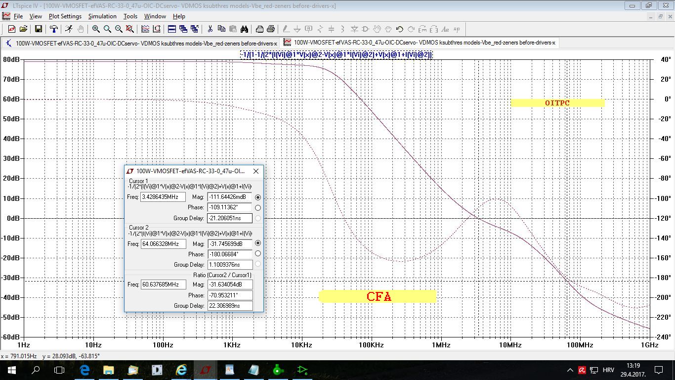

Here are two Bode plot examples, first one quite similar to PMA's and it's VFA with TPC and added Cherry cap from the output to the TPC middle point and other one is CFA with similar compensation. The CFA is working amp and very stable. Both Bode plots are extended up to 1 GHz to see the Gain Margins.
