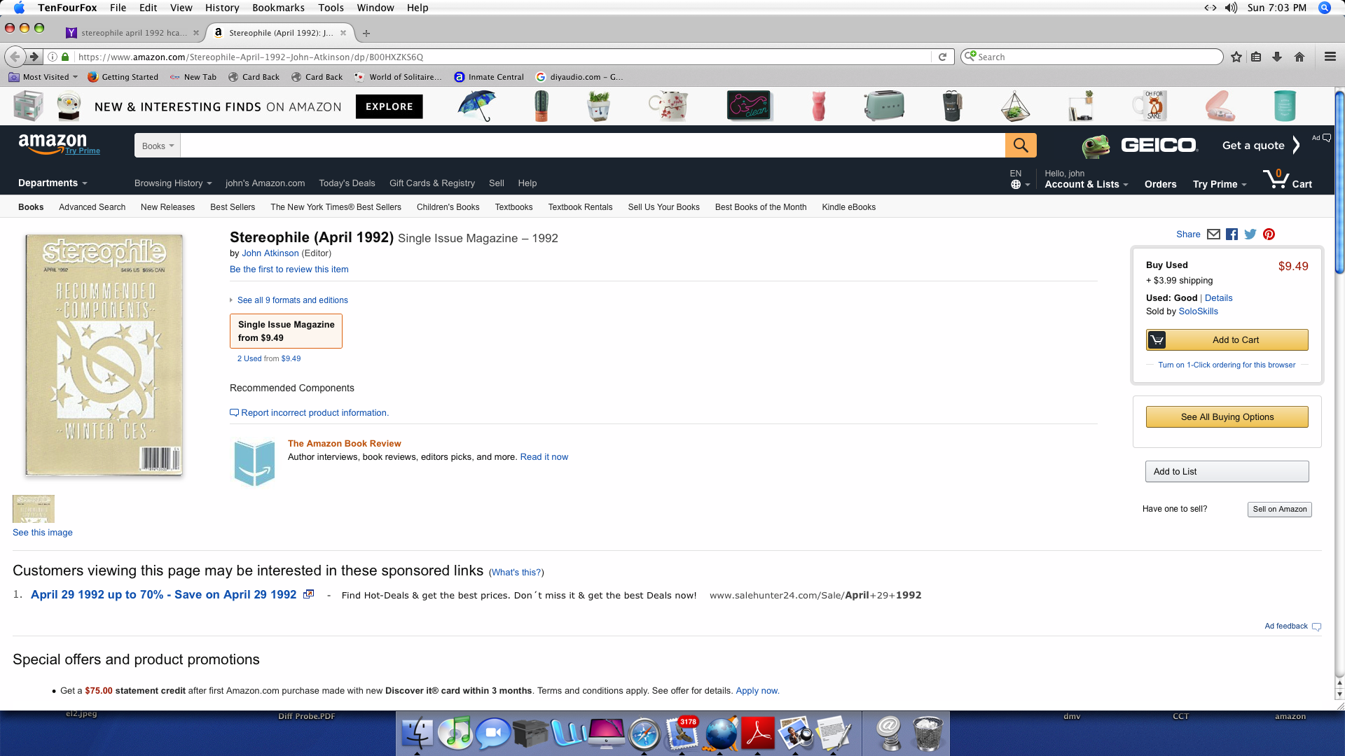

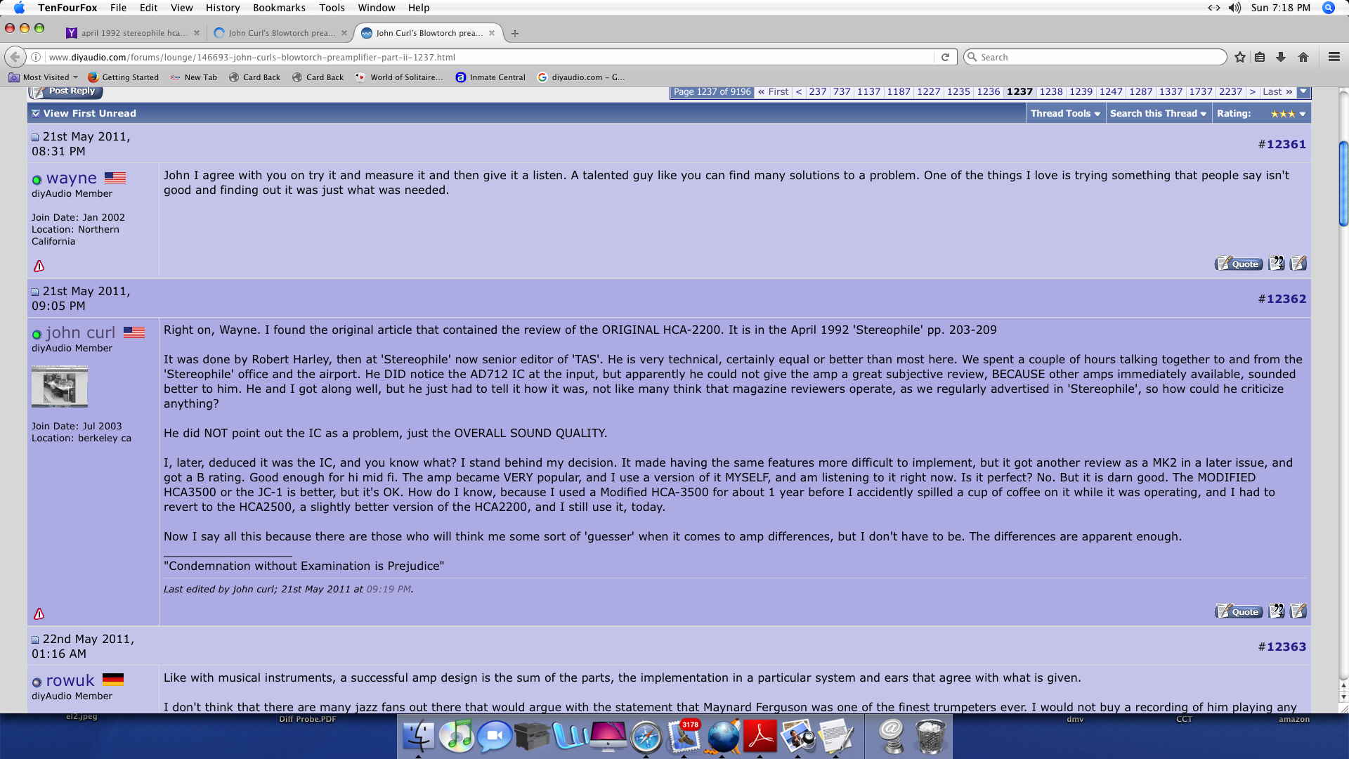

Hi everybody, If somebody out there has this actual issue of 'Stereophile' April 1992, could you please put the review article up on the HCA2200. I have seen the review, but I have lost track of the actual review. I am pretty sure that there was little or no prejudice against IC's regarding this amp, but I could be wrong.
Well, I found the issue and article. More later, but I was forced to fix the unit, before it could be successful in future. Bob Harley found great measurements, (a little noisy) but lousy overall sound. Why? I took a chance and removed the IC, and voila !

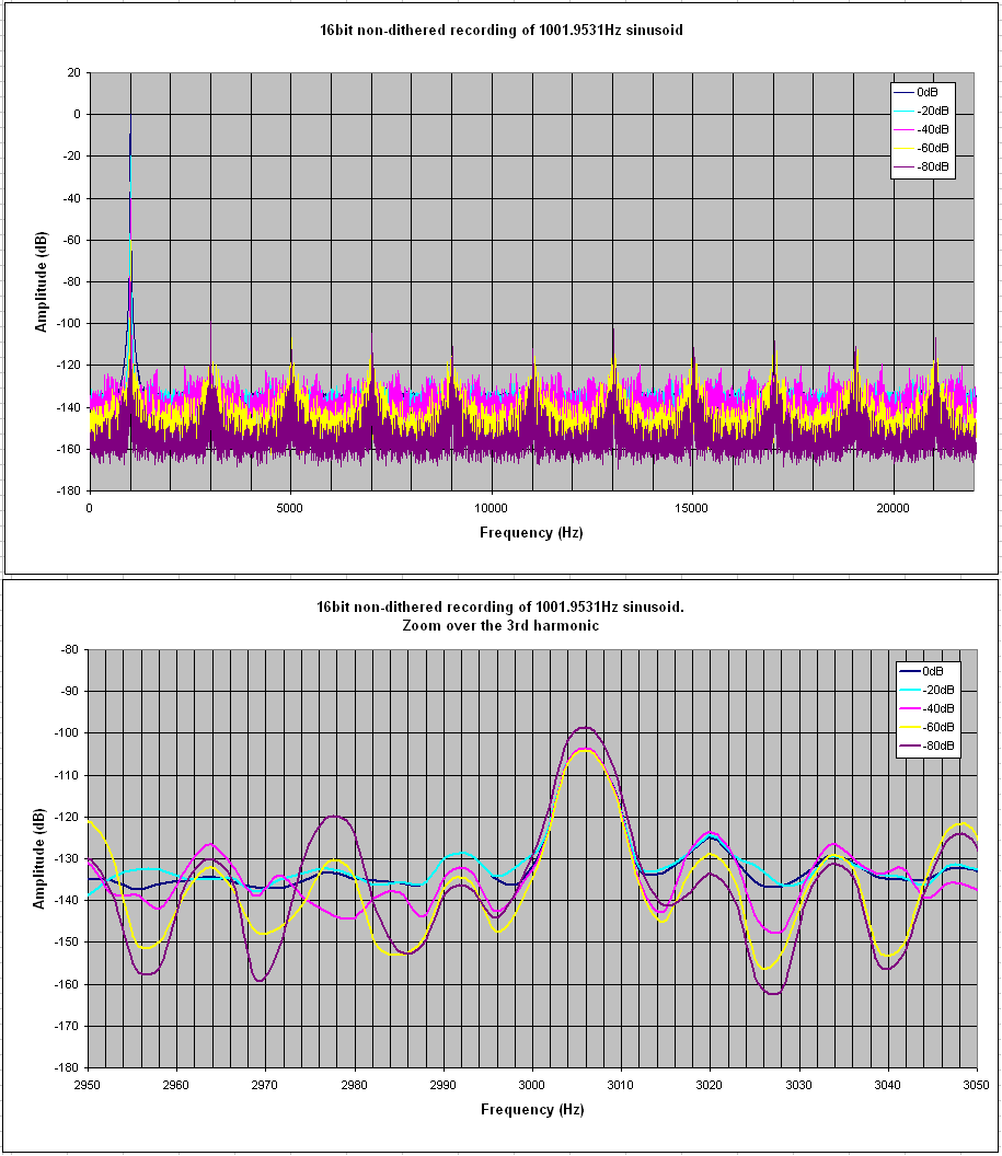

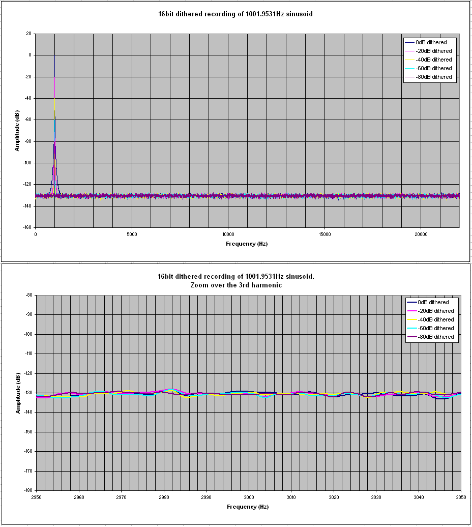

To be clear my comment was in reference to certain early CD's where A/D flaws would have been cured with properly applied dither, certainly not vinyl rips which in most cases are noise dithered.
Attachments are from a synthesized signal in 44.1K/16bit format (worst possible case), generated and recorded in software (best possible case in terms of abysmal low noise floor and non existent added distortion).
Data (8190 freq points) imported into Excel for viewing.
The question is, under real life acoustic recording conditions what a good ear can pick up some x dB beneath the noise floor in a commercial recording ?
The quietest HR recordings I have analyzed sofar, have a noise floor (mics on, silent section before music starts) of –130dB FS @20KHz, -125dB FS @10KHz, -115dB FS@1KHz, -90dB FS @100Hz, and anything btn –90dB FS to –50dB FS @ 20Hz depending on the recording space
And some related literature
http://www.ece.rochester.edu/courses/ECE472/resources/Papers/Lipshitz_1992.pdf
http://drewdaniels.com/dither.pdf
AES E-Library Noise: Methods for Estimating Detectability and Threshold
George

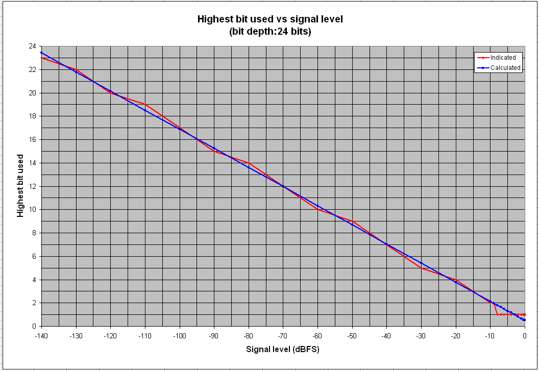

I plotted a histogram of the sample to sample difference on a silent groove and found a minimum of 6 bits of dither at the 24 bit level (why would anyone record original material at 16 bits anymore)? The histogram very closely matched a random Gaussian.
Scott, that's a very good method for checking noise.
Now, 6 bits is the minimum you found.
Can you look how many bits was the mean of the sample to sample difference please?
Noise occupying the 6 lowest bits in a 24bit recording, is approximately –105dBFS noise level, phenomenally low noise for vinyl.
http://www.diyaudio.com/forums/atta...09d1488491256-digitizing-vinyl-level-bits.png
George
