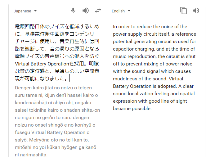

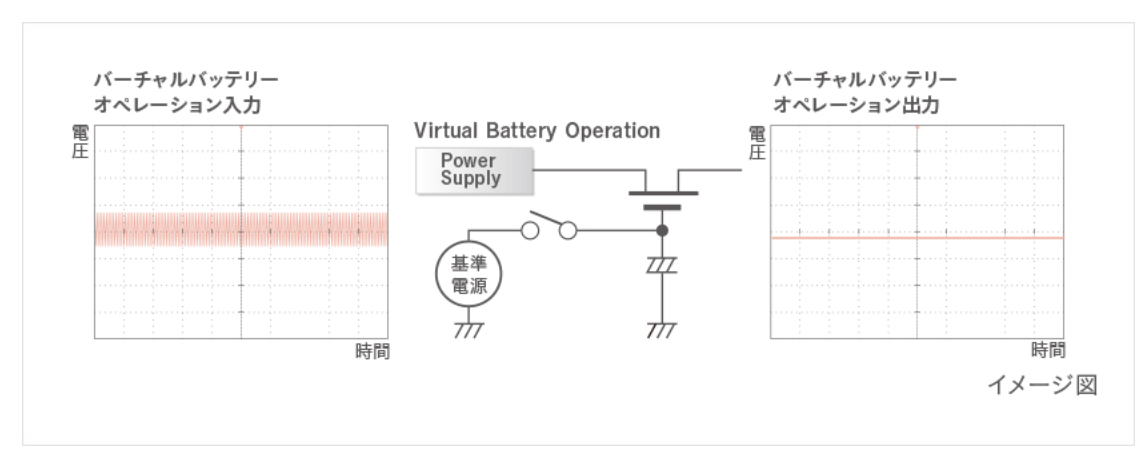

Thank you; I enjoyed searching for Technics Virtual Battery on the web. This page from Technics' website seems to explain it best: link to jp.technics.com
Aaaaaand, whoop de doo, it's a NMOS source follower. Some people call this a capacitance multiplier. Noise and ripple are present on the left hand terminal (the MOSFET "drain"). They are attenuated by a factor of (Zload * gds) where Zload is the impedance of the load (at the right hand terminal of the MOSFET, the "source") and gds is the output conductance of the MOSFET, i.e., the non-flatness of its I-V curve in the pentode region of operation). I've attached an I-V curve from a MOSFET datasheet which shows its characteristic non-flatness in the pentode region.
What they did not say, is that you can cascade several of these for better and better attenuation. In practice, in theory, and even in SPICE simulation.
