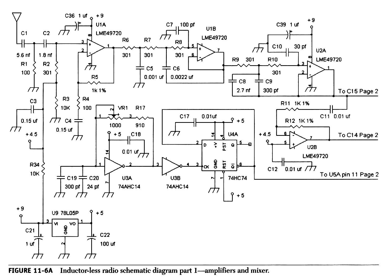

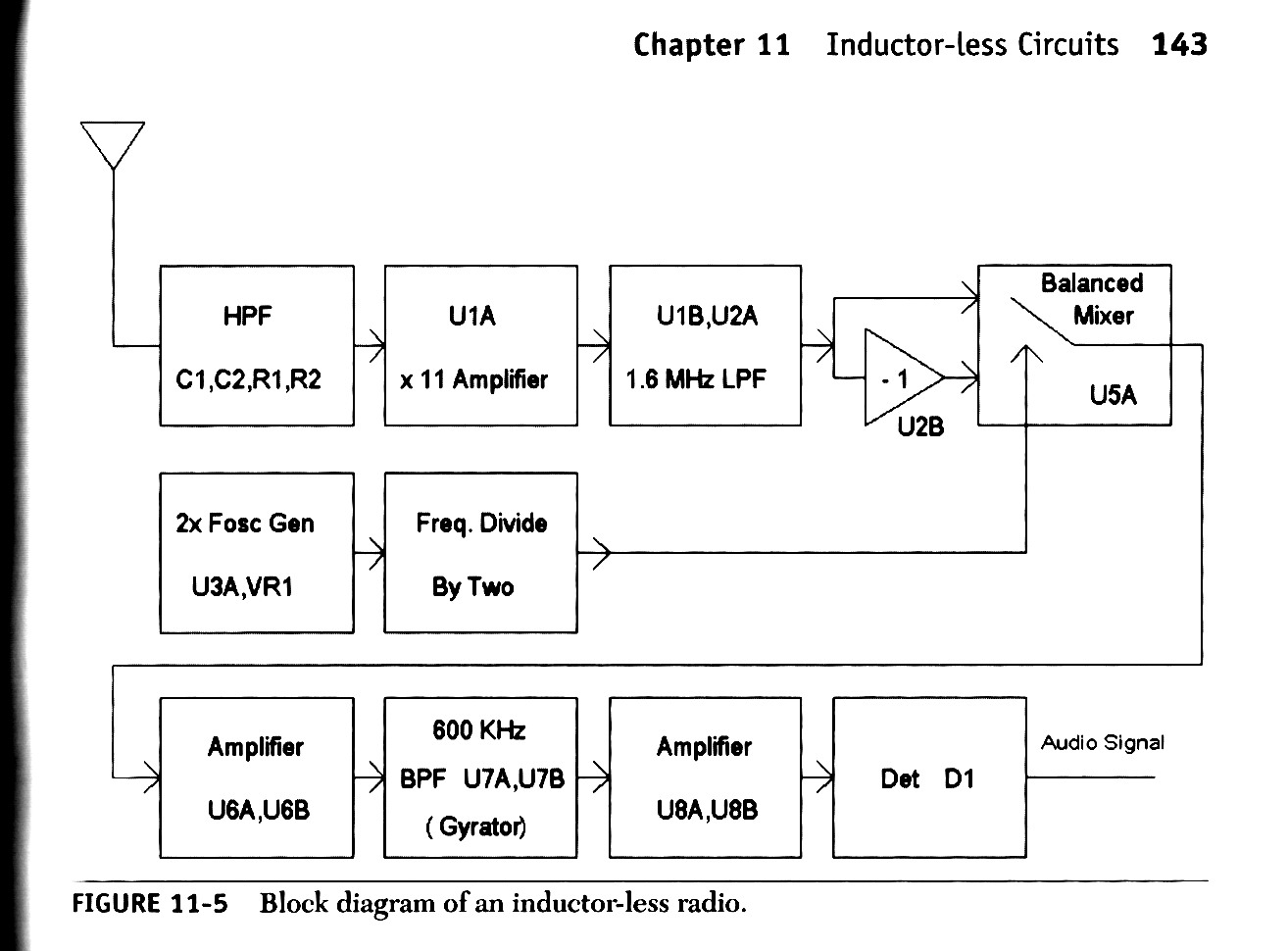

I enjoyed Ron Quan's book "Build Your Own Transistor Radios". He writes about the good old days at Ampex, in the Preface.
edit- couple figures from his book attached below.

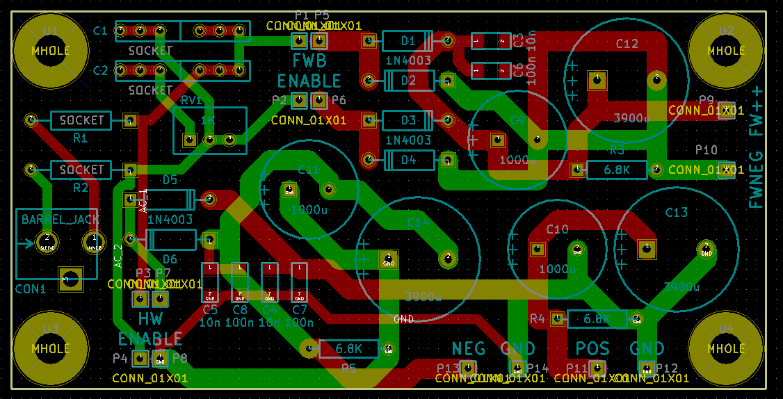

Good deal, John. I just bought this battery powered scope today, to try out some of those ideas myself. Taped out a test vehicle PCB as well; schematic and layout attached. Thank God for OSH Park's cheap and quick prototyping service.

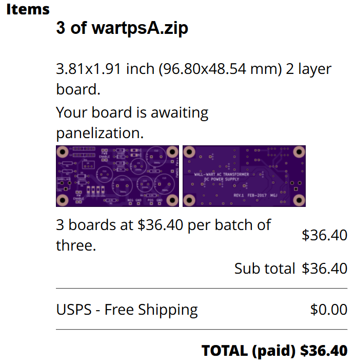

receipt below. Cheap!
