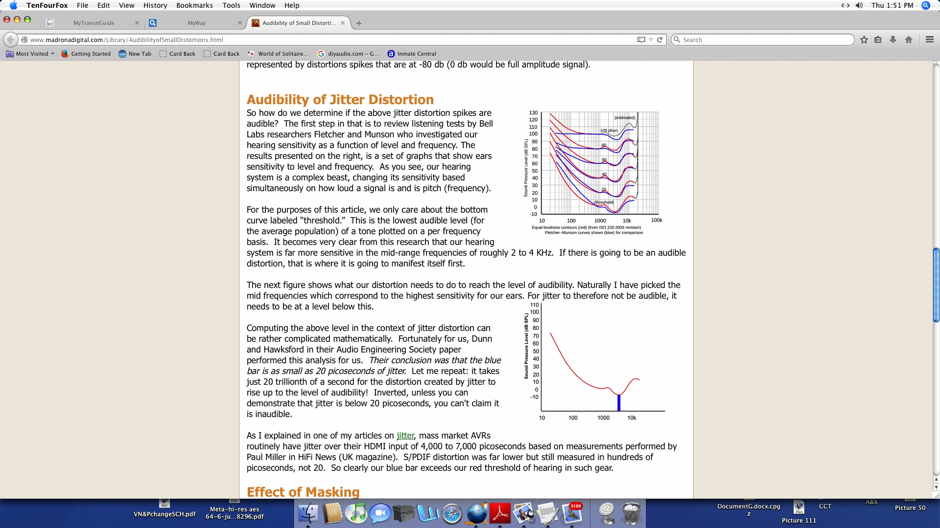

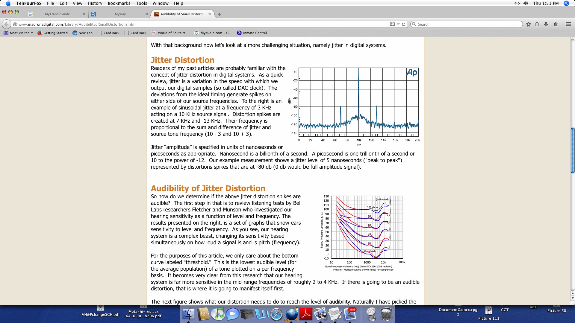

You guys aren't getting my point, the speed of sound in air changes ~89ppm for each .1 degree F so even in a normal room free field listening will have time dependent variation far worse than the pico-seconds in a CD player.
Over simplifying the temperature change effect and isolating it from the real transmission issues still doesn't relate to how jitter can cause bit errors. Low level signals don't use the full number of bits available so errors that are 99 dB below full scale can become much worse.
Bit errors are exceedingly rare on digital audio. And a 1 bit error could be the MSB as much as the LSB. SPDIF doesn't have error checking or correction but all the standards "above" it (CD, Blu-Ray, HDMI, streaming protocols) do have error checking since errors in the audio stream are catastrophic (where pixel issue are subtle flickers when the do happen).
If you have jitter issues high enough to cause data dropouts the digital receiver will be in serious distress trying to follow the clock. SPDIF even at 192KHz over optical shows none of that even though its not supposed to work.
The jitter issues I have seen in DAC's and digital devices usually come from things like hum modulating the supply or ground bounce from the USB packet rate bumping thresholds on clock inputs. Dumb, straightforward, good engineering issues to solve. Not fundamental "standards don't work" issues. I deal with HDMI when I need a dose of that.
