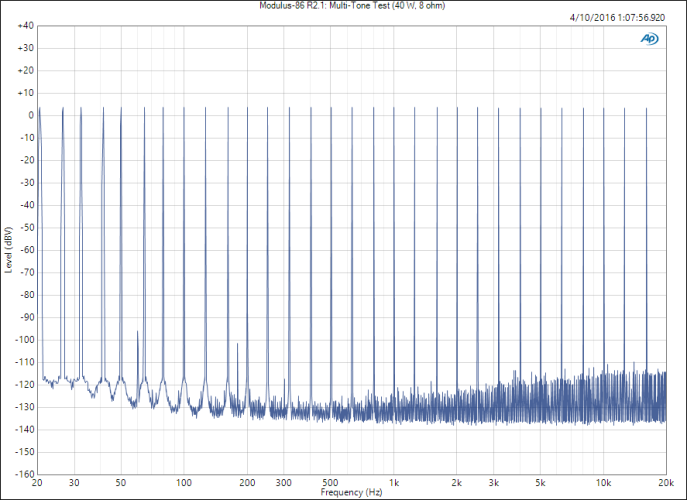

Mainly that a number of designs posted here in recent years reach that level. Members doing stuff for fun to see how low they can get distortion. Attached is the multitone plot for the amplifiers I am (slowly) building to run my active speakers with. I personally think this is a very good test, but isn't used much as needs a very good test set. This waveform is closer to 'real music' than most tests and although steady state gives a good idea of the IMD performance.
Based on this single data point and assuming amp not driven into clipping/current limiting I cannot see anything to suggest this is anything other than transparent to the source. That is of course my personal view as grot 10dB below the best noise floor in my room is (to me) undetectable. I am happy in my clotheardness
