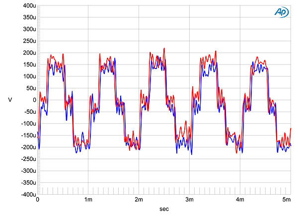

Since it's not a square wave, one more meaningless hand-wave.
I gave up on this, examples using data that can only be artificially generated will never die. Bear, a plus to minus full scale signal in one sample period can not exist in a properly BW limited system so these examples are not relevant to anything.

It is what passes for a squarewave
Here, by Pedja Rogic:
https://www.audialonline.com/articles/high-resolution-audio-asynchronous-usb-oversampling-upsampling-and-stuff/#
It is a square wave reproduced by today's DACs...
SY, the point is that it is NOT a square wave, although that is what it is supposed to be... while the DAC will do a pretty fine sinewave, the issue is IF the obvious "flaw" in the digital reconstruction WRT a squarewave, and the cascading of said "flawed" filters between the record side and the playback side contributes to an increase in error (one that can not be directly assessed without the access to the record AND playback side).
Clearly my old tube amp will do a better job at making good looking 1kHz squarewaves than the multi-thousand dollar (or cheap) DAC will, no??
The latest SOTA amp will do a 20kHz square wave almost flawlessly.
Afaik, a now ancient Spectral amp will do more than a 20kHz square wave...
So, clearly there is a type of distortion inherent in the DAC replay system. One that is based on the mathematics, that to be overcome would require a different approach than the one now used.
But, no doubt, it's not audible, so why worry about it.
PS. those are actual measured results from 2016 of two DACs from Stereophile mag, SQUAREWAVEs, 1kHz.
As I mentioned a bandwidth limited tube amp does a better job, so take the bandwidth argument and run it into the round file.
The issue is somewhat different than merely the "bandwidth".

I always wonder, total incomprehension or dishonesty?
Regarding DAC reconstruction filters, if you make a very sharp brickwall filter (analog or digital) and hit it with a sudden step it's going to ring. Some FIR filters will pre-ring. Nothing mysterious about that. Using sharp filters like that is one way to make a DAC. Another way is to up-convert the sample rate to something much higher than 44.1, then covert to analog at the high sample rate, then use a gradual slope reconstruction filter that doesn't ring like a sharp filter does. Take your choice.

But the fully dithered reconstruction still shows significant overshoot on leading and trailing edged and ringing... more than anyone here would likely accept in an opamp or power amp... fwiw.
Total incomprehension or dishonesty?

Bear, look closely: This is from a Stereophile review of a Parasound CD player, it is a sine wave.
Sorry, un-dithered sine wave.
