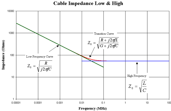

Belden's comments.
Understanding Skin Effect and Frequency
It appears skin effect begins at about 8Khz (red).

This is the second time you have displayed that graph, first in a link to a writeup, now naked.
Do we again repeat the list of errors within that author's textual description of the effect?
Oh, and btw. You do realize that graph has absolutely nothing to do with skin effect, right? It is describing the long line impedance change as a result of the conductor resistance. Not anything to do with skin effect at all. Skin effect would show up on that graph as the frequency goes up, as the inherent 15 nH per foot of the core conductor will go to zero, and the effective core resistance would climb. Since neither were mentioned nor graphed, the author of that graph considered neither.
It would be great if everybody refrained from using that graph for something it does not apply to. Skinning is complex enough without tossing up inherently bad information to confuse everybody.

OK.... I am dragging out my Network/Z analyzers and will test a variety of cables myself and see. I have to find my high Z probe and CT, too.
I dont doubt your physics on the subject. I need electrical models, though.

No problemo. Of course, a true analytical model is beyond simple explanation.
