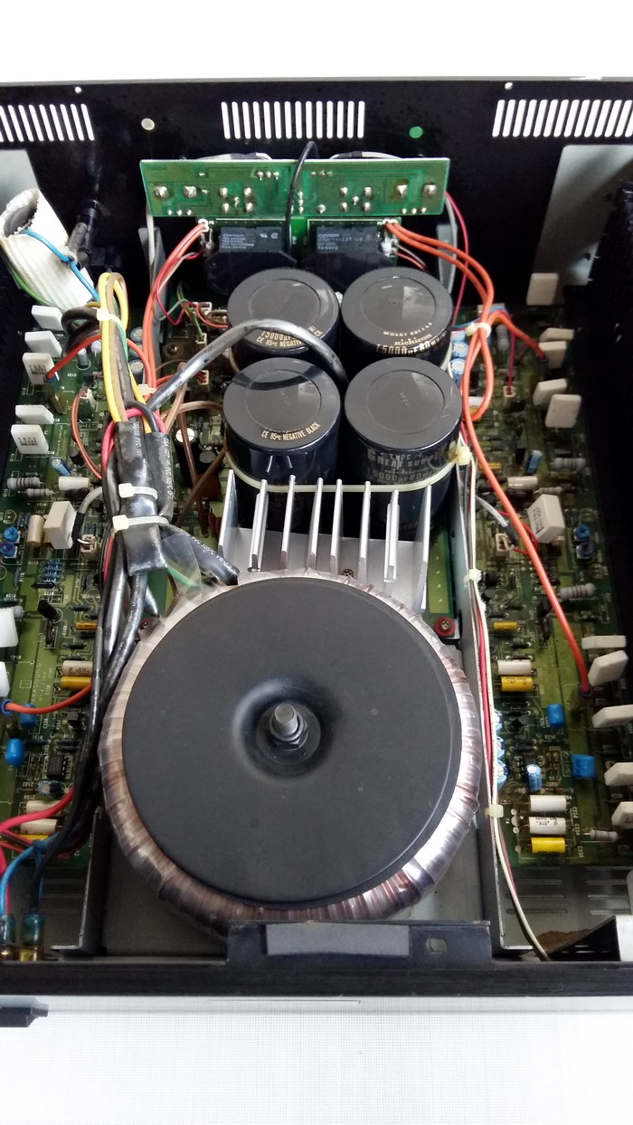

The HCA1200 is one of my power amps and I am fairly sure that I could supply a schematic. It has the right topology, representative of just about everything I make today.

Here is the HCA 1200 schematic. It is one of my first designs of the type that I use today.
Just curious- it looks like you have two bias trimmers in series? Is that the case or is it my old eyes not seeing a connection on the schematic? If so, what's the trick?
The Taiwanese engineers added the extra pot. I am not sure why. Maybe they had more 1Kpots and fewer 2Kpots. They added extra caps in the power supply as well, etc, etc. I just ignored these changes until they started messing up the design (like in the HCA-3500) where I realized that I had to ride herd one them closer to keep the design subjectively OK.

I'll PM you. So the question is are there things that could be done to this amp that would improve it? I ask because I have two of these amps. the one I blew in bridged mode, and another that works just fine.
Scott, all I can tell you is I messed up on a xo I was working on for a three way system and the impedance at some point must have dropped very low or the capacitance was such that the amp went into an oscillation and before I could literally turn the amp off it was over, just dead. No magic smoke that I remember, just dead.

i'm curious to know if there might be any changes in how the compensation is done that might make improvements.

This is a B level amp, and is 23 years old. There have been at least 4 separate model changes since then. Still, it was a good 'workhorse' for the time.
According to the pic, the two trimpots are not identical....likely setup as course and fine bias adjustments.Just curious- it looks like you have two bias trimmers in series? Is that the case or is it my old eyes not seeing a connection on the schematic? If so, what's the trick?
Bias adjustment on many amps is really touchy......I have thought of this course/fine arrangement in the past, now I see it.

The two pots are probably the same. So what? They added the second pot for some reason, but I don't know why. Perhaps they wanted to keep the symmetry of the design. Perhaps they had a special method of setting the pot. Or perhaps they wanted to double the resolution, compared to a single 2K pot. In any case, it is irrelevant to the operation of the amp. There are many other improvements possible, what are they?
