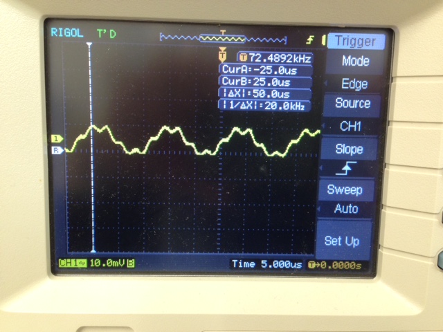

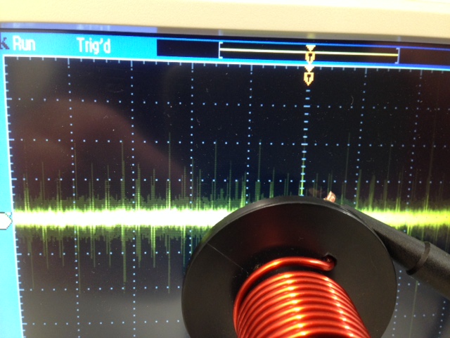

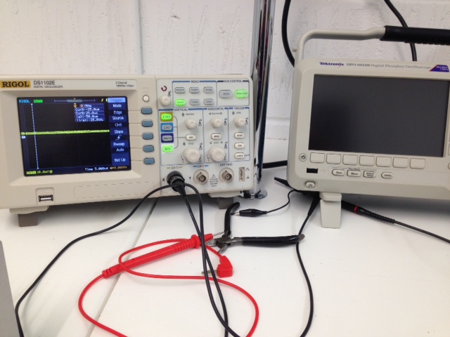

ok - here goes.
I'm using the same duplex mains outlet for both the Tek and the Rigol.
Rigol shows about 10-20mV pk to pk at ~70 kHz no matter where I locate its probe.
The Tek can show up to 1V pk to pk when I locate the probe near the PSU on the rear, and about 100mV with the probe on the bench, about 1" from the scope.
Turn the Tek off - silence - problem has gone away.
Pic 1 - Rigol and Tek are on and noise is displayed
Pic 2 - Tek is turned off - no noise on Rigol
Pic 3 - Rigol probe placed under the Tek

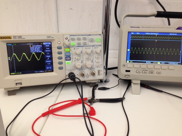

Pic 4 - SMPSU hash picked up by coil placed close to Tek LCD screen

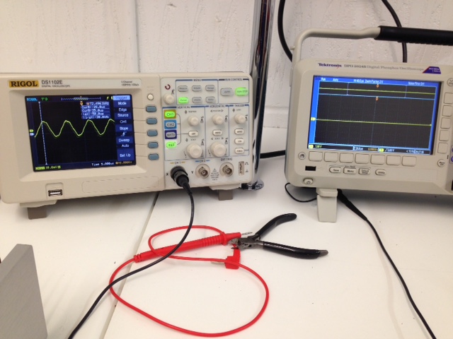

Pic 5 - noise from Tek measured by Rigol with 10k resistor across probe. Probe located under Tek about 1" from case

SMPSU switching hash picked up by Tek -coil placed close to LCD.JPG112.4 KB · Views: 203
10k resistor across Rigol probe placed close to Tek.JPG108.6 KB · Views: 200
Do you get any radiation from the Rigol? If its the main switcher there may be an internal problem? Someone left part of the ferrite off the main transformer?

No radiation from the Rigol - zip. I did open it up just to take a look about 6 months ago. The whole PSU section is enclosed in a metal frame. From what I can see through the slots in the housing, the Tek PSU is not encased.
I will email Tek tomorrow to see what the story is.
Id rather get my money back and try to get a good 2nd hand analog scope. This Tek BTW was a replacement after the storage company trashed my Philips analog scope.

Turns out, the LCD screen, or the Artesyn power supply that sits behind it (I can see the name through the ventilation slots) is pumping this dirt out. I wound a few turns of wire into a coil and connected it to the rigol. Its definitely coming from the Tektronix.

Yes, we have a bunch of shoebox sized Tek TDS2114 and 3114 scopes that nobody wants to use, precisely for that reason: the LCD CFL inverter radiates like crazy. That, and the absurdly small sample memory (4k, if memory serves). Not sure what industry segment Tek targeted with these scopes, they are not even upgradeable for a price.
