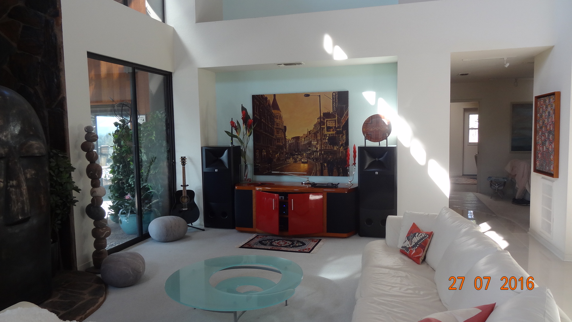

I'm trying to work out where the CFA monsterblocks(tm)* are going to fit in that sideboard. Dunno if its the camera angle or the poor things are squeezed into a alcove ending up with them being closer together than would be optimal for the listening distance?
*Could be the amps are very big or the people making them are quite small 🙂

Amazing speakers.

I'm surprised no sympathetic artifacts from the guitar? Ivor would be horrified.
For people who think they can EQ their room modes away, I guess they could try the same for any guitar modes.
It is stuffed inside.

Ah, you thought of everything. Yes I think I see it now, capoed down pretty good too.
I really like that part of the decor. The swirly coffee table must play nightmares on reflections too. 😀
Ask Richard about his 'rocks' as well. '-)
Sorry that's jacco's department. 🙂 The linear pile of river stones seems rather nondescript, I must be missing something.
EDIT - Sorry I forgot the ocean/river stones with lines are a fascination to some, whatever.

I'd worry a bit about the asymmetries and the reflections from the adjacent window.
Yes. it makes the largest detectable difference. Other things can be easily picked up and moved/removed. The more narrow dispersion angle of the M2 helps as well. I have two large acoustic absorbing panels.... one to place by the glass wall on the left and another on the wall to the right of the listening place. The room has a sloping 18' x 13' ceiling..... room is architecturally/acoustically broken up and is wide and long enough (30') to support some decent bass notes. There is significant sound absortion materilas in hidden spaces (behind pictues and over head lighting etc).
The drivers used are very special.... extremely low distortion. But compared to the Quads, exhibit no sense of compression of the dynamic range.
The best system I heard and put together was about 30 years ago. I had two refrigerator size rear loaded transmission line cabinets housing 18 inch Hartly drivers. Those were laid on thier side and on top of them sat a pair of QUAD ESL speakers. On top of the QUADs were a row of RTR ESL tweeters. All tri-amp'ed with cross-over at 300Hz and 8KHz. Electronic cross-over i made myself had variable freq and variable slope adjustment. The RTR drivers were powered from a Dyna tube amp and the signal was cap coupled direct off the tube plates (OP transformer was not used... terminated). A seperate HV supply was used for the RTR.
Extremely low distortion and very clear/transparent. From deep, deep bass to ultra-high. But I kept clipping/arc-over the QUAD midrange at 'reasonable' listening levels. I used for source material, the recordings from live recorded using R to R tapes via Revox 30ips 1/2 track recorder.
This M2 is as good or better and has unlimited dynamic range (for me).

The 'rocks' are made of 100% animal hair/wool. Imported from Africa
Well, here they are in the listening room. My latest toy for critical listening.
They will help a lot in further detecting changes. They are fairly Big boxes, though.
They need to be toed-in a little bit and I do have an absorbent panel to use on the left side to further reduce reflection and improve imaging.... but the +/- 30 degrees (60) helps a lot here.
Amazing speakers.

Unsolicited comment, department of...
Please don't take this as some sort of personal criticism, it's just my instant gut reaction based on your picture.
Bad room for dedicated listening, imo.
Speakers are too close together.
The offset to the left is problematic.
Listening position might best be with the person sitting where the glass table is.
If the listening position is where the picture is taken from, then the person listening needs to be somewhat offset to the left, which in and of itself creates imaging problems due to the difference in distance between the left wall and right wall and the different reflective surfaces.
The glass table will reflect highs.
Maybe sitting in front or at the glass table, with the speakers toed in aimed
in front of the listener (pretty much) you'd get a pretty good presentation... maybe.
Otoh, IF it sounds great, who cares!

The real paranoid would ask himself if there's someone with a West End apartment (Shaftesbury Avenue), who has a painting of your Bangkok street on his wall.
