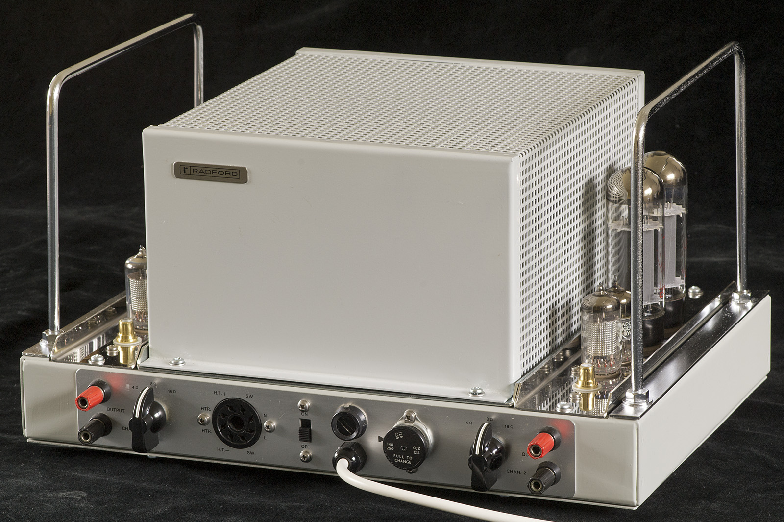

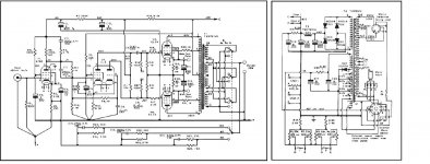

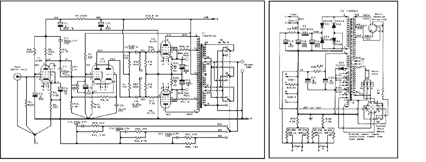

Radford STA-25 mk3
Wow - that's old school. I remember reading a review (already a few years old at that time) in about 1970 while still at school . . .
Yeah bought it as a student in the 80s with a blown transformer. Was my first upgrade from the ubiquitous NAD3020. 26dB GNFB, which is a lot for a tube amp of the era, unless I missed some other designs (entirely possible)
