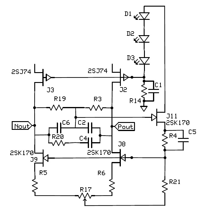

At the risk of the usual brickbats I wanted to show the simple diff-out idea. I've basically started with Bob Cordell's LA article and heavily Muntzed it adding diff-out and doing it with just JFET's. I've partially stuffed the boards and it looks good so far. The one FET sets the output common mode and keeps the differential-ness as good as the component match i.e. it does virtually no work. The distortion is admirable even at 10V p-p out into 2k using simple complementary source followers.
It was easier than I thought to go through only 20 each SK170's and SJ74's and match up enough for each position in two channels. The criterion I used was source resistor for exactly the desired operating current weather or not there was a source resistor. The source followers were picked so the N and P used the same standard value resistor for 5mA Id. This worked out great no trims, no offset, and very low distortion. No Vp or Idss matching at all. It remains a project to see how close this gets to the distortion null with a trim.
Note: this circuit is Muntzed no extra cascodes and resistors where some might want current sources. Also the DIFFERENTIAL PSRR is what matters and it is actually pretty good even though the common mode PSRR is 0 (RTO). SIM says 110dB RTI even at 20K (that won't be, but haven't measured it).
I've spent all of $60 for two boards and a set of surplus 1-2% TRW PS caps to put this onto my $179 U-Turn turntable as an exercise in minimalism.
