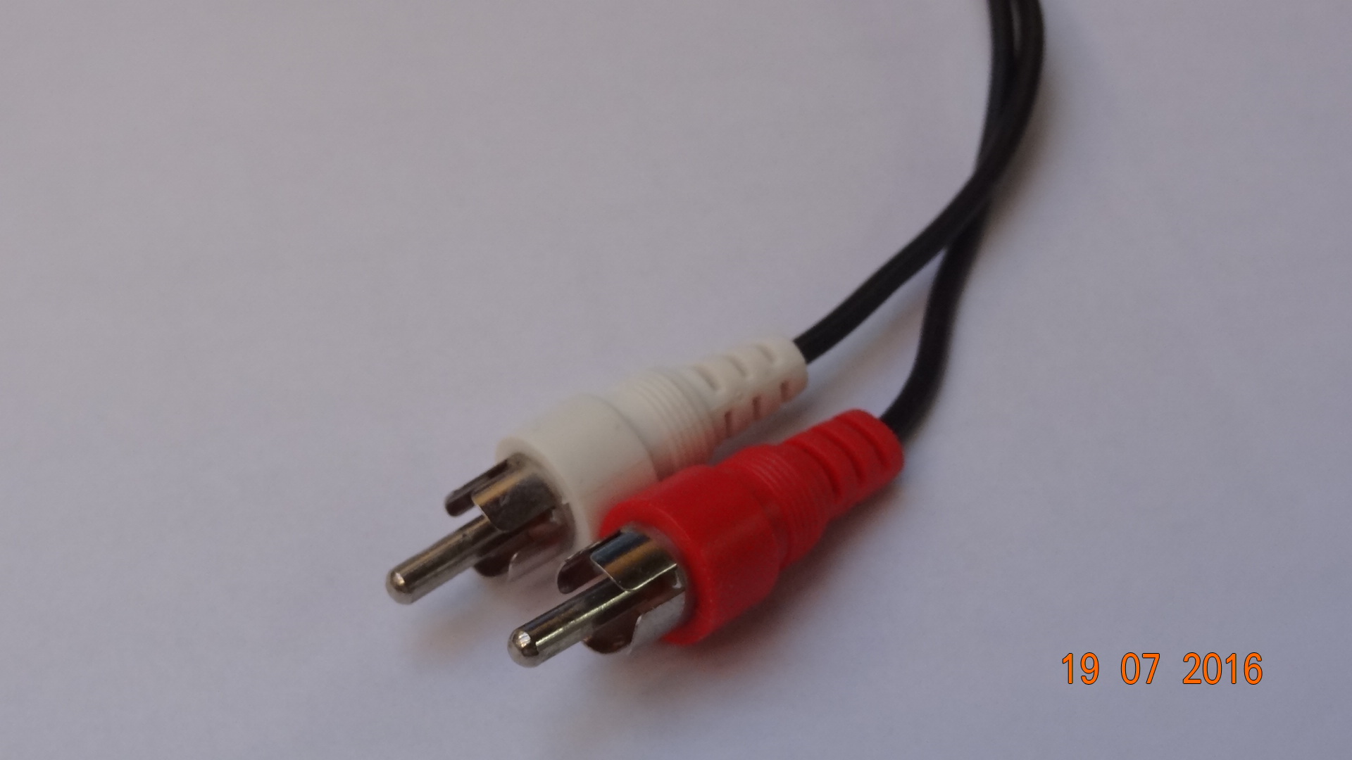

No. Audio connections are not Normally formed with significant mechanical force. Neither RCA nor XLR contact have high clamping force, Normally.
Normal RCA connector.JPG Normal RCA.
Maybe yours or my audio connector is air tight contact etc. But that is not the normal RCA most people use. To say they Are air tight connections, normally, is to imply there is no contact issue with Normal RCA contact/connection.
I have some RCA (gold) that are so tight they are very hard to remove. Some audiophile RCA have collars which tighten down and provide an air- tight contact.
But, Normal? No.

Okay. If you're comparing to that then cables really do make a different.
Yes Dick you're so right, that article you posted referred to metal on metal contacts with NO mechanical force at all. As I said, you didn't read it. Have it your way but please post some actual data or measurements that show something for folks to worry about in ordinary audio applications. Most RCA equipment I have takes a good push to seat the connector my idea of significant mechanical force YMMV.

The fundamental problem with the RCA interface is the difficulty in ascertaining if the force required for insertion is applied to the center pin or the shell, or both. The absence of a real standard for the dimensions is part of the problem.
Recall that these were intended for few-cycle internal connections within things like TV sets.
One of the reasons I might purchase "audiophile" interconnects is that their connectors are usually of higher quality, including ones that have a slotted pin and shell. In one case I had to repair one on receipt because of a broken solder connection, but so it goes.
I have an old pair of Monster interconnects that are made to go on so tight on the outside barrel you can't get them off without the possibility of damaging the chassis side connector, way to much mechanical force as far as I'm concerned. What is the problem with having to clean RCA connections every few years or so, I have never seen a real problem if they are cleaned to begin with and taken on and off once in awhile.

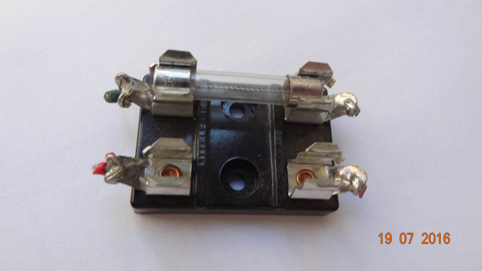

This is the fuse holder type used by Magnapan when I heard the distortion and found it was from this fuse holder/fuse combo. Too bad I didnt have the distortion gear I have today to measure it. I replaced it with a fuse holder which was similar but gold plated clips (I wonder why they made those? 🙂 )
You would think the contact force was good enough. But it wasnt air-tight apparently.
An alternative to replacing the holder is to use gold plated end caps on the fuses. Littlefuse has them and so others do also. 028506.3 - 285 Series - 5x20mm Fuses Cartridge Fuses from Fuses - Littelfuse
