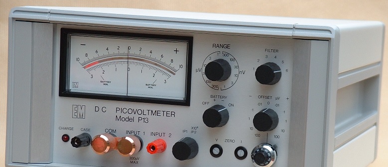

BTW a cuprous oxide diode has about a .2V drop any actual metal to metal path in parallel at modest currents will prevent any diode action. It is reasonable to believe at audio line levels the contact would have to become oxidized to a pathological level to show any effect.
I will also remind you of the EM pico-voltmeter (notice last setting is 1nv full scale) which has solid untreated pure copper input lugs.
