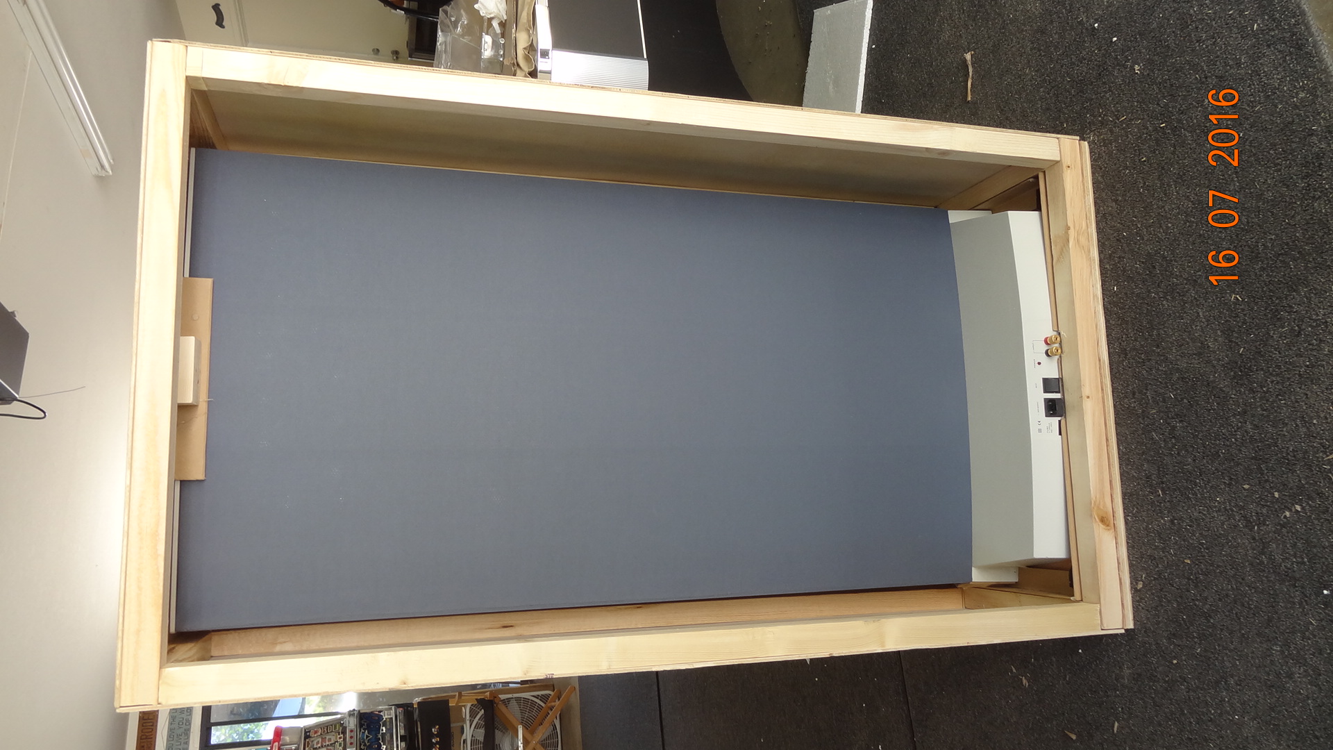

Crating up my ESL989's for shipping to Bangkok place.

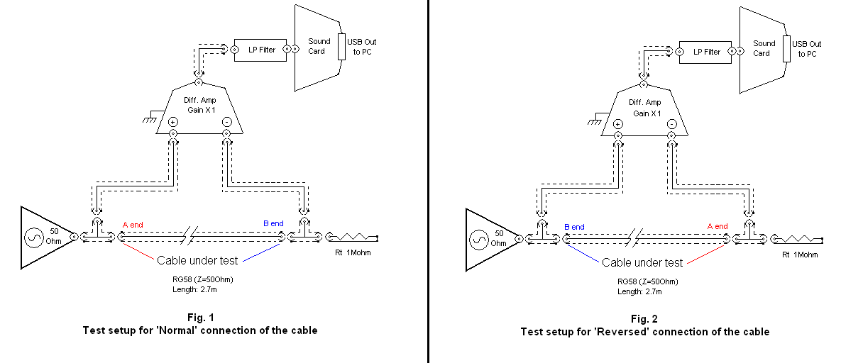

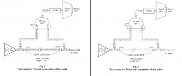

I cleared a bit the mains residues with my measurement setup. Now I can go a bit lower with the driving signal level and still resolve the ‘across the cable’ signal.
I utilized the instrumentation amplifier only at it’s X1 gain setting.
I made wav recordings of the ‘across the cable signal’ with generator driving signal levels of 1.0015Vrms, 99.88mVrms, 11.42mVrms and 3.89mVrms.
For each signal level, there is one folder that contains 6 recordings of 1 minute duration (three ‘Normal’, three ‘Reversed’) plus some level reference recordings.
There is also one folder containing the generator driving signals.
The wav. files are sampled as mono, 44100Hz, 32bit float.
The 0dB of these recordings corresponds to 3.02Vrms
The test tone is 3001.19Hz. This is a center FFT bin frequency for the standard FFTsizes of 16384 (included) and up, where you can use the No Window function.
The files will remain at the dropbox for around a week.
You may download them and make your own analysis on them.
Report back here 🙂
