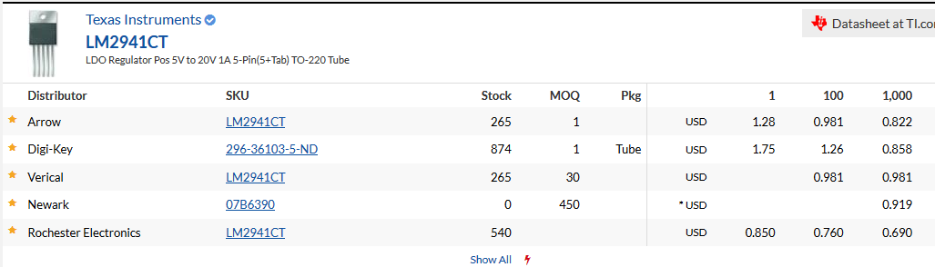

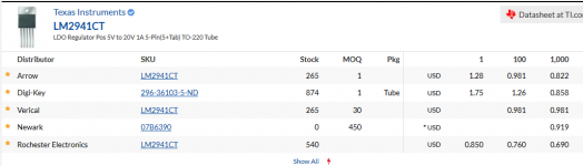

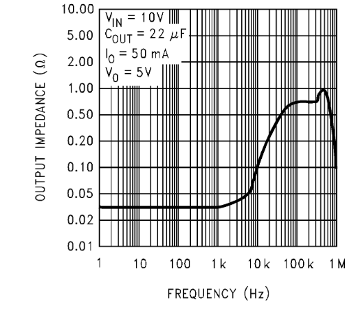

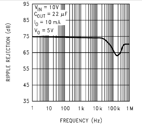

A three part cascade consisting of 2X these little jewels, plus Walt Jung's / John Curl's discrete shunt mode Super Regulator, is probably more than good enough for me. Even when powering a hypothetical moving coil headamp whose amplification circuitry hypothetically has zero PSRR of its own. These are low dropout regulator ICs so they don't squander a significant portion of the output from your expensive Rcore transformer.
Use the typical stunt of completely independent xfrmr secondaries, completely independent rectifiers, completely independent filter caps, and build two identical regulator cards using "positive regulator" chips in each. And don't forget RFI filtering! These 6 ampere SMD feedthrough capacitors may help. Three terminals: input, common, output. Woo!

Thanks for the regulator cite. 75 apparently real PSSR! Even more the surface mount feedthrough capacitors. I also like the shunt bit.
I don't know which will end up having greater legs, my almost forgotten June 2007 AX article "Shunt Regulator: The Almost Forgotten Circuit" which seems to have started the revival in the circuit, or the bit on resistor distortion in Linear Audio V1.
The only part I think most folks missed on shunt regulators is using a resistor from a regulated voltage source has lower noise than using a current source.
