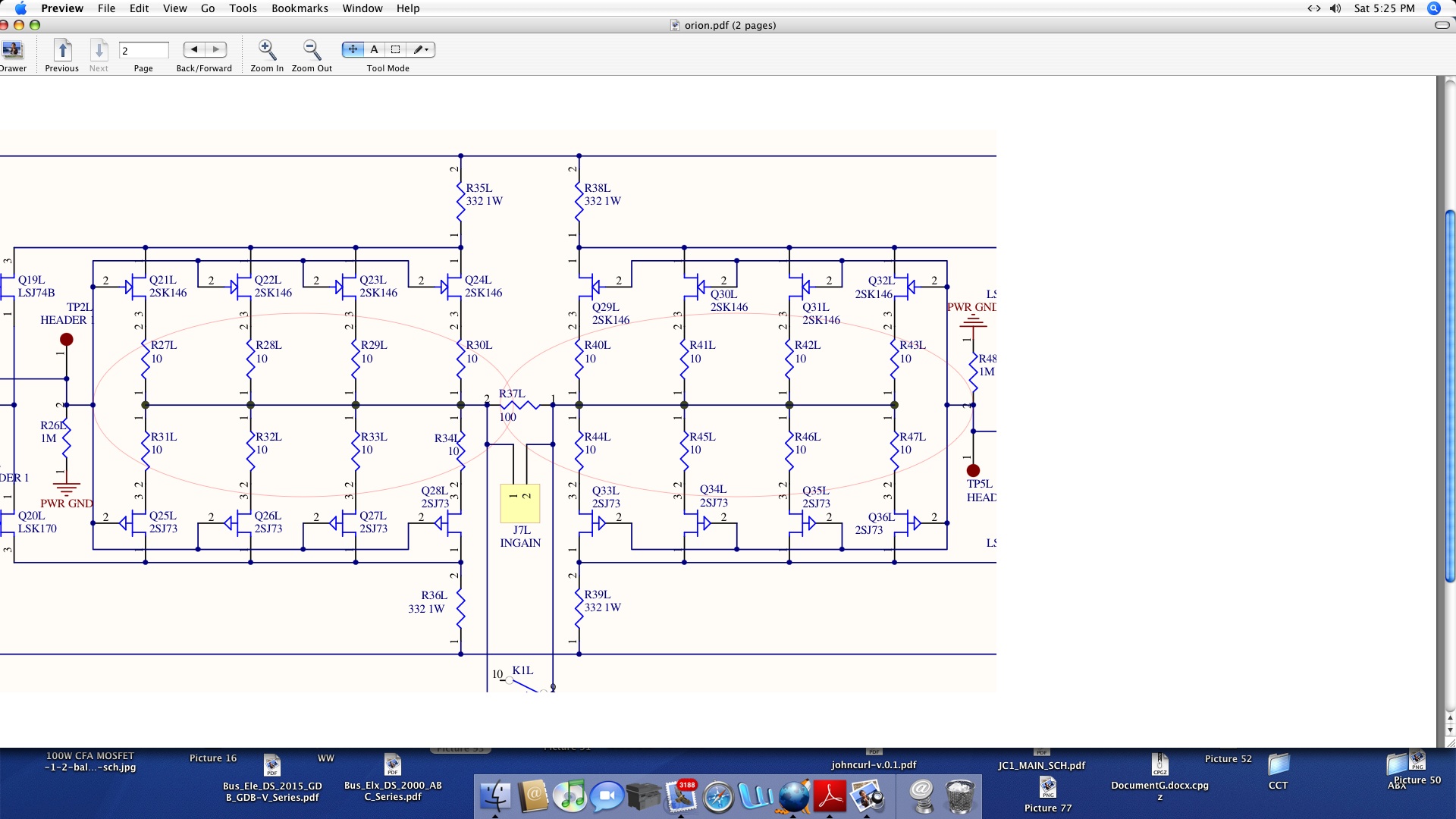

BUT, inside that phono preamp are parts that make your op amps cheap by comparison. Have you priced out the 2SK146-J73 complementary pairs recently? I had to use them in multiple serial parallel to get to the nominal 0.4nV/rt Hz differentially. Many hundreds of dollars, just for the input stage.
Yes, they don't make discrete parts like they used to! We have to scour the world for enough of them. That is one reason the new products are so expensive.
Even if you could do this with the Linear Systems (or any other recent parts) you wouldn't. That's what fashion audio is all about.
Don't you love it, put 10ohm in the source (eating all of the 0.4nV/rtHz noise spec), then parallel devices to lower the noise.
