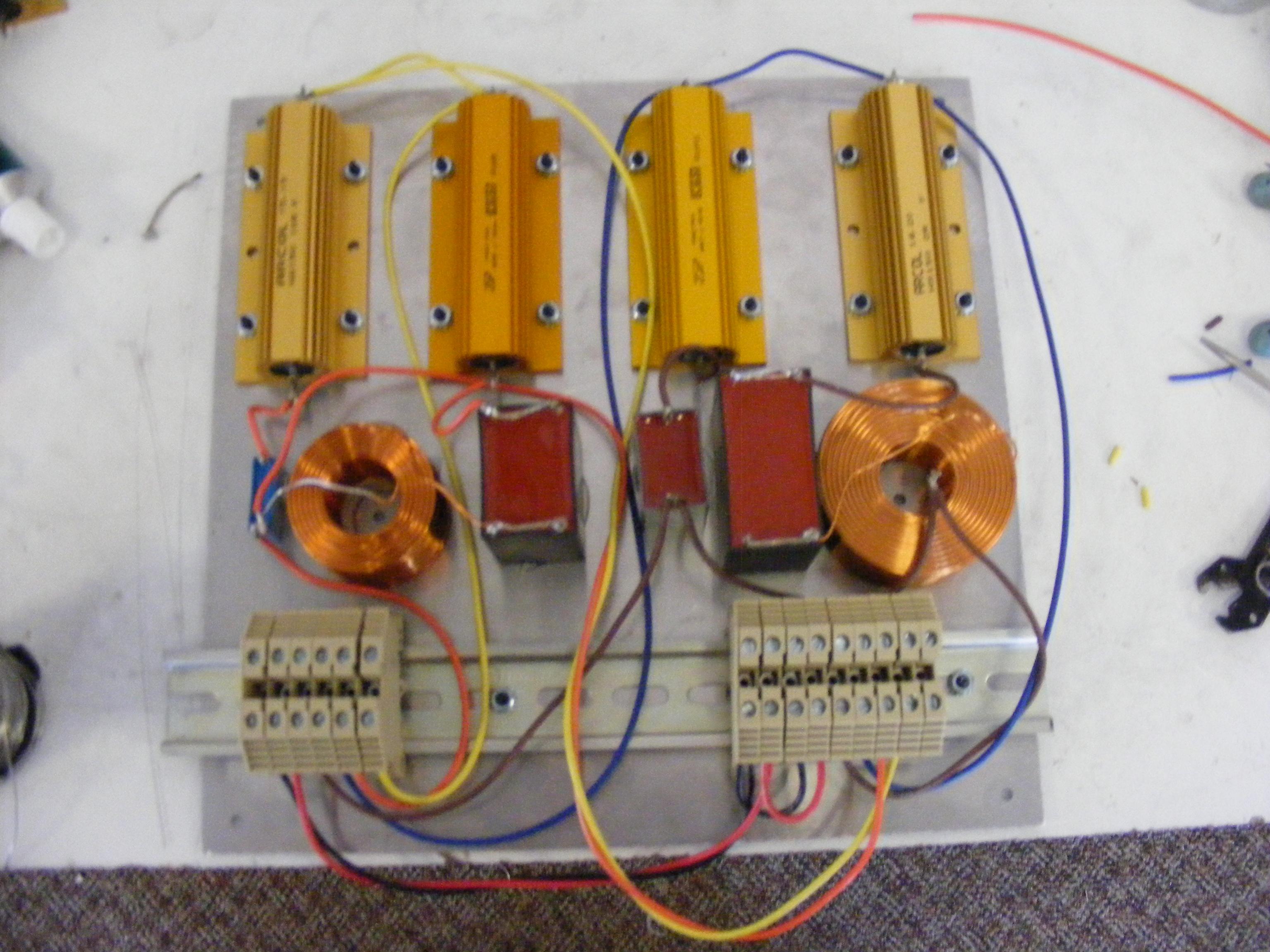

Just for giggles, here is the Zobel network I built for the loudspeaker that I showed the impedance curves for a while back.
Should be testing it later for impedance and before and after acoustic output frequency response.

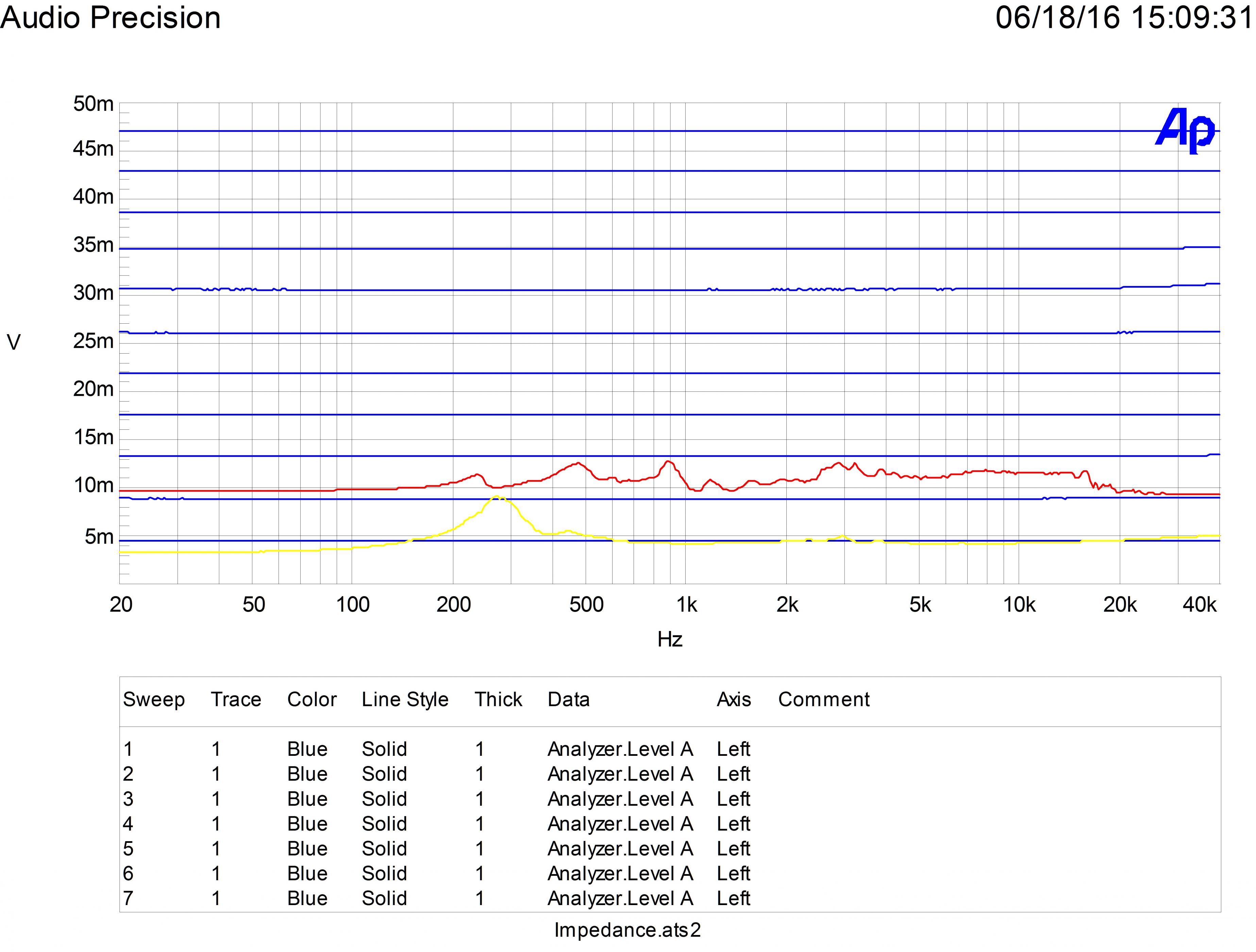

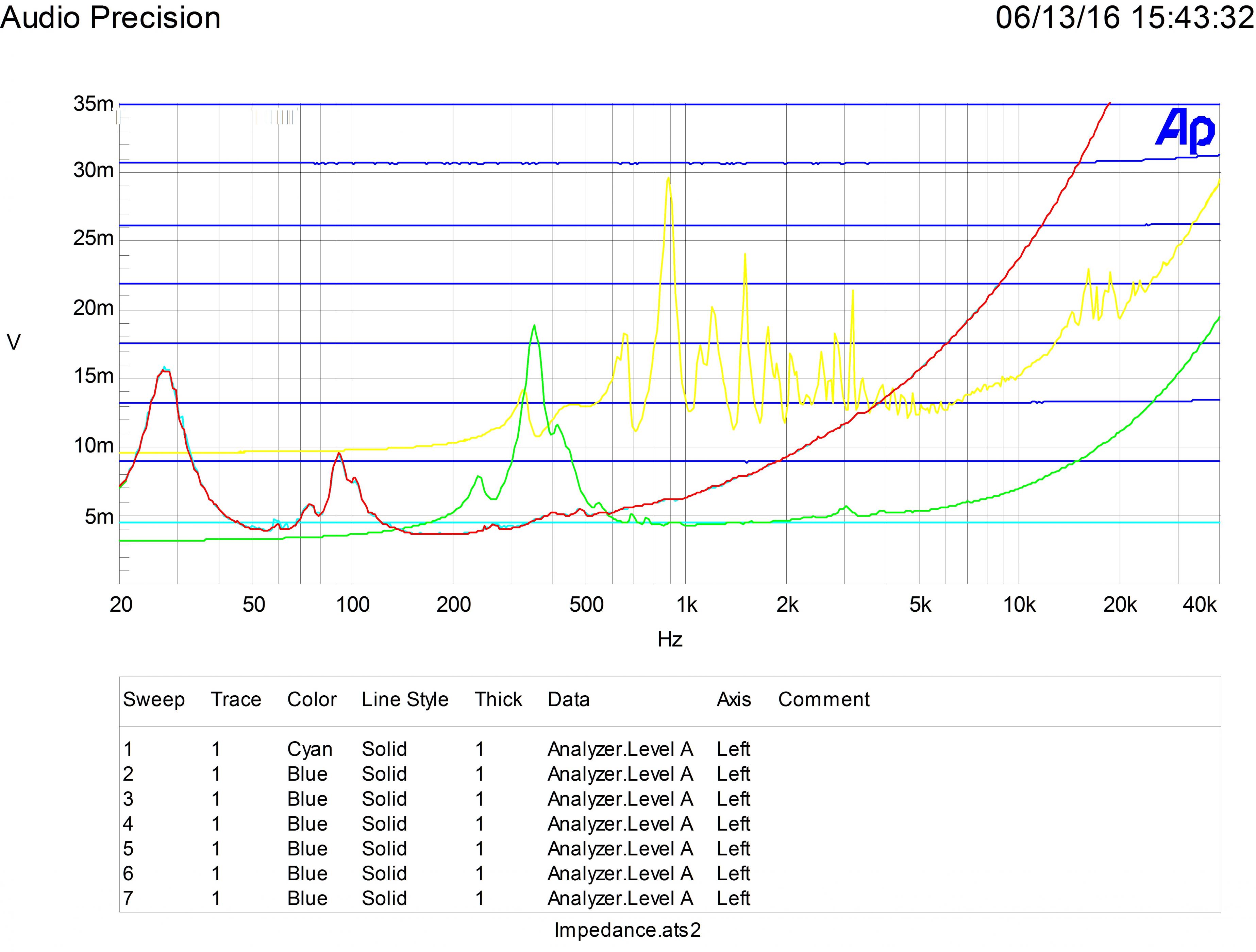

Here are the before and after impedance plots with the Zobel. Yellow is mid after and red is highs after no Zobel on the lows as it is almost close enough and the part's size is prohibitive.
Sorry forgot to match scales. Also looks like a small capacitor tweak is needed for the mids.
