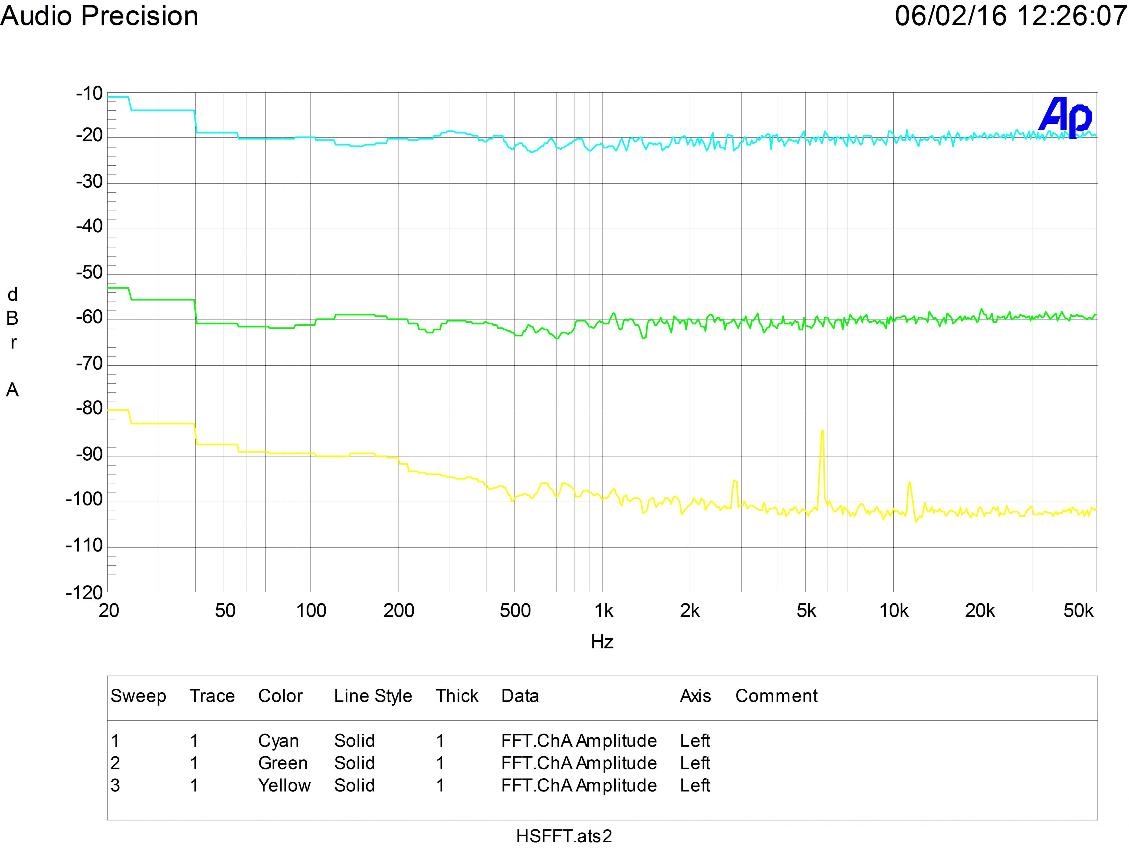

I also ran a simple test using noise on my FFT. When the noise drops in level to fewer bits it does indeed show the high frequency loss. Image attached.

That just looks like you are uncovering 1/f noise of something in your chain. Maybe Bill can refer you to some appropriate reading material on dither and arithmetic gain adjustment, the basic premise here is nonsense. Dithering has nothing at all to do with modulation and creating harmonics it's an additive process.

As usual... The claim was the low frequency energy which does exceed 10 LSB would dither the HF. It does but not the same as a proper dither signal.
The issue is not gain adjustment. The test is above the noise floor. Shorted input shows that. You can try it yourself, just be sure ranging is fixed.

Did you write down how much you were attenuating the noise for each step? It does look to me like a relative boost in LF noise rather than a loss in HF.

The readings were a bit more than 30 dB above the noise floor. I think the 1/F noise shows on all three traces. It is the HF that only rolls off at low levels. I had that problem on a set of measurements and it took me a while to find the issue. You are welcome to try it yourself.
