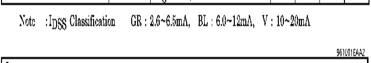

Would someone please go over the grades of 2sk170 ?
GR ... BL .... ?????
edit: or a link ? I've seen it before ,
can't find it now ....
2SK170 pdf, 2SK170 description, 2SK170 datasheets, 2SK170 view ::: ALLDATASHEET :::Would someone please go over the grades of 2sk170 ?
A -1/4 power effect on noise (see Wurcer on this here and there). So higher Idss is better but not by much.Thanks ! ..... Ramifications of idss ?

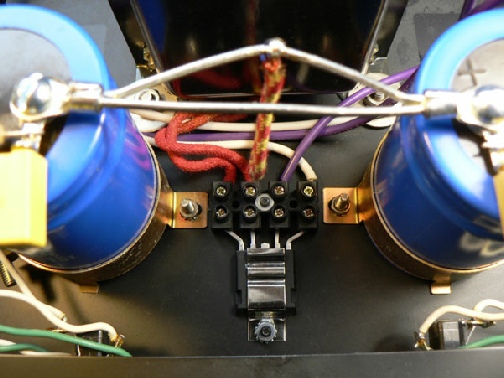

(Below) , they are modding an Adcom 565 with a "fancy bridge".
They hammer on about " AN INEXPENSIVE AND THRILLING IMPROVEMENT " ,
I have a vishay fast recovery test PS. My main amps , with any of the 6
classic input stages ... sound exactly the same with either the Vishay's
or a standard "poorman's" 25A bridge..
I ran a 45HZ signal to a sub , the "poormans" bridge (unsnubbered) exhibited
ringing ... but after the cap bank - nothing.
Even with this crappy setup , all sounded the same.

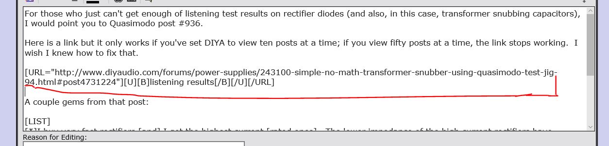

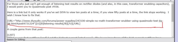

I would point you to Quasimodo post #936.
Here is a link but it only works if you've set DIYA to view ten posts at a time; if you view fifty posts at a time, the link stops working. I wish I knew how to fix that.
Try taking the page number out of any links you create as they are settings specific. For yours it is the '-94'. If I create a link for that post I see '-47' because I have 20 posts per page.
So take that info out of any links.
That's Id, i.e. gm goes as sqrt(Id) and noise goes as the sqrt(1/gm). If you pick a quiescent current for a particular device in the circuit it might be useful to have it be a certain amount less than Idss so Vgs does not go positive (N channel) under any dynamic conditions. This would be a reason to specify a higher Idss range. If you are going to run a 2SK170 at 1mA, there would be little reason to worry what range you pick.
I would take the pos and neg wires from the terminal block, twist them around the two commons from the transformer from the plane of the terminal block all the way up to the splice, then twist each around the common to the terminal of the cap the white connects to, then onward to the terminal being connected to. That way, the uncommitted loop is the smallest it physically can be, just across the cap between the terminals. As is, you have a pair of broadcast loops.
John
John
Didn't seem to prevent a "thrilling improvement".
