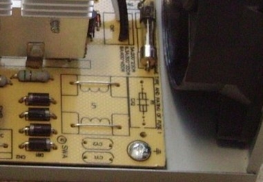

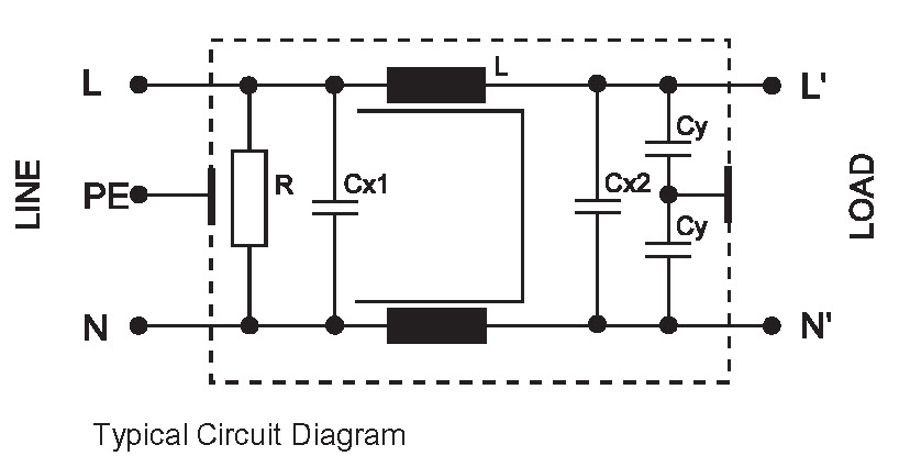

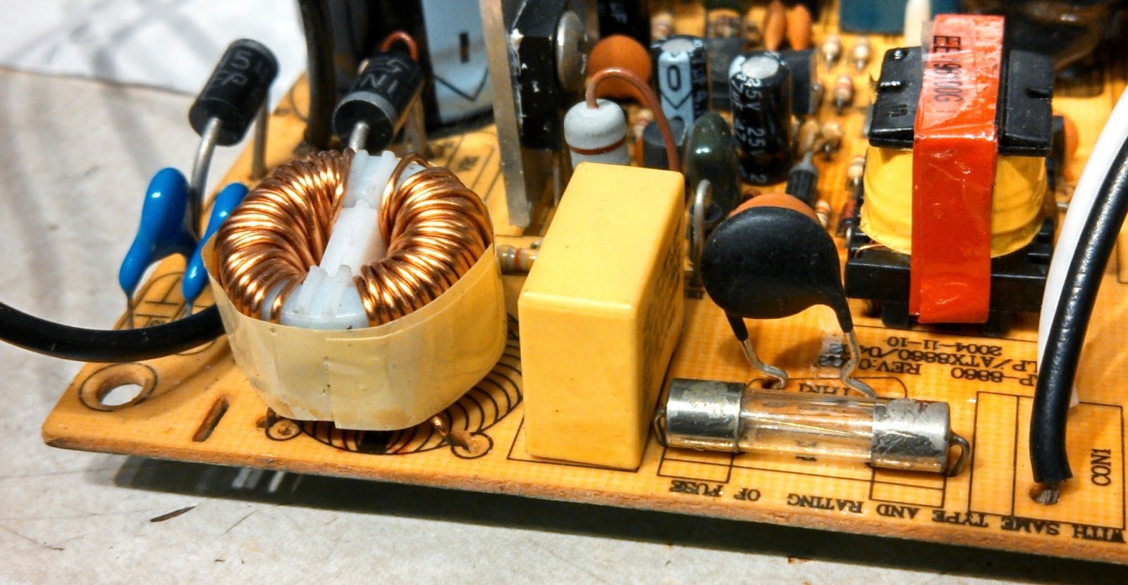

We had this discussion in the solid state thread. The member was trying to filter
up to 100Mhz on his DC , with a great increase in the complexity of his PS.
This DC was powering a symmetric amp with known >1Mhz bandwidth.
I said this limited bandwidth ... plus the audio input R/C , would naturally negate
anything above 1mhz.

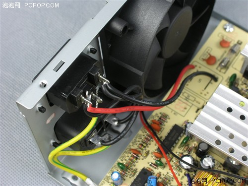

Still , I don't want to see it. It is cheap to use old PC filter common mode parts.
(below 1/2)
Just to show it - (below 3/4) , are the major culprits (cheap Asian knockoff supplies).
Believe it or not , those were UL listed and in OEM PC's. You think an
unfiltered CFL is bad ..... plug in one of those 300W units.
My Corsair 600W unit has 2 C/L/C's in series. You get what you pay for.
