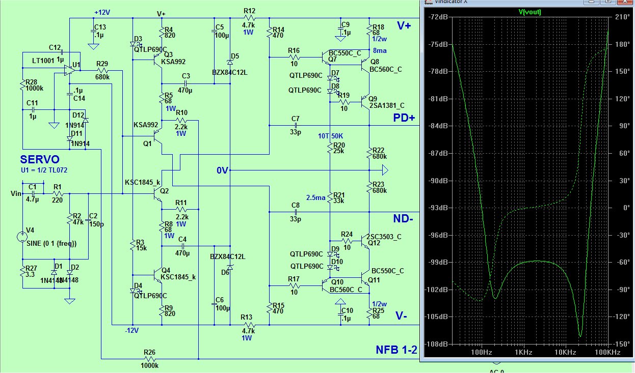

50-60db "over the top" ??
Maybe if the amp is used as a glorified virtual ground and does not
need to be low distortion at higher levels.
That does sort of negate any sort of "audiophile" CFA's , huh ?
I "crippled" my newest CFA to <60db. 60hz THD rose X10 (50-100ppm) .
Allowing it's standard -100db .... I was back down to 5 .
IMD takes a "hit" at low rejection , as well.
Is there any audible advantage to a low PSRR circuit that increases in
distortion because of this ?
I always try for that 100db , not really hard to mix CFA and VFA "tricks".
Accuphase does as well ... (my new one- below) is similar but simpler.
OS
OS
I suspect you affected a lot more than just PSRR if the distortion increased.
Nothing wrong with over-the-top nor 100dB psrr, --- just dont need that much psrr for inaudible ripple and noise coming thru from the PS.
THx-RNMarsh
