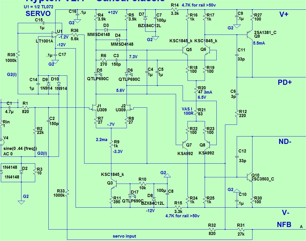

Seems like from some conversations I've read that current surface mount dual devices take care of a lot of the matching requirements
I've split the dual matched pairs into two groups -
-Low Vce , low cob , high gain - Panasonic DMA20403/20402
are touted at <2% Hfe . Other choice is BC807/817DS
-high Vce , low cob , medium gain.
....good old FMBM5551/5401. (@5% match)
I learned SSOT-6/SOT-23-6/SC-74 are the same pinouts/3mm footprint.
SMD dual packages are a full 3 different pinouts depending on package,
voltage , and OEM. Bases on pin 2/5 for low Vce and 1/3 for high Vce.
These are the bigger packages that might still be DIY friendly.
Even as JC would make fun of me for SMD'ing a standard "leach amp"
for my first foray into the SMD world , it's "daddy" (spooky)is my main amp now.
SMD should allow me to reduce it's area (and noise) much further.
I am also going to study the ground planing aspects of it's input stage
design.
Now , the trick is to refine this new SMD dual device tech to "play"
well with both CFA (P/N matches) and single ended topologies.
It should , since P/N mismatch is the bane for CFA and same gender
mismatch is the single ended issue.
The new fabs seem to (make better devices)than the present through-hole fabs
for 992/1845 and BC550/560 devices.
I only need one Jfet pair in SMD (can't find it) for my K-V2.1 (below).
This one- they are running at 200W with BJT. I'd like to hear it's Jfet
mod in person. 🙂
