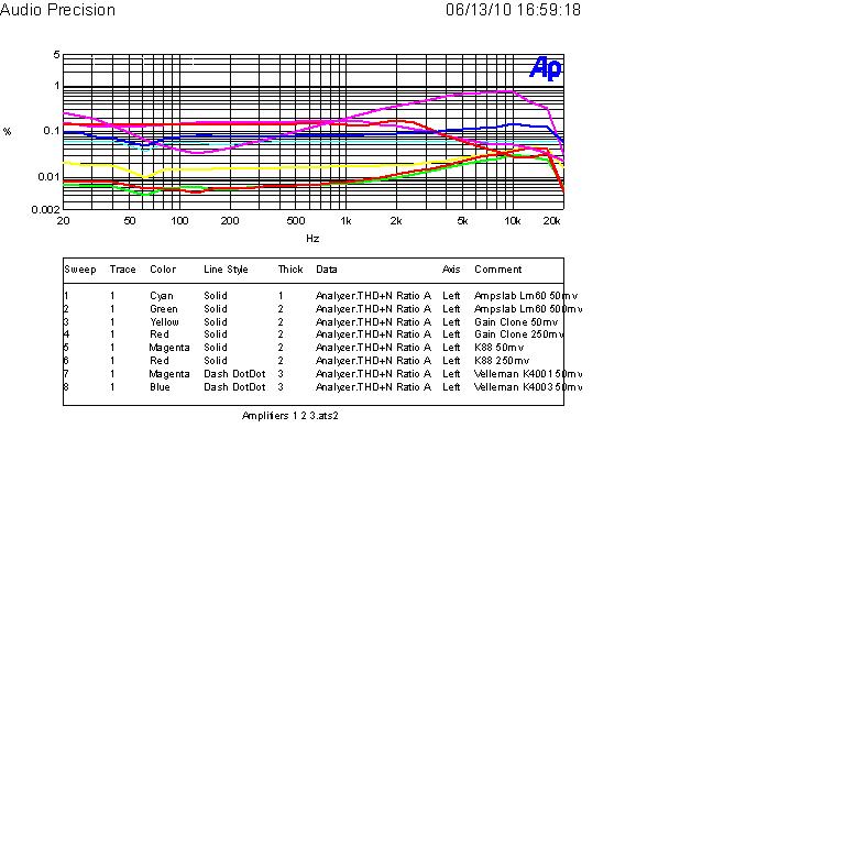

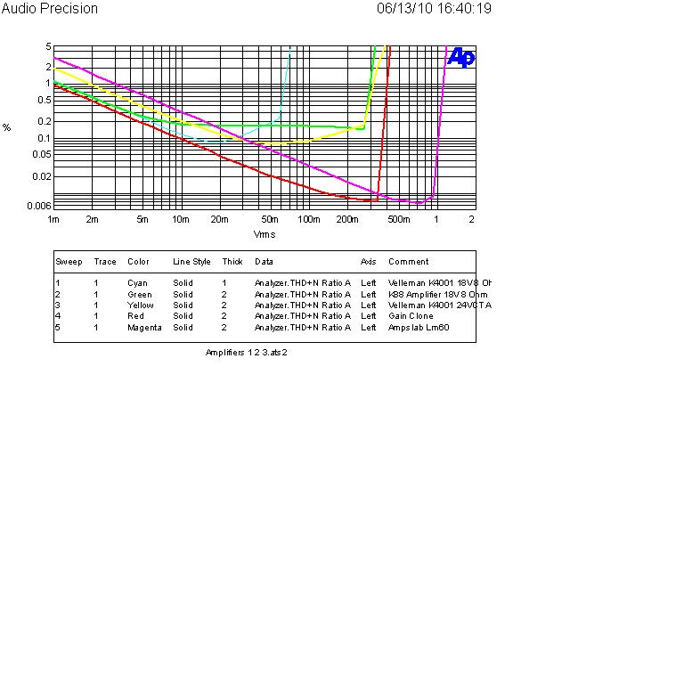

A while back I started on a project to test to see if resistor differences are as important as some claimed.
I had left over from an article an Ampslab LM-60 amplifier. When I measured it for the article I got these results. Note that it was the best performing amplifier of the group.
I then modified it by replacing all of the inexpensive metal film (MF) resistors with ones I had thought were better. I reduced the value of the output resistor in the final RC filter. There were two electrolytic capacitors bypassed by a small film resistor in the ground side of the feedback path to lower DC gain to unity. These were replaced by a pair of moderate quality film capacitors of much smaller value.
The output bias was increased to improve high frequency distortion near clipping. The power supply was slightly modified by adding two diode drops to the positive rail supply. 30uf Film capacitors were added from each rail to ground.
The feedback resistor was removed. A Lorlin shorting rotary switch allowed selection of either a high quality MF resistor or the second worse Carbon Composition unit. (The worst I measured is now out of production)
I was quite surprised by how much better the amplifier measured with these changes.

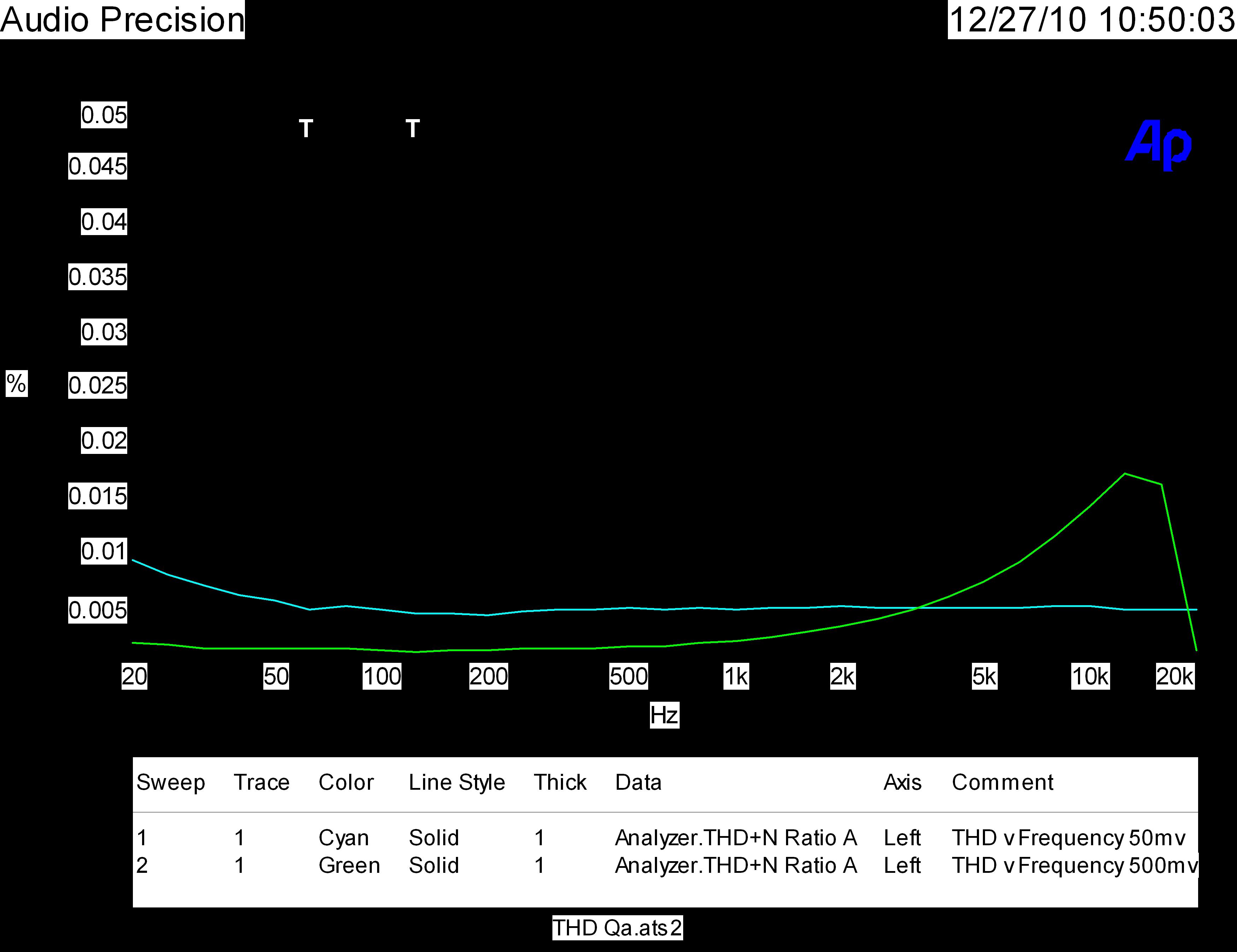

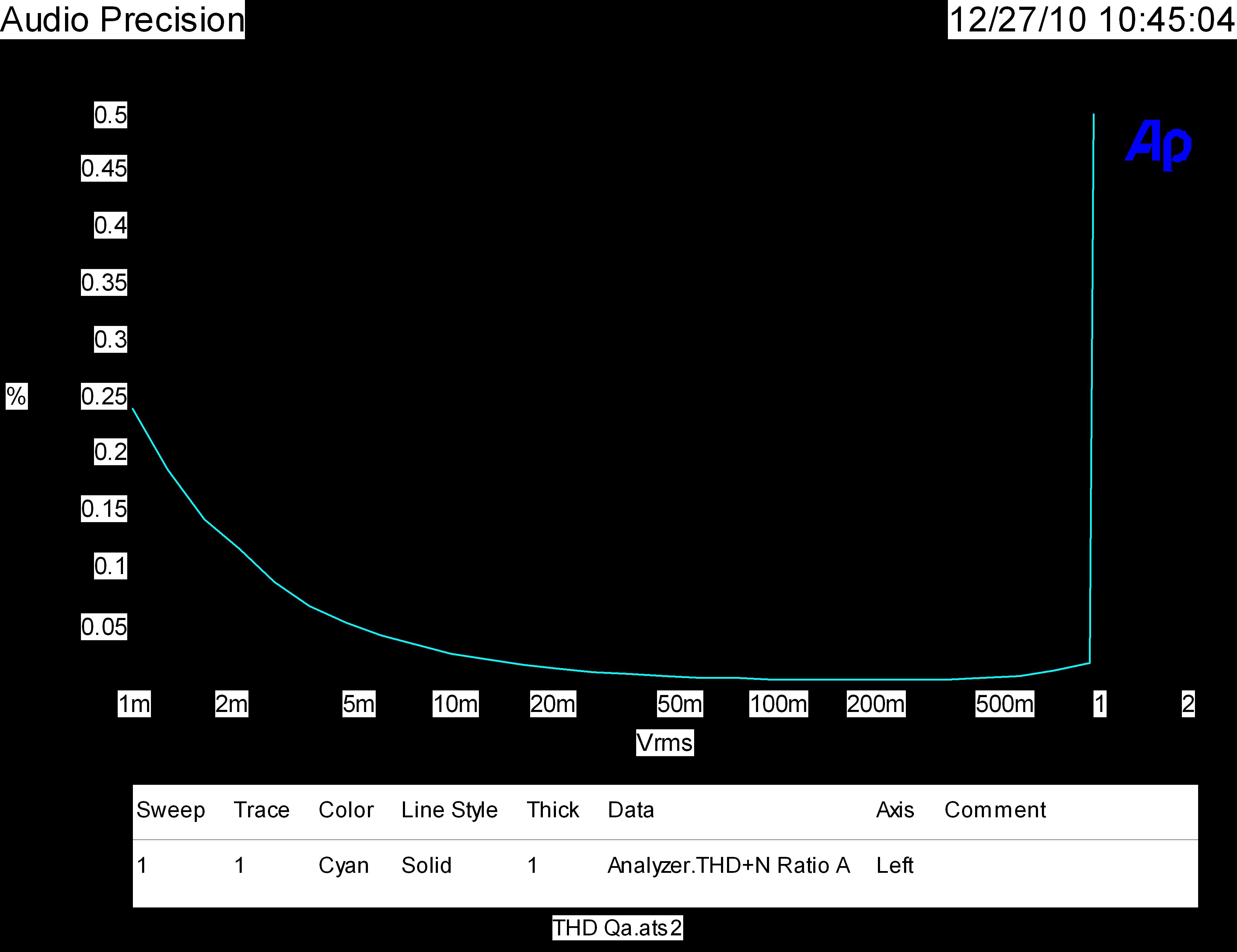

Here are the after modification curves, note the scale has changed!
If I didn't see the clipping distortion I would have thought I forgot to hook up the amplifier!
I did not expect such a dramatic change or else I would have taken measurements after each change, instead of just doing it all at once.
Scott,
IMO, if this is a class AB push pull amplifier, output bias should be adjusted to minimize crossover notch distortion. This may be reflected in what seems like high THD at low output, increasing as output is lowered. THD should get lower or stay about the same as output is reduced. This was a very common characteristic of early solid state amplifiers. Their harsh sound was attributed to this flaw in their design.
Note I use asymetric voltage rails. Just looking at low level THD or IM has other issues. In the old days I used to use headphones and just a very low level for the best sound. Then set the trim in the middle of my did not hear a difference zone.
So we generally agree on this point.
