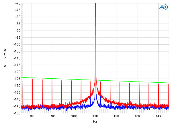

Here is a typical cheap mass market unit.
I hope this is not against the rules, but here is the jitter spectrum for a $300 DAC with 16/44.1 data. Image from stereophile Musical Fidelity V90-DAC D/A processor Measurements | Stereophile.com
The green line is the expected spectrum if things are working as they should. Benchmark gives the same results. What is noticable with this unit is an oddity in the right channel with some odd noise modulation going on. Certainly an area where the benchmark improved things but literally down in the noise for most of us. So question is how much cheaper do you have to get before you can see these synthetic artifacts?
EDIT: http://www.stereophile.com/content/lector-strumenti-audio-digitube-s-192-da-converter-measurements you can spend $3500 and get something truly awful though.
EDIT: Lector Strumenti Audio Digitube S-192 D/A converter Measurements | Stereophile.com you can spend $3500 and get something truly awful though.
IME you have to work at making things this bad, typically some very bad engineering is viewed as overlooked "genious".
