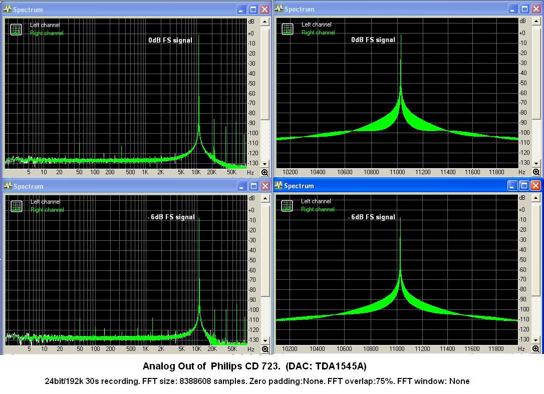

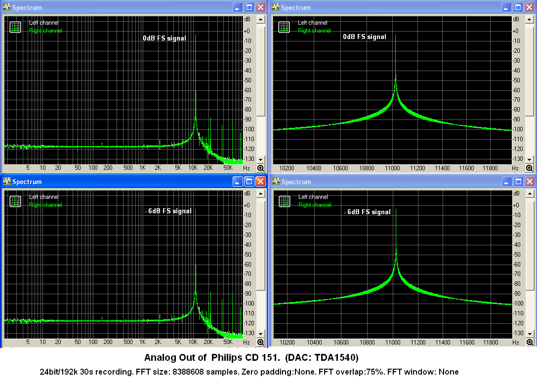

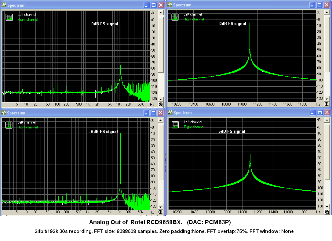

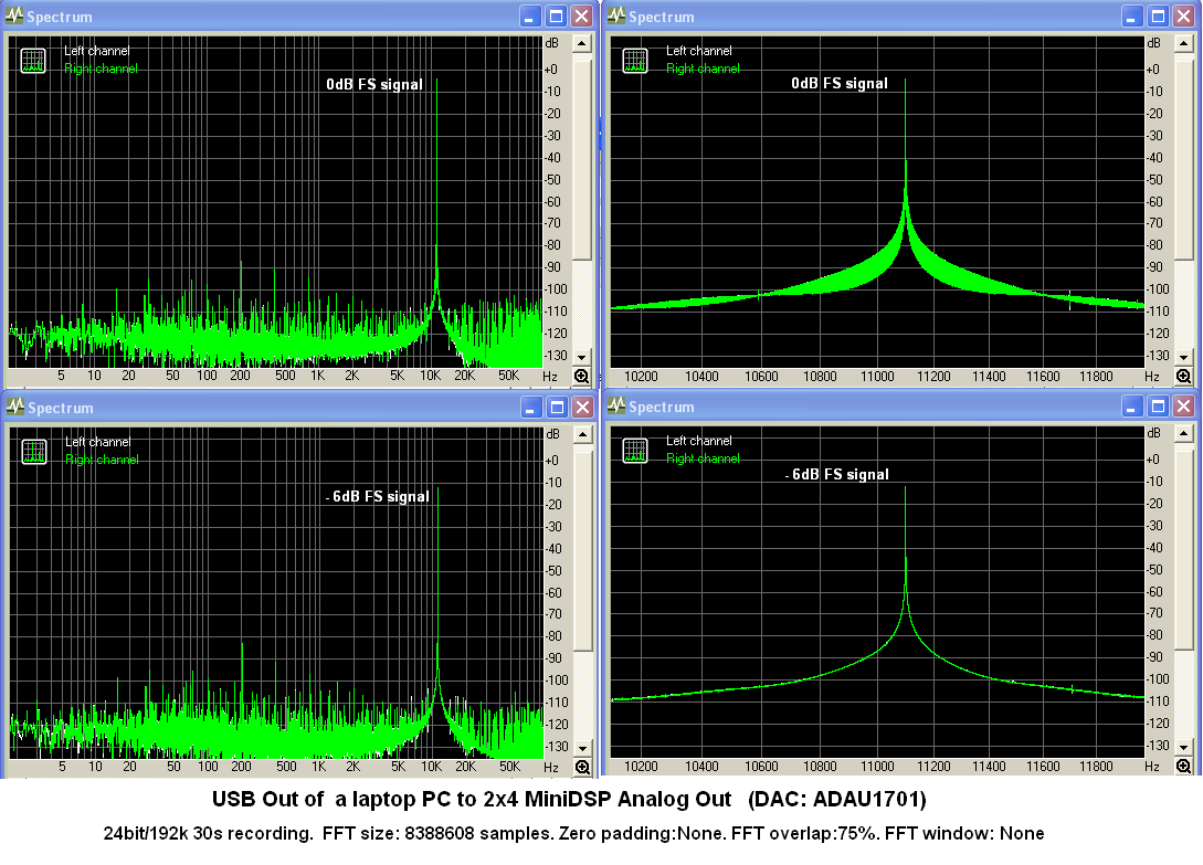

So I had software to generate the 11025Hz sinusoid signal at various levels and recorded some 44100Hz 32bit float files. (at 0dB FS, -0.1dB, -0.2dB, -0.3dB, -0.4dB, -0.5dB, -1dB, -1.5dB, -2dB, -2.5dB, -3dB, -3.5dB, -4dB, -4.5dB, -5dB, -5.5dB, -6dB).
I dithered and saved them as 44100/16bit 30s duration each.
I burned a CD and played it on three CD players. I recorded the signal coming from the Analog Out .
I also fed the digital input of the 2x4MiniDSP (ADAU ) through a PC USB out and through the SPDIF out of a CD player. I played the files and recorded the analog out of the MiniDSP.
Recordings were done in 16/44.1k, 24/96k, 24/192k through a M-Audio Audiophile USB external sound card (a 3db attenuator was used to record the analog out of the CD players and DVD player for not to overload the input of the card)
In all cases, the 0dB FS signal was handled very well.
All DACs performed to their 0dB FS specification.
I attach the FFTs from the 24/192k files at 0dB and –6dB.

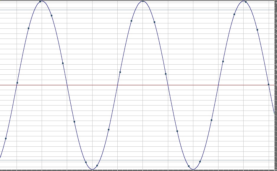

I think there is a mis-statement there. The point is when you do a sinc interpolation of sampled data there can be interpolated values larger than each adjacent value. Think for a second sampling a 20K sine at 44.1K you do not (can not) catch all the peaks + or -. There is no violation of Nyquist, the perfectly interpolated signal is the 20K sine wave generated from the original samples. Picture is 5K sampled at 44.1K at bottom the peak is greater than adjacent samples.
I ran across this effect in generating psuedo-random noise and then interpolating it to a higher sampling frequency, there is a SLIGHT shift in the expected crest factor distribution.
