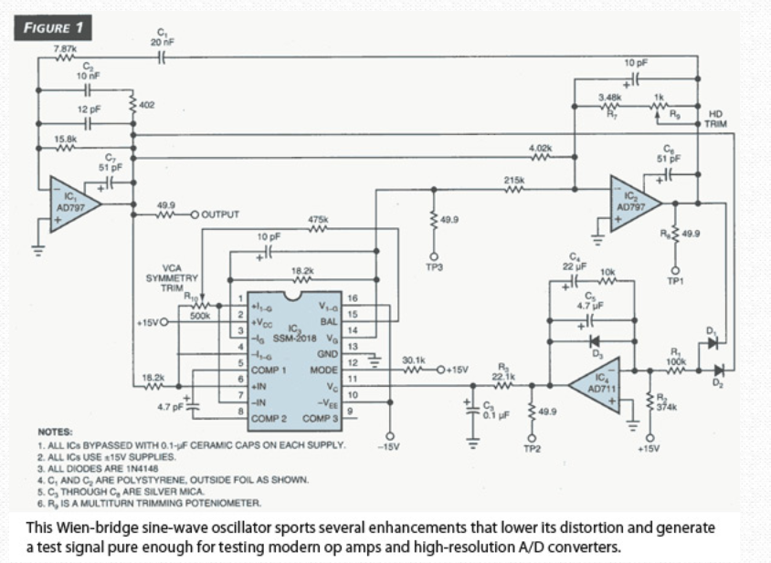

I tried the 797 in the oscillator for the old HP339A. It did not perform as well as some others. It depends on the circuit Z values in that application.
THx-RNMarsh
I am asking what it is about the 797 which would make its thd higher than others with the Z used for osc of the 339A. Seems like a simple enough question for the principal designer. Something in its input topology? Feedback elements values?
THx-RNMarsh
Looking at the actual oscillator schematic of the HP339, I cam see where the AD797 is not the best fit. You apparently have to avoid some circuit configurations, because the AD797, as good as it is generally, has input impedance issues. Scott, this is called upgrading, not re-design. We can't tear apart the HP339 completely to make your IC work optimally. Other IC's apparently work better in this circuit. Was that the LT part, Richard that you found worked best?
Richard, I see what your problem is. To get it right, get the original PDF from Samuel Groner on the internet where he measures a number of IC's for distortion. Hunt around and you will find it. It is over 200pages, I think.
The problem is nonlinear input impedance with frequency, or some-such.
