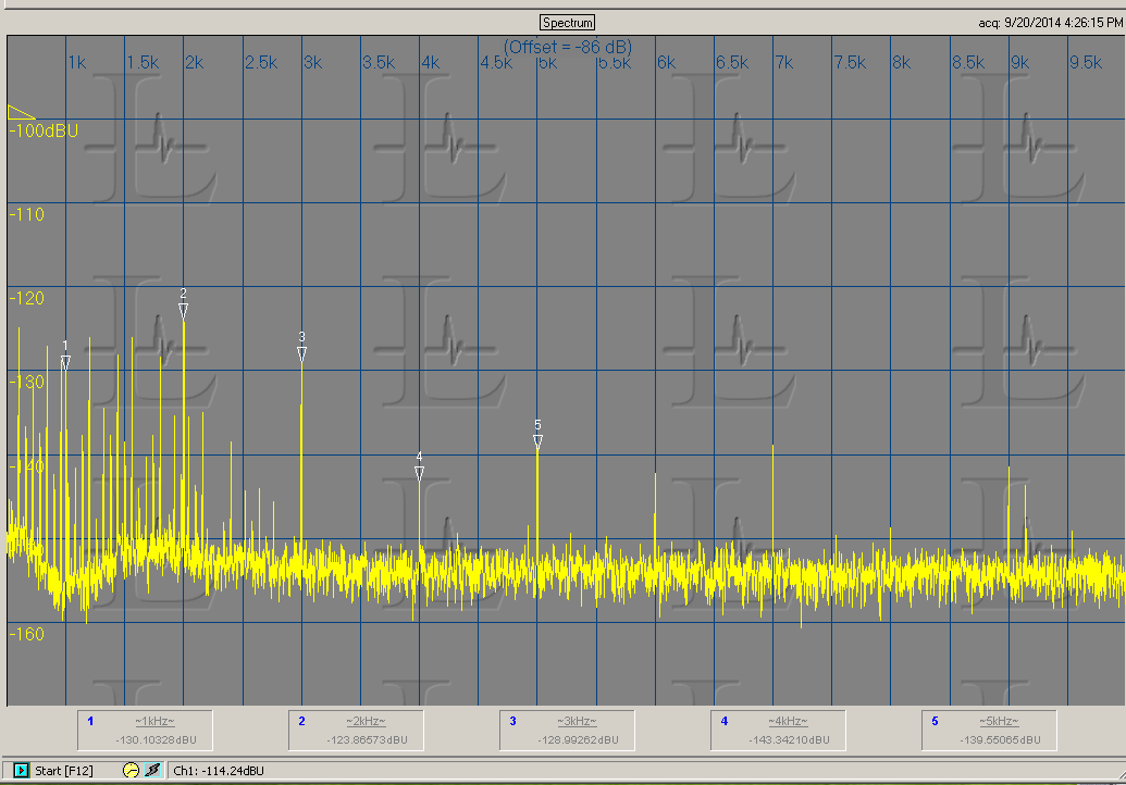

I know I shouldn't do this without the backup pictures but with standard parts (AK4115) and spdif I get essentially no jitter. I really think the jitter bug has been vanquished. Its not the bad guy in a halfway decent DAC effort. I did a lot of measurements which yielded no bad guys in recent chip sets. Below is a measurement from some time ago and chips that are two generations old. Newer stuff is better. Its scaled about the same as the Stereophile pictures.
Also I don't see much difference in distortion etc. between 1X and 4X. The AK4490 is a little better at 44.1K multiples than at 48K multiples but that was an intentional internal timing tweak (or so I'm told). Second picture is distortion at 384 KHz. As you can see the 2nd harmonic is at -120 dB. Its hard to see how that could ever be audible.

I am not sure what you are saying here...... certainly some dac chips via spdif are pretty good in this regard.
Is that what the majority of average consumers always gets in the many product categories containing DAC's from Pioneer, Sony, Panasonic, Marantz etc --- or from one of these:
