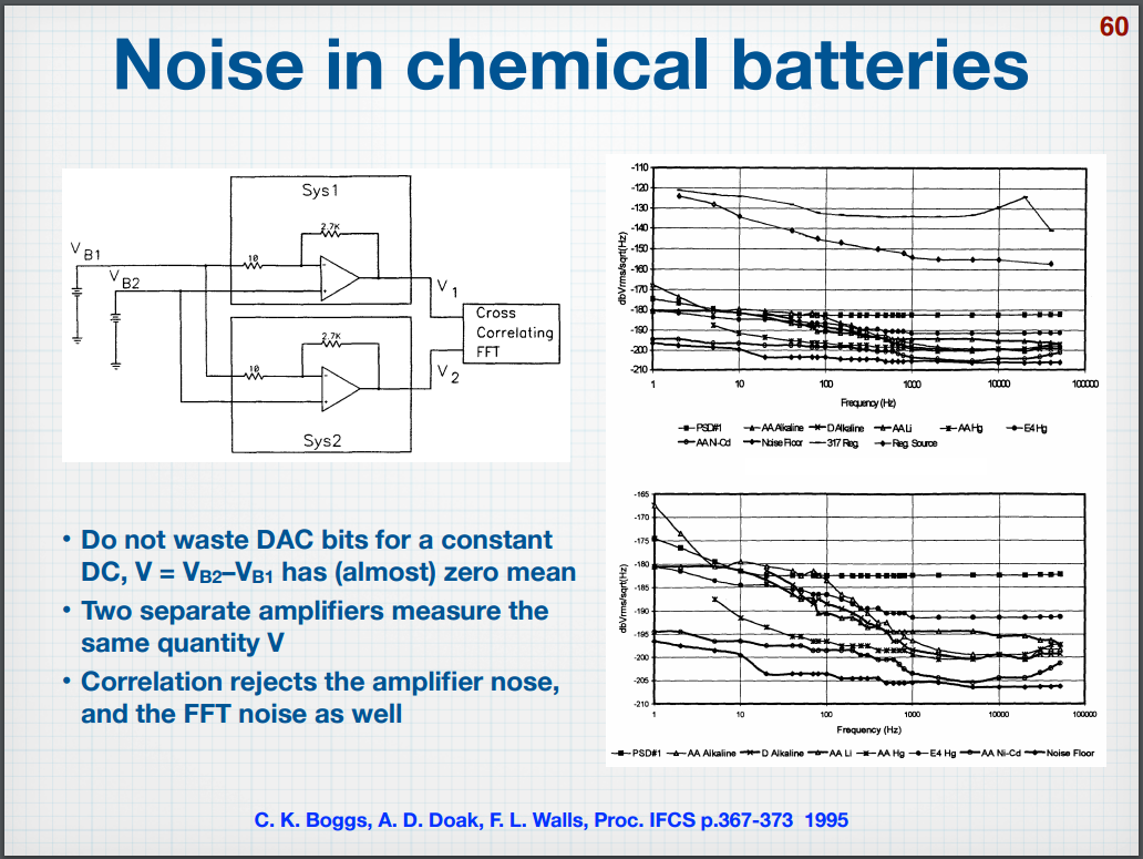

The AA batteries were measured in a cheap chinese holder of the kind
you described.
< http://www.hoffmann-hochfrequenz.de/downloads/NoiseMeasurementsOnChemicalBatteries.pdf >
But you have have seen that, I have mentioned it in this thread already.
Walls measures even better than me, but he was paid for it. (but not
much longer, I have a XFFT analyzer, too 🙂
And the 1/f frequency does not sink with more amplifiers in parallel; it's the noise
level in toto that sinks, and the visibly lower 1/f frequency is only an artefact
because your world exists only above the sea level of the noise. You cannot see
that it falls even more.
See for example Enrico Rubiolas a, b coefficients in the 1/f noise of oscillators.
The 1/f corner makes only sense if you see _only_ the effect that produces it.
Your opamp has a PSSR of 60 or 70 dB IIRC. A LM317 is only 45 dB above 1nV/
sqrt Hz, so even that should be absorbed. I have found ST's data sheets quite
reliable, and 70 dB PSSR is not exactly outstanding, so I would accept it.
regards, Gerhard

Thanks Gerhard for linking to Enrico Rubiola's work
attachment is from this presentation
http://www.rubiola.org/pdf-slides/2014T-IFCS--Cross-spectrum.pdf
George
George
