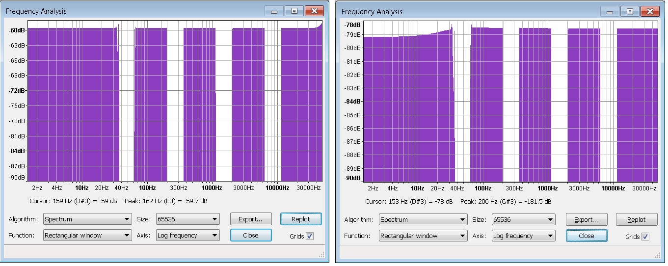

I showed how to dramatically (in some cases) shrink FIR's in my LA article. A dishwasher does my dishes, quietly if not quietly enough for you.

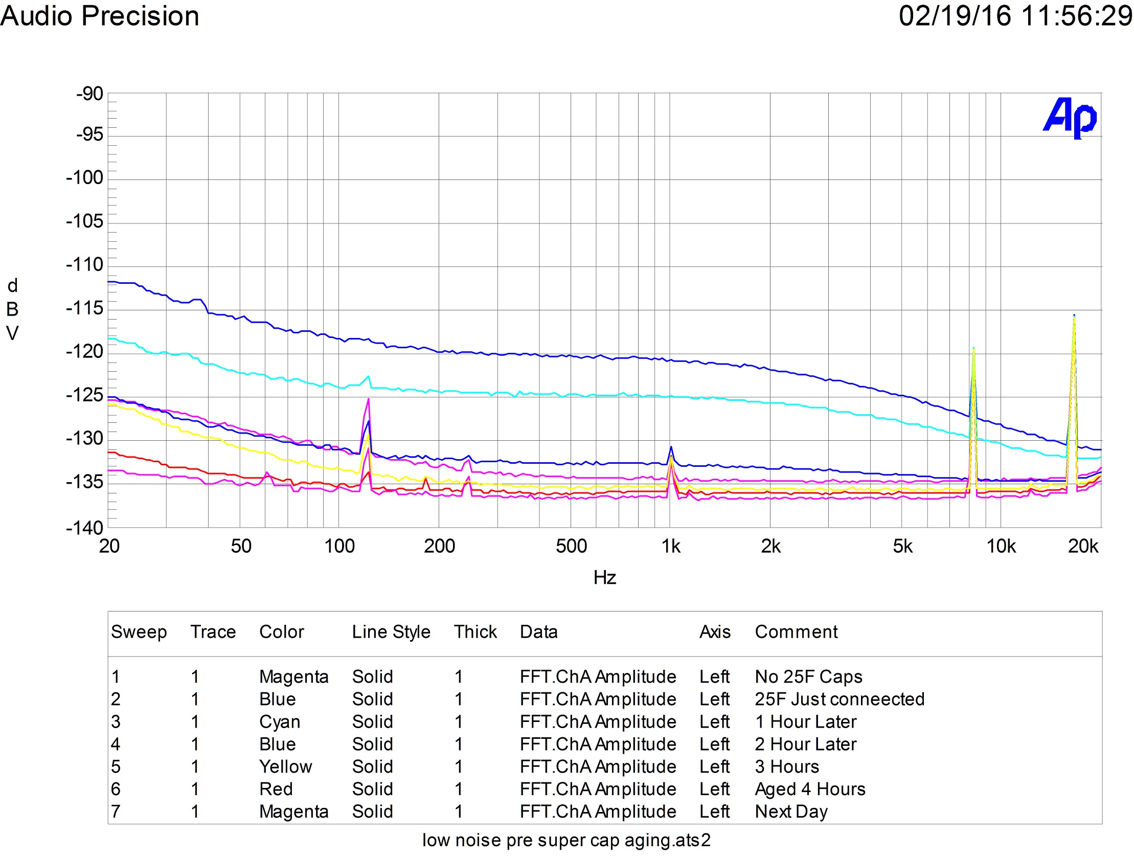

Well I just completed my second low noise amplifier and used it to test a theory about Power Supply Rejection Ratios.
First I just used the data sheet circuit with 10 uF bypass capacitors at each chip and on each rail. The I added 25 Farad super capacitors to each rail.
The before curve matched the data sheet curve with a 1/F corner at 1,000 Hertz.
Adding the super capacitors instantly raised the noise as shown.
Letting it age under power the noise dropped. By the end of the afternoon the noise had dropped below that of the data sheet bypass suggestions. The next day the noise floor was even lower. Input shorted.
My conclusions:
The super capacitors I used do indeed need to reform after storage or simply put, there really is a burn in effect.
PSRR is a two way street. A low impedance low noise power supply will reduce noise in the circuit connected to it.
Unknown is if PSRR is symmetric as to reducing noise in and out.
So using power and ground planes with excess capacitance will actually reduce circuit noise.

It took some looking to find what article was referenced to Scott where there was a discussion of dsp and filters. It appears this article is mainly directed towards RIAA compensation in the digital domain. How much information in this article is aim at FIR filter optimization, is this just a simple generalization of using FIR filters on a minidsp?

What if the circuit has infinite PSRR? If you hook up a 797 like on the data sheet it has .9nV noise down to 10Hz or so nothing will make it lower other than cooling it.
The chip I used is specified as 76 dB PSRR at 1,000 Hertz gain of 5 Delta VCC +/- 100 mV.
I look at the image and it seems like the corner frequency has moved, although it could just be too far below the residual noise.
Now we can talk about the PSRR test circuit. Since adding capacitors to the device under test would ruin the standard test circuit, it does raise the question about how the test really reflects actual in circuit use.
The the real question is have you tried it? The data sheet shows only 4.7 uF in parallel with .1 uF. It does not address ground planes and mega capacitance. The assumption is that the noise should not go down, but if you model the circuitry as a simple resistor of say 50 ohms, the noise should go down if that resistor is paralleled by a resistor of 1 ohm. Is the assumption that PSRR symmetric valid?
One simple trick that works for a lot of FIR filters with low frequency poles or zeros. It amounts to a phase rotation equivalent to a fractional sample delay which works in some cases better than windowing. Picture below shows Audacity's built in FIR RIAA right and mine left. The input in both cases was a spectrum with "holes" inverse RIAA'd essentially a multi-tone using every bin.
The FIR on the left is shorter and minimum phase (which you can't see here) there is low frequency ripple from the windowing visible on the right FIR. The miniDSP does not do FIR's you will probably find the throughput at 50MIPs on that processor will not do much FIRing, the miniSHARK is a better bet.
No, certainly not vs. frequency since the comp cap is usually tied to one of the rails.
Your resistor analogy is lost on me, the circuit is an amplifier with an equivalent input noise of 50 Ohms. Nothing on the supply can make that go away.
Not symmetric to the rails but in vs. out.
And I have two cards where the power supply does change the noise level.
Well figure out what's really going on, certainly before you publish anything. How do you think all the graphs on data sheets are made? How did those NIST guys measure -200dBV on batteries?
I have built a test circuit for the standard PSRR tests. Have played with it a bit. Now the NIST guys made it clear how they made measurements with a bit of effort.
My observation was simple, lowering the power source impedance reduces the noise of the circuit under power.
My suggestion is simple, if using an AD797 circuit, place a whopping big pair of capacitors across the rails and see if the noise goes down. Now I'll try on rail at a time to see if the path is through the compensation capacitor.
Can you confirm that the supercapacitor noise stays away if the circuit is not left on? IE it's a one time thing?
It doesn't, it can't, it's already at the thermal noise limit of the input devices, no different than off of battery supplies. Really Ed your being too silly today.
If I short the output the noise goes away.😀
It should creep back up when not in use and then go back down in use. But figure this was around a year of not in use.
