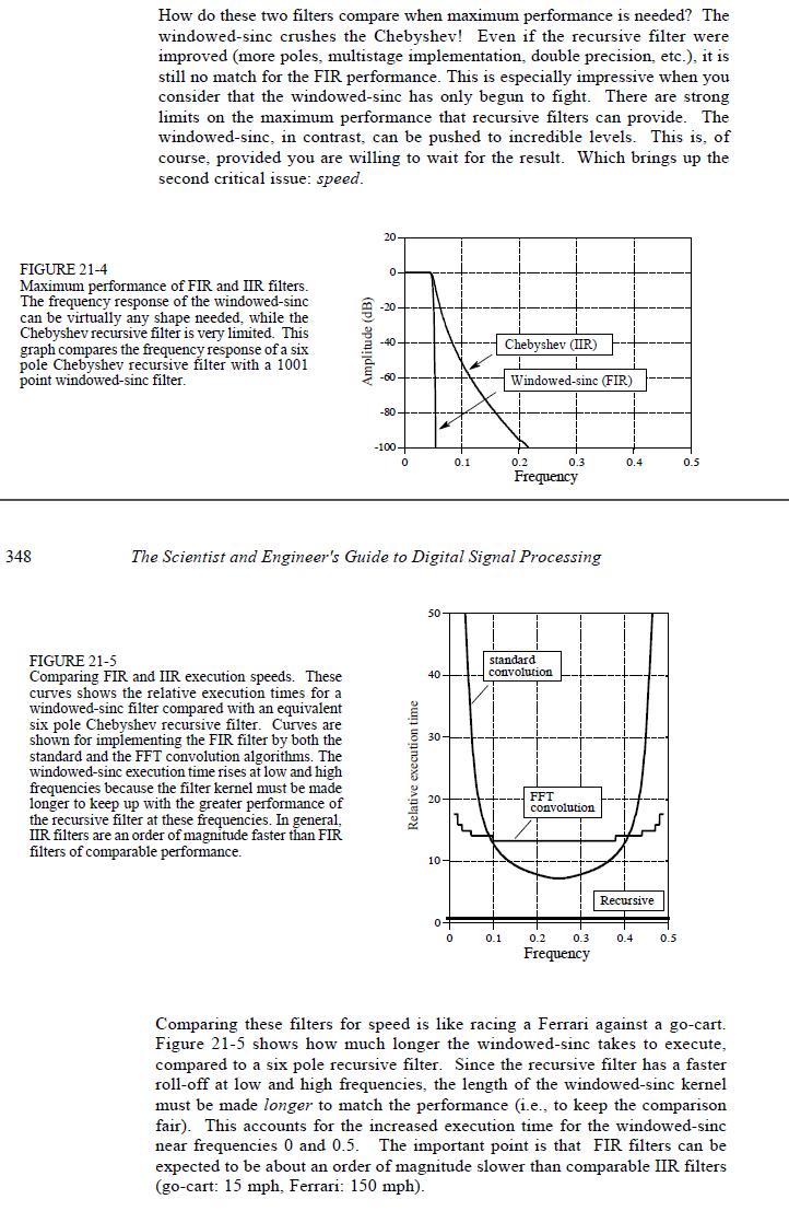

I need the power and FIR filtering so I can do a Linkwitx transform to bring the bottom end up otherwise the enclosure is too small in internal volume for a standard box tuning.
From what I’ve gathered so far using FIR for filtering at low frequencies (say below 300hz) is very inefficient (number of instructions and data memory the filter needs is high). I think you’ll settle for IIR filters there

FIR needs memory, multiplication horsepower - a chip designed for IIR may be able to do a dozen tap FIR - but that's not getting you far
FIR must be as long as the period of any frequency you want to substantially affect, much longer is needed for good control of filter characteristics, XO tricks like linear phase speaker summation requires FIR taps to store all of the samples needed for any time/phase compensation
Thank you jcx for clarifying.
Attachment is taken from:
The Scientist & Engineer's Guide to Digital Signal Processing | Education | Analog Devices
Thank you for the advice again George. You always know where to look. There is just so much information on the AD site sometimes I miss something. A short waveguide would give me a chance to control the directivity but it almost always comes at the cost of a sloped response curve. I'm thinking a combination of active and some a passive network creating a slope in the bass section could emulate the Linkwitz function to extend the bass response. I just wonder how complex the phase could become, might make more problems than if would solve. The IIR filtering is probably going to be sufficient to work down low just to create a slope or step function. I'll read the AD guide. I'll look on Ebay, it's just that I see entire threads from people trying to make some of those boards actually work the way they are supposed to.
