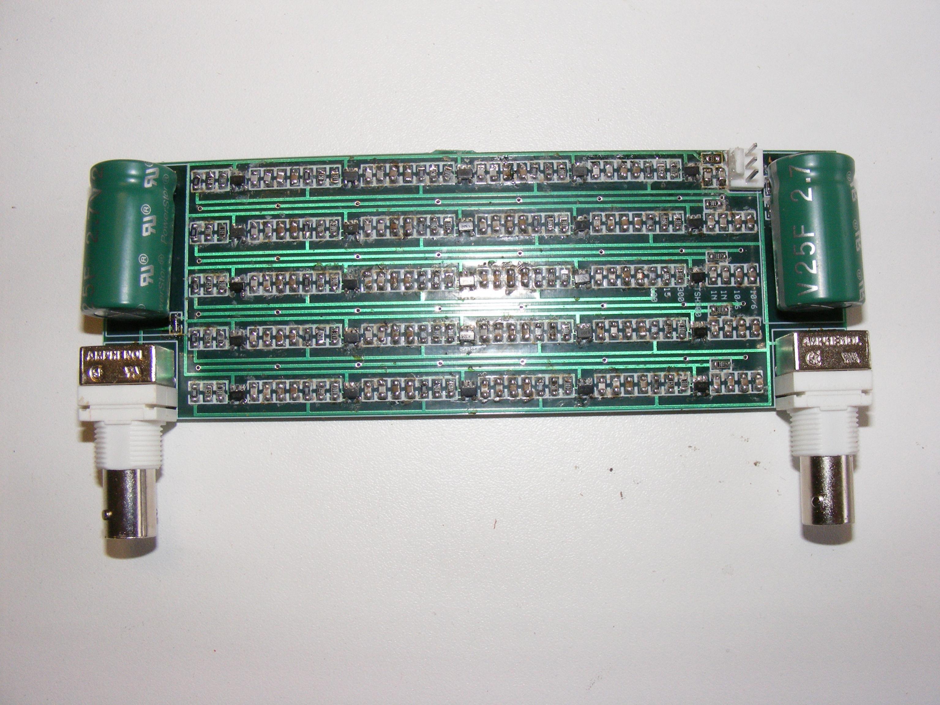

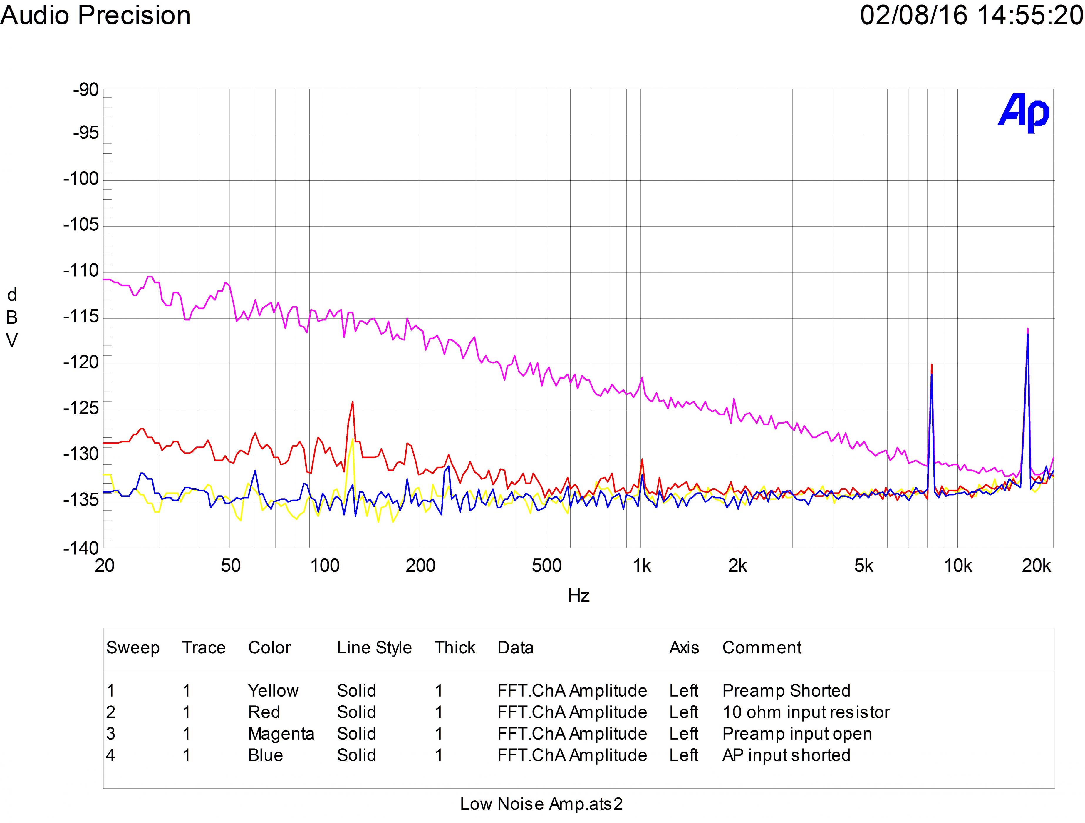

Well I finished my first low noise preamp. Turns out I should add a DC servo to it. Did need the line terminators.
Attached is a picture and the noise measurements on my AP. Zero dB is .001 V input to the preamp. (-120 = 1 nano volt!) For really low noise measurements will need a second stage!
