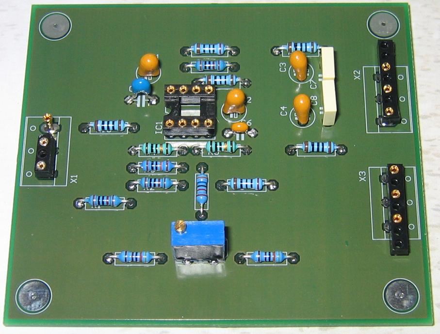

I will have a double-sided PCB with groundplane in a week, to avoid possible test board impedance and coupling issues. We shall see then, if anything is improved.

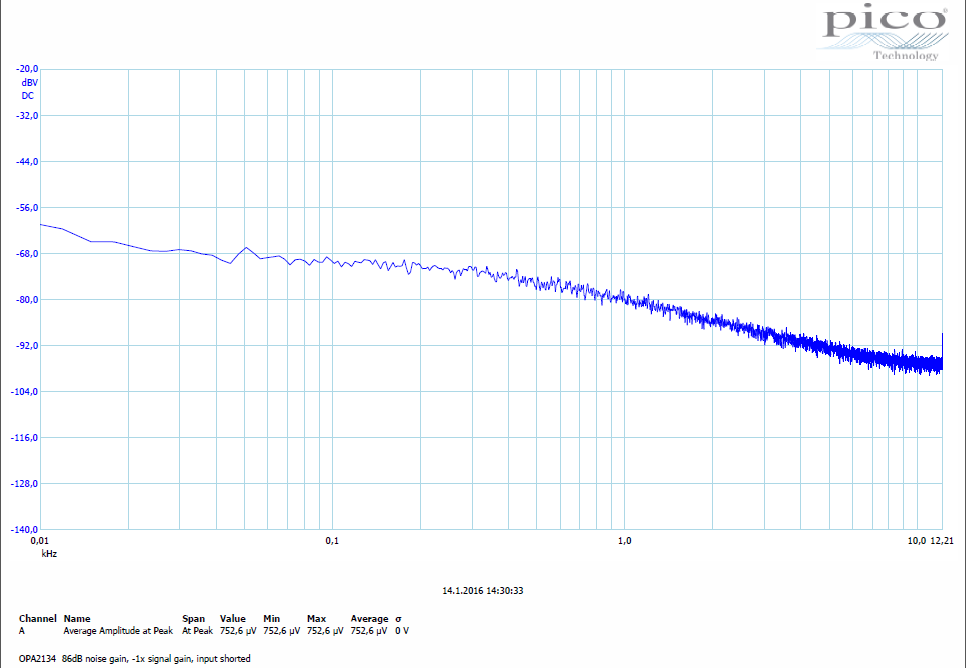

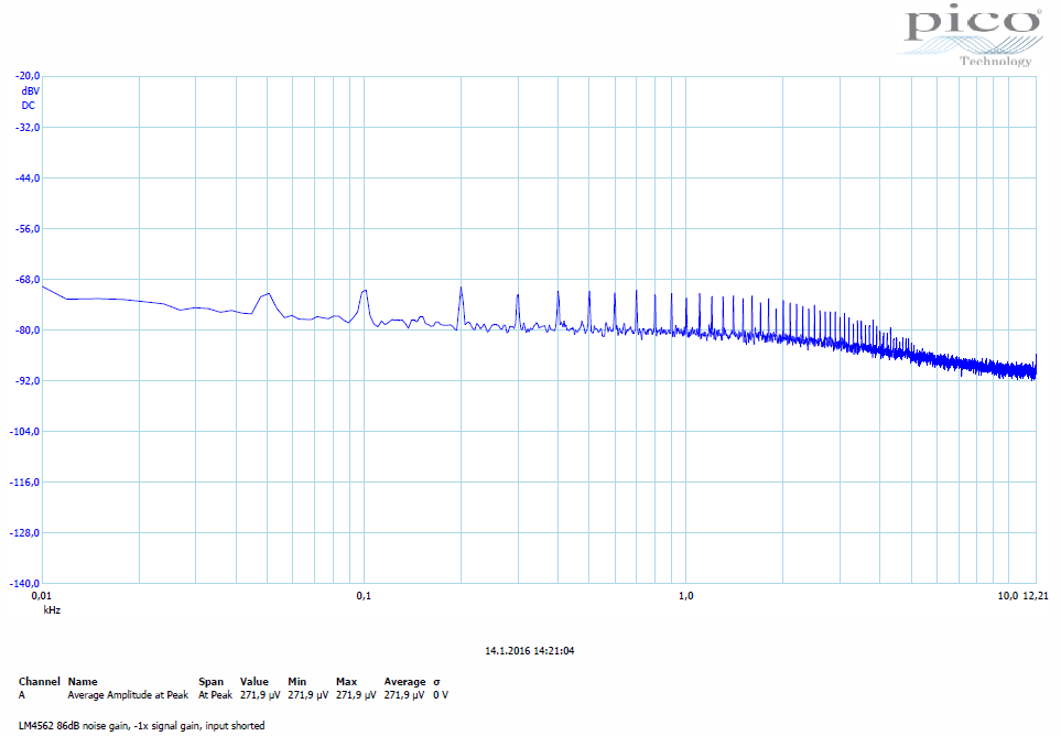

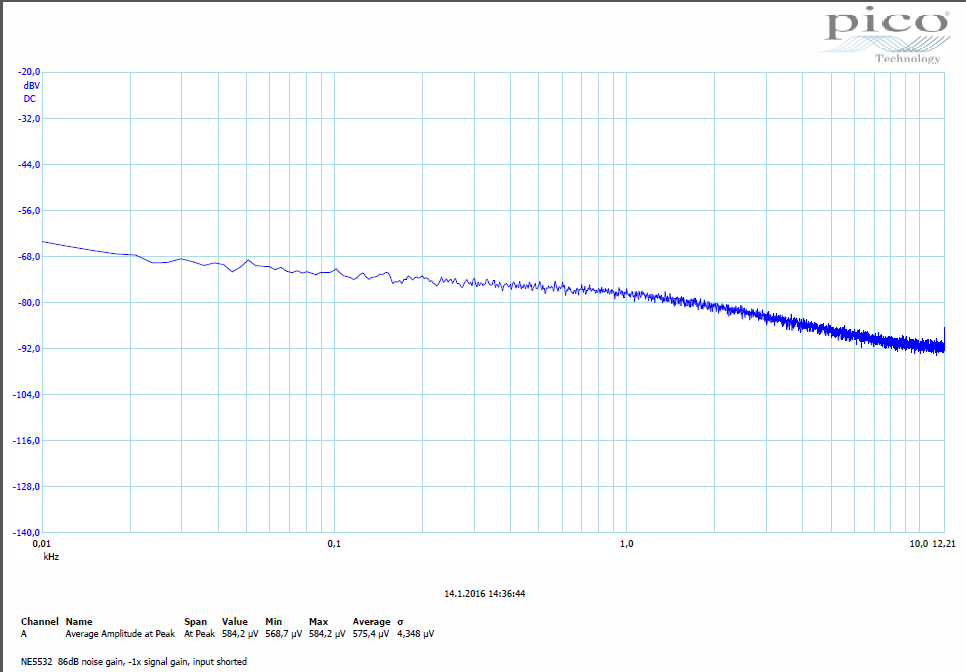

As I promised, I have prepared a double-sided PCB for the test of opamp susceptibility to EMI and repeated the test with LM4562, NE5532, OPA2134 and TL072. The susceptibility of BJT input opamps to EMI has been considerably reduced in this evaluation PCB board, but the relative order of results has remained the same. 4562 worst, JFET opamps best. If I put a finger on an IC package, noise spectrum and time record becomes the same as in the previous test at breadboard PCB. It shows that the effect has been induced and air-coupled.

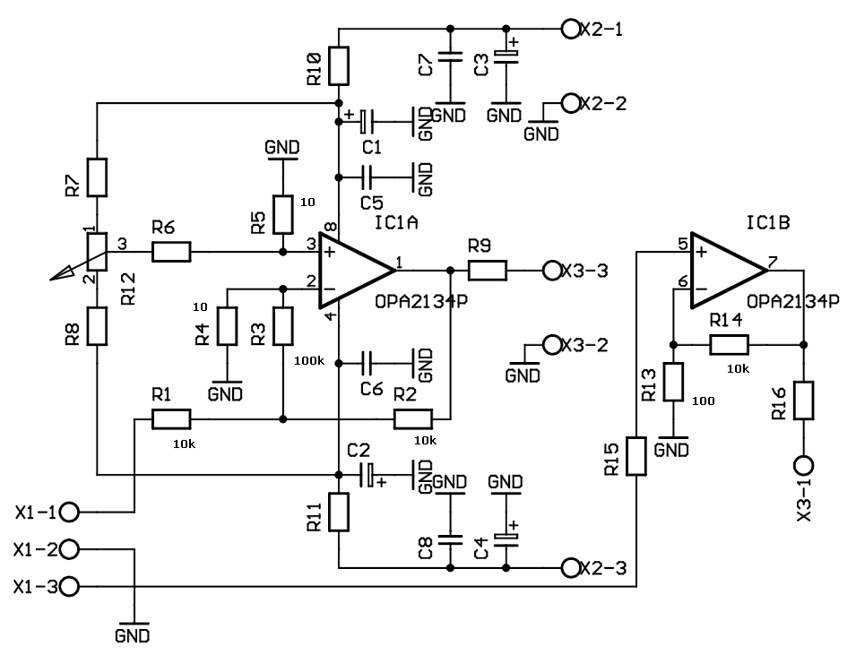

Attached is a schematic and photo of the new test board. Next post will show the measured results.

I think part of the difference lie in the loop gain differences ang GBW products of these devices. The NE5532 LF Gain is spec'd at 100 000 (100 dB OLG), the OPA2134 at 120 dB while the 4562 is spec'd at 140 dB. In you config, any noise between the inverting input and the junction of the feedback resistors will be amplified 100 times more on the 4562 device. Clearly, it is going to be much more sensitive to layout.
We don't know the internals of this device, but clearly there are possibly other factors at play. The very low 'signal bias' currents may also be a factor on the 5532 which only has 20 dB loop gain in the test set-up.
Nevertheless, very interesting results and food for thought Pavel - thank you for sharing.
