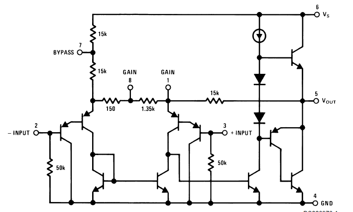

I wonder if anybody not seeing that over simplified schematic in the datasheet would recognize the LM7171 as having anything to do with a CFA topology. Hint: unlikely.

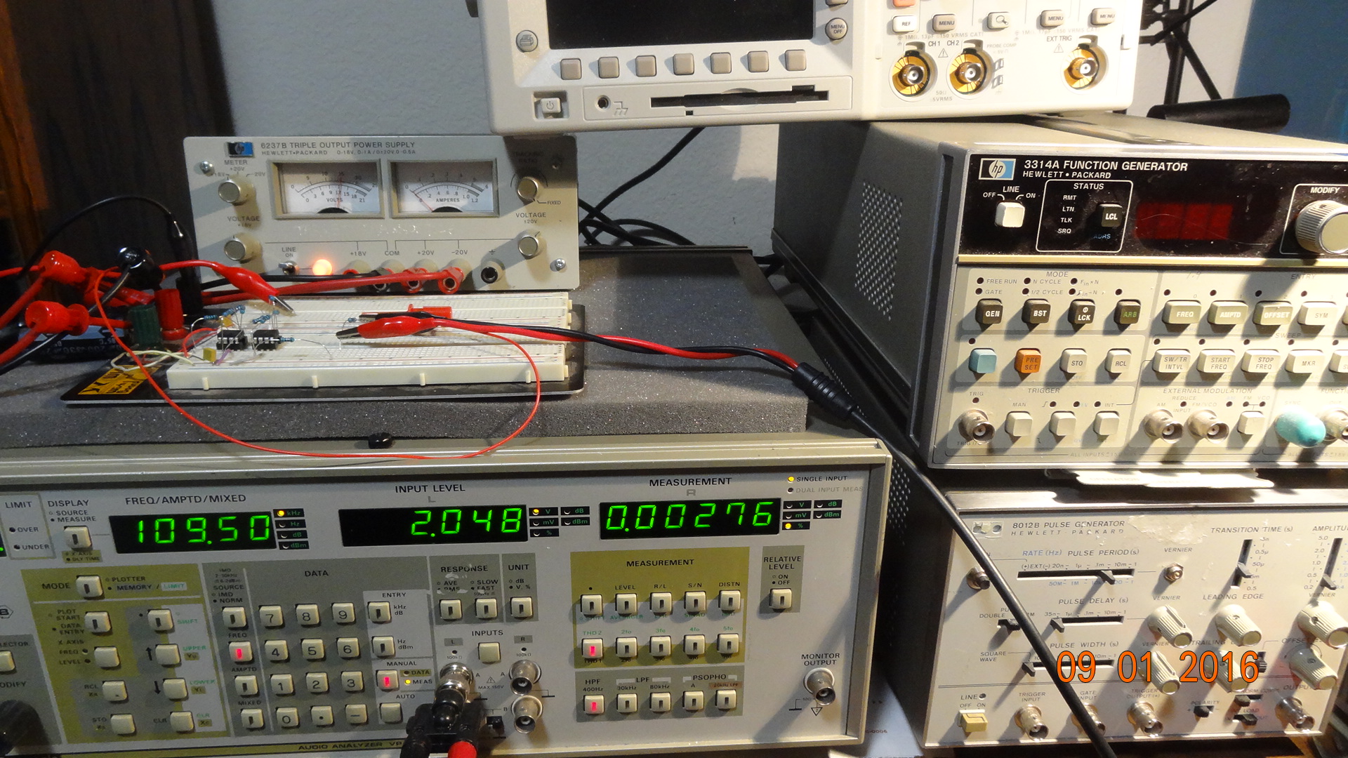

When I used the -7171 it wasnt for a PA... but for a Bal/unbal converter.
The distortion at HF is very low.... .01% at 50KHz in my bread-board.
THx-RNMarsh
Actually -7171 is quite a bit better than .01% at 50KHz. Using a better source, at 110KHz it is about .003% THD.

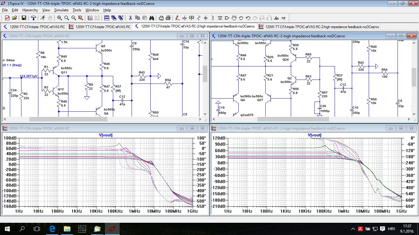

This plot shows two different FB implementation for the same amp.
Whit the low impedance FB input it suppose to be called CFA but gain-bandwidth product looks constant and that is VFA characteristic. With added buffer before FB low impedance input does not change much, it looks the same for me, but it is called VFA now. Both amps have very high Slew Rate.
To generate the plots Rf was stepped.
Any comments?
Damir

You something lose and something gain. In mine CFA configuration distortion is going down with lower feedback network impedance but it's not good to go to low because the power loss and dissipation on the feedback resistors. I use 22R/560R as lowest value. When I added a buffer to the low impedance feedback input I've got even lower distortion then without, at least in simulation. I think there two reasons for that, very low buffer it self distortion (supper pair emitter follower) and even lower then 22R buffer output impedance. That is just simulation, but I hope as with other my simulations not far from reality. Don't be afraid to think out of the box and you could be surprised.
With that buffer in place you still can use quite low impedance feedback network.
And that opens other possibility I can't explain yet.
I'm a little afraid of the "nervous" tendancy of the Super Pair ( and Diamond as well).
Anyway, worth a try. And may-be a good idea too in A VFA, that suffer usually from the high impedance of the feedback path when we want to balance the two inputs impedance.

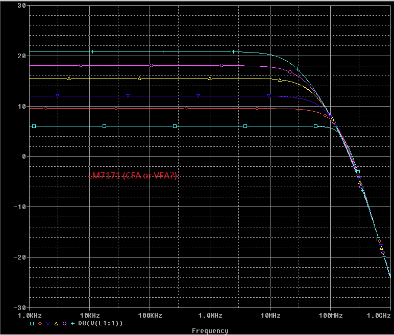

The only small problem is that the LM7171 doesn't walk or quack as a CFA. Of course, you can make it to, by popular vote 😀.
I'm not going there Waly. The description of what a CFA is has been done else where in scholarly publications a long time ago. Done.
